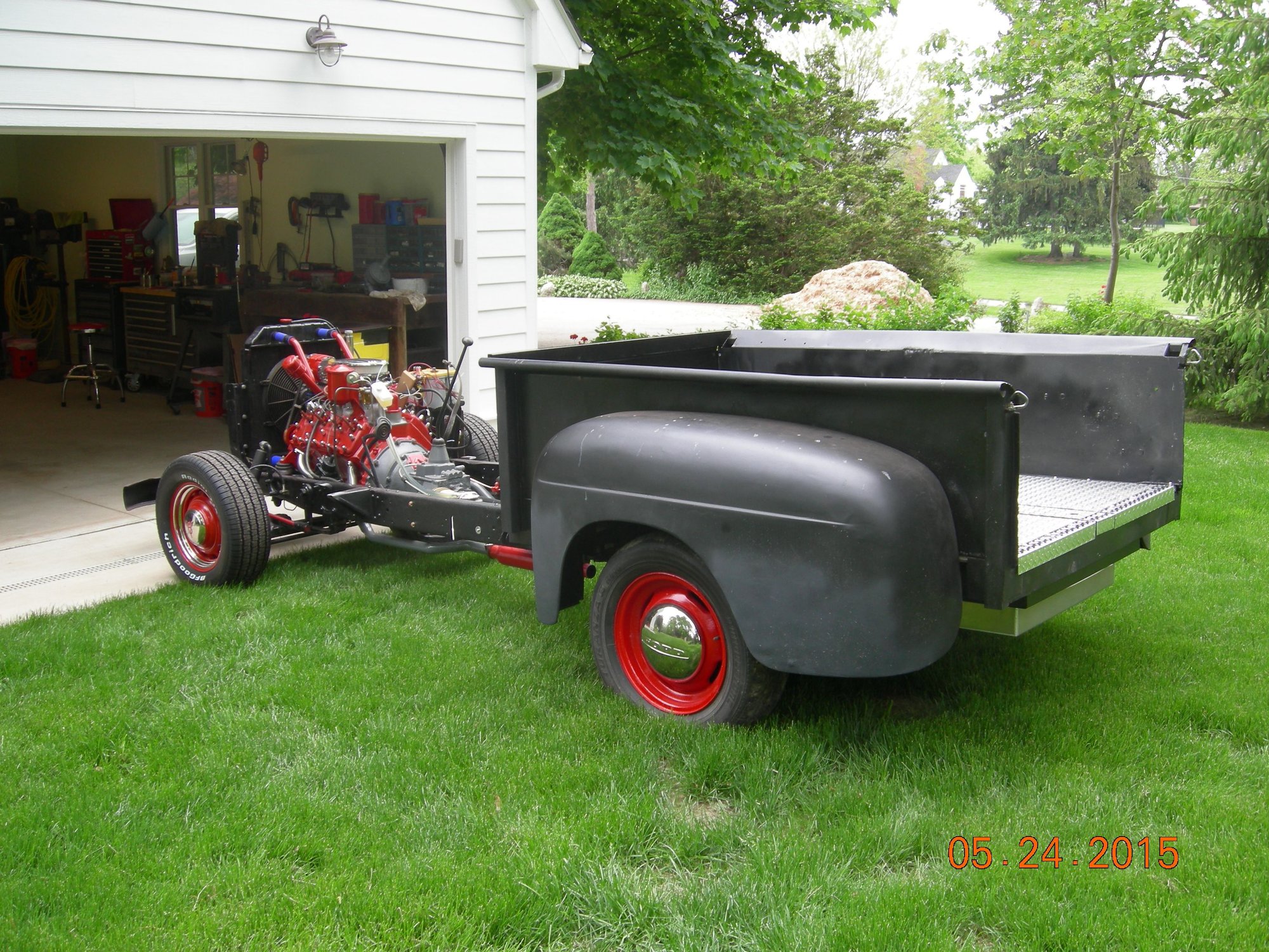

We have had lots of discussion on here about flooring. If you want the stock look there are lots of kits but they are expensive. And the wood will need to be carefully coated but it will still deteriorate after a few years depending upon use and climate. As my F2 was never going to be stock I elected to use Trex and cover it with aluminum diamond plate for about half the price. Easy to work, long lasting and low maintenance.
Here is one of many good threads where we discussed the many alternatives with plenty of pictures. https://www.ford-trucks.com/forums/1...l#post15477789

Sounds like a plan . If you cover it with polished diamond plate you could use the back as a stove. . Even here in Michigan it gets really HOT on a sunny day.
