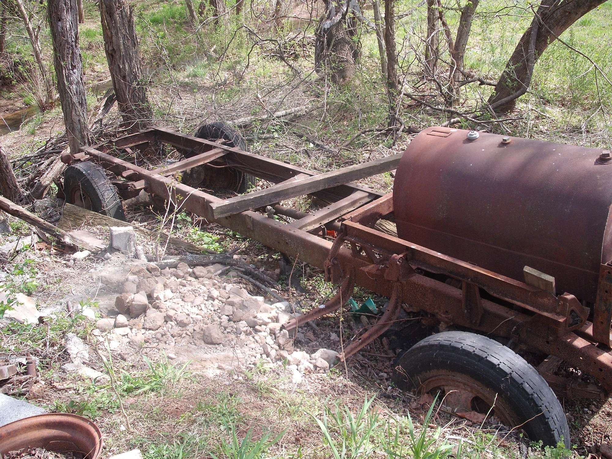

I'm not sure if this will help or not. It's the only pic of anything structural I have on file. I can always take more of anything specific you need. But this you can save to your computer and blow up to see details under the cab.
Or maybe you should just buy this one from me...

Thanks, that's a big help. But the area I most concerned with is the part where the dog bones attach to the crosspiece #5369 in the upper picture. The ends have been torn off and missing on my cab. The dog bones are still attached to the cab but are just dangling in mid air. I'll try to get a pic when I get back to the shop.

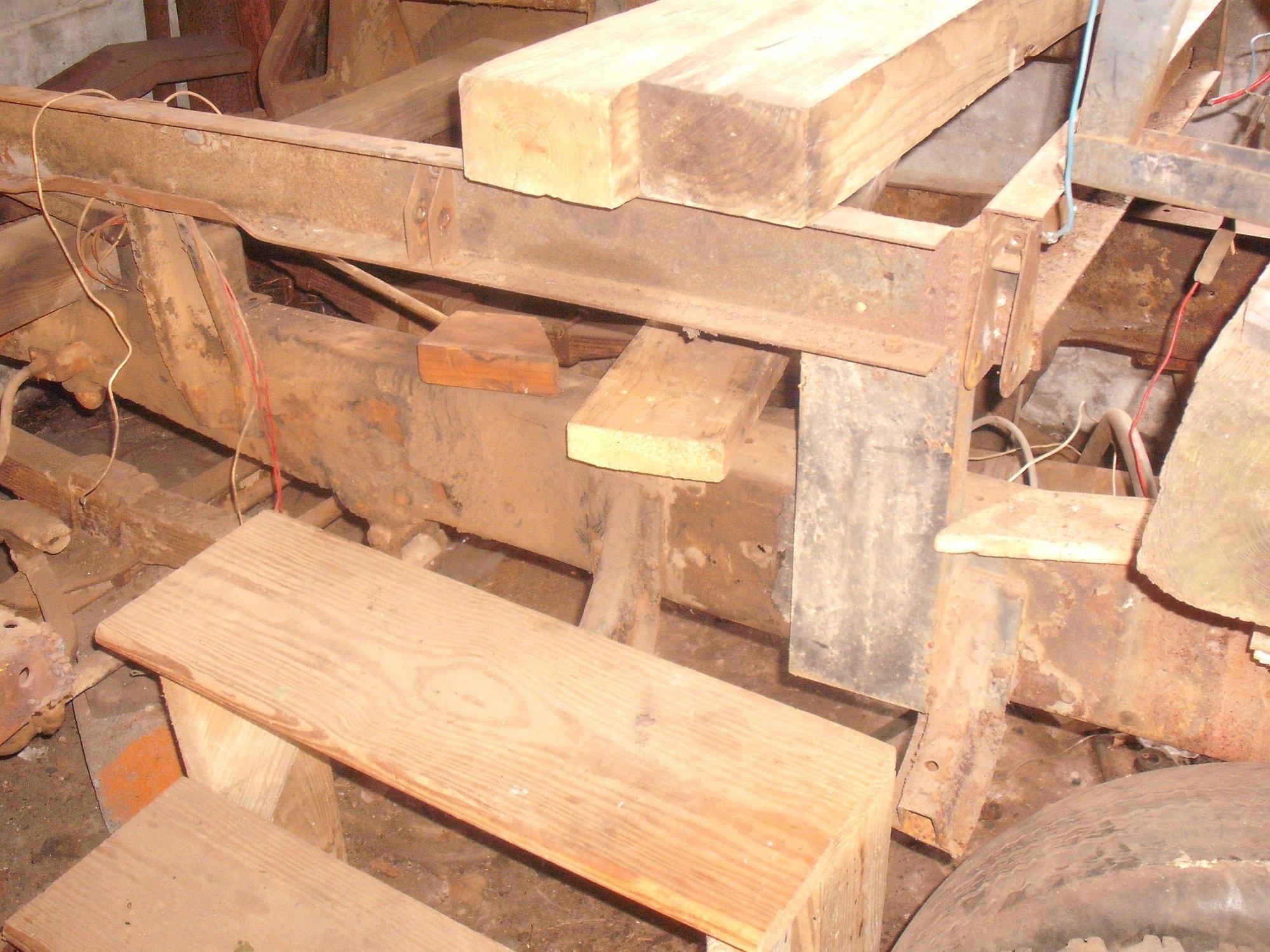

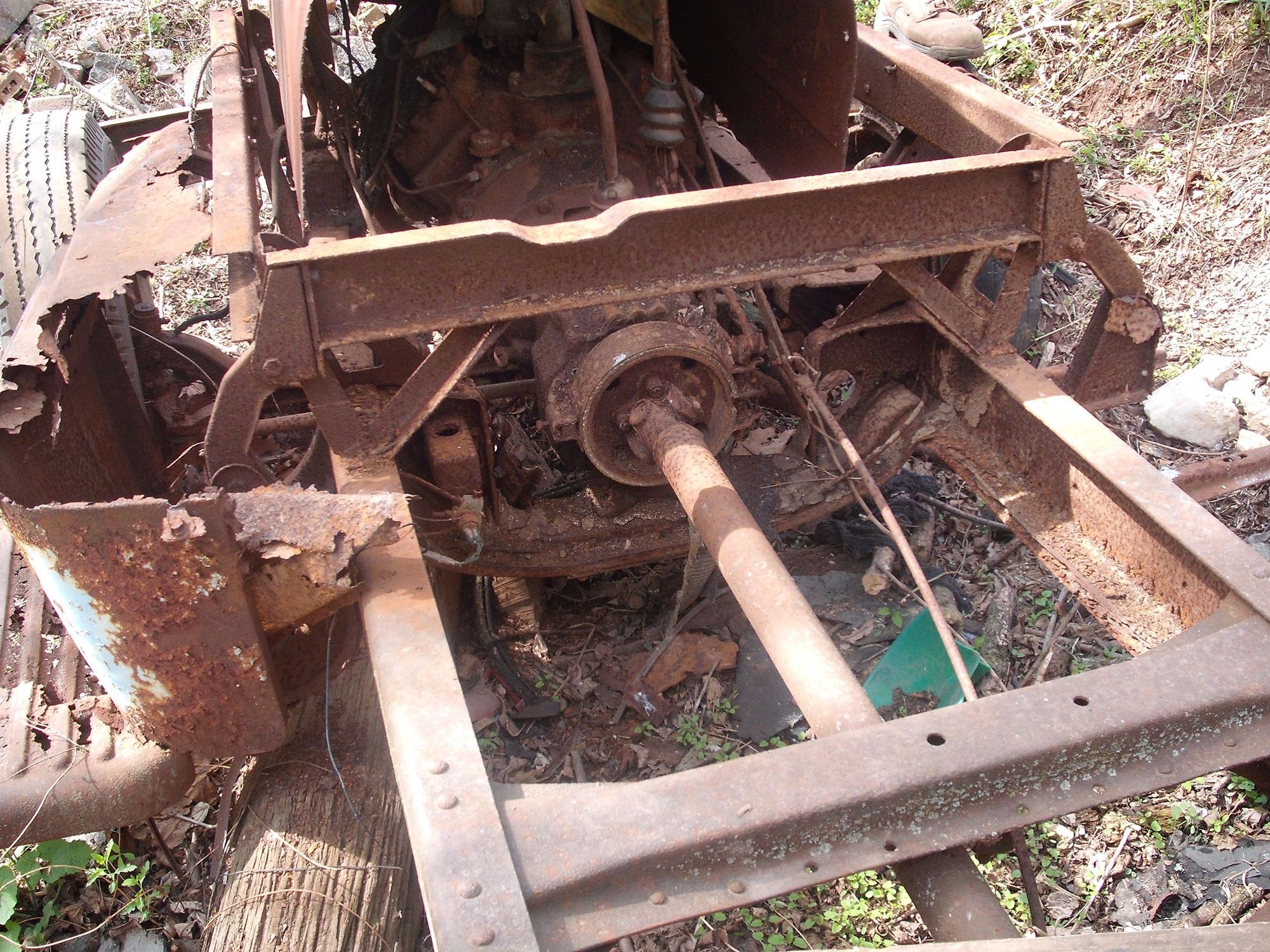

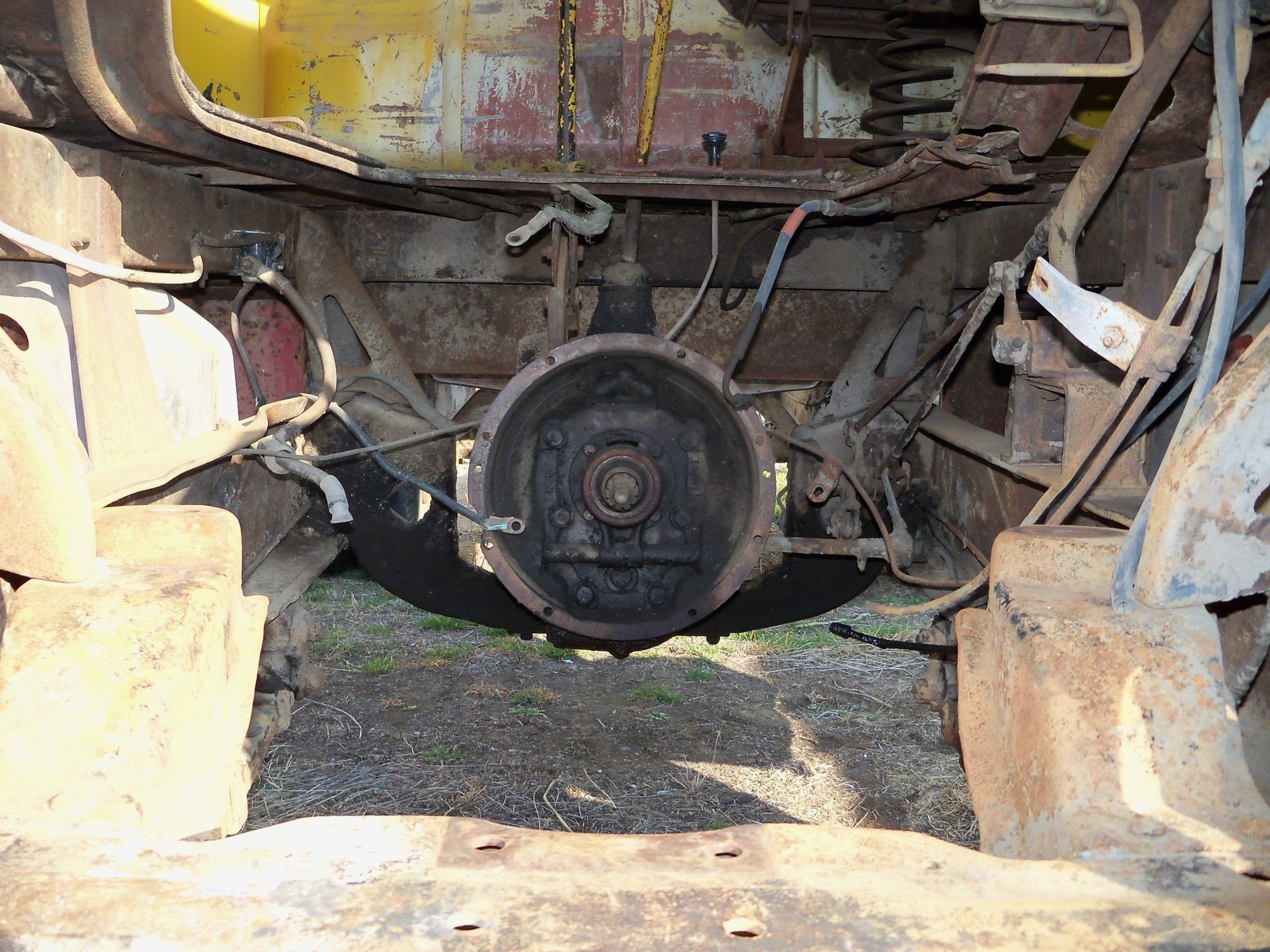

Let me know if this helps.

Yes yes yes. All those pictures are a big help. This will be an interesting challenge without removing the cab. The links are still attached to the cab, it's that rear crosspiece that has the ends broken off. At least now I know it's not an integral part of the cab. Thanks again.
