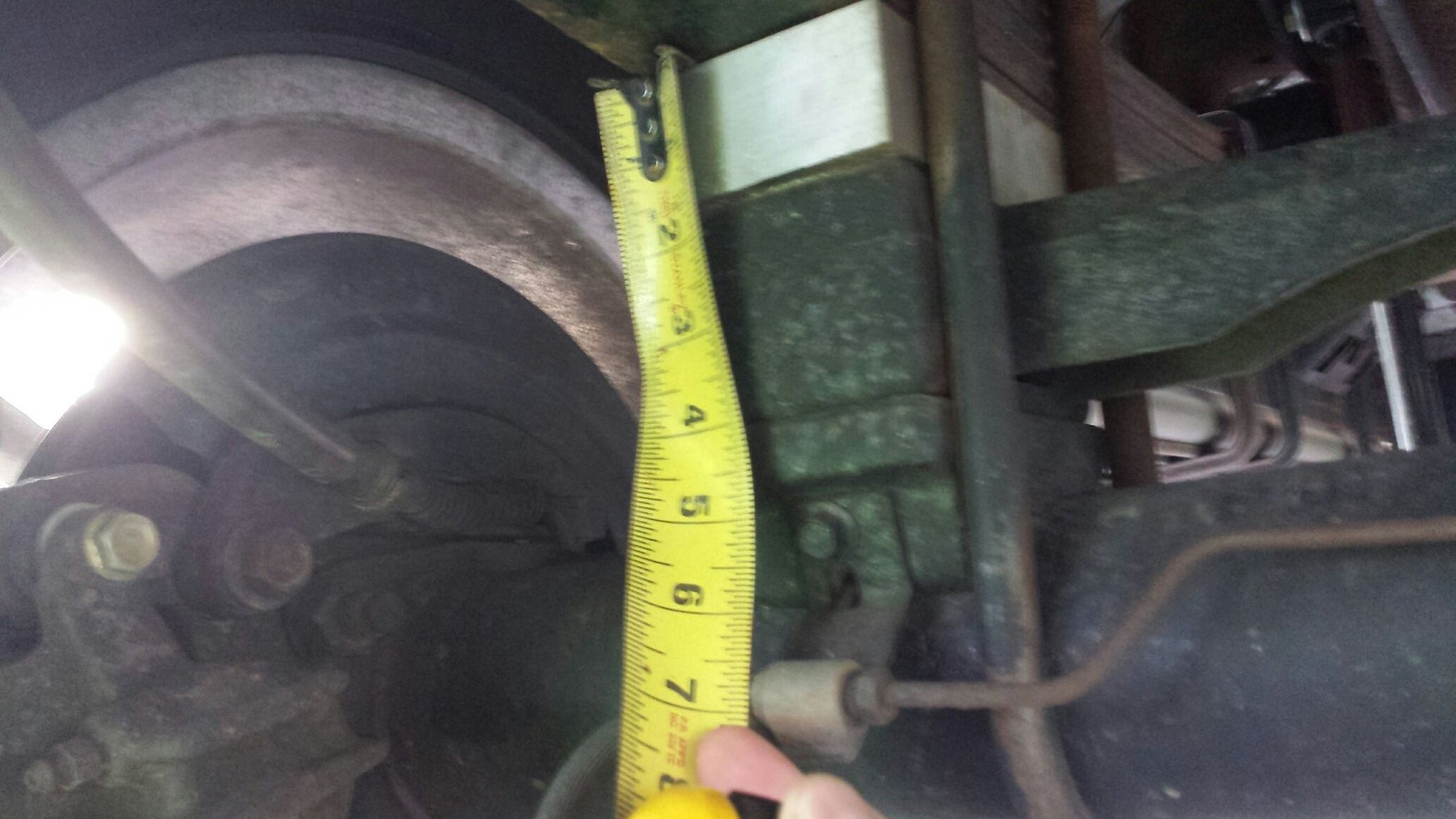

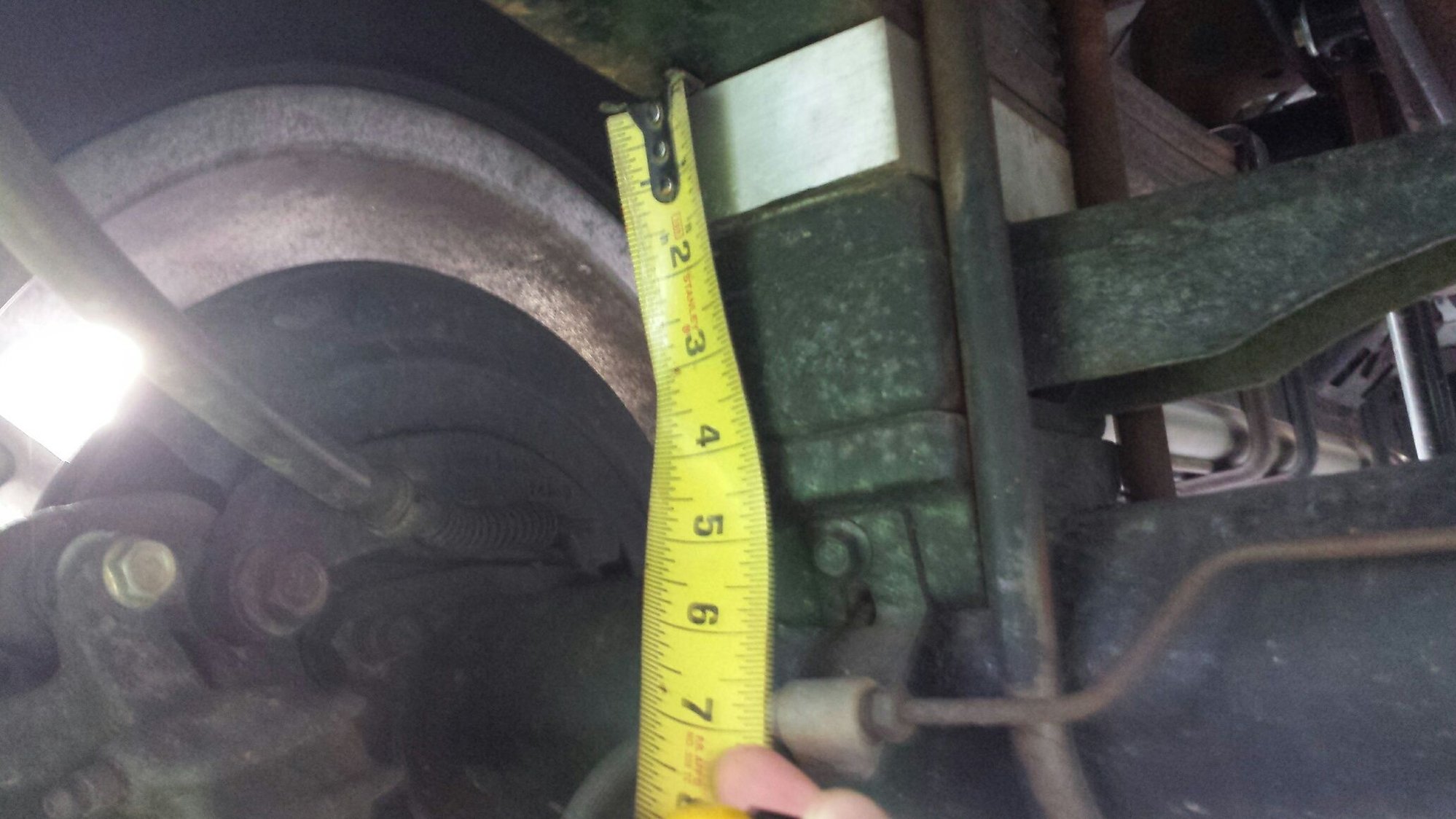

Old Oct 8, 2015 | 02:40 PM
andy9743's Avatar
andy9743
Joined: Feb 2015
Posts: 191
Old Oct 8, 2015 | 02:41 PM
andy9743's Avatar
andy9743
Joined: Feb 2015
Posts: 191
pics are up! lmk what you guys think.
Old Oct 8, 2015 | 02:48 PM
WE3ZS's Avatar
WE3ZS
Joined: Jul 2010
Posts: 12,064
Likes: 1,574
From: Media PA
OK, looks like a stock EX 4X4 block (2.5"-ish) and an additional 1.5-ish aluminum block. You should be able to replace them with a single 4" block or maybe even an F-350 tapered block (3.75-ish). Whichever way you go I would try to keep something with a built-in bumpstop arm like your current stock block has.
EDIT: Measure the front side of the blocks too, to see if they have a taper to them (slightly taller in the back than the front) and then match that taper (as long as you don't have any driveline vibrations now) with your new blocks.

So, welding the blocks together is a no go. Will the bump stop even make contact with the arm, since he also has a lifted spring on it?
X2..... I would go with a singe F350 block.
If it's a spring, it can deflect. And we don't know what spring it is and what the rate is on it, so I was playing it safe.
It's relatively inexpensive to just buy 4" block and less to worry about in my opinion.
