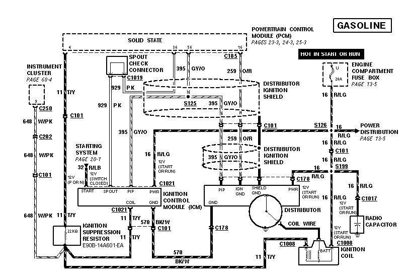

I called it a choke because that's what the wiring diagram shows it as it also shows it as a ground and a resistor

Can you post a pic of the wiring diagram?
Not in any Ford diagram I have ever seen
Lower right hand corner...radio capacitor......
It does not have a resistor or choke (coil) or provide a ground for the ignition circuit.
