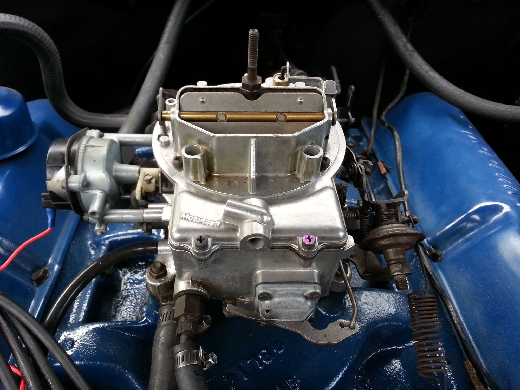

Here's some shots of my carb from a few angles.....it's only after looking at the shot of the rear of the carb that I can see what looks like a vacuum port/nipple that has not been either connected or capped off.What is that, another source of ported vacuum?
