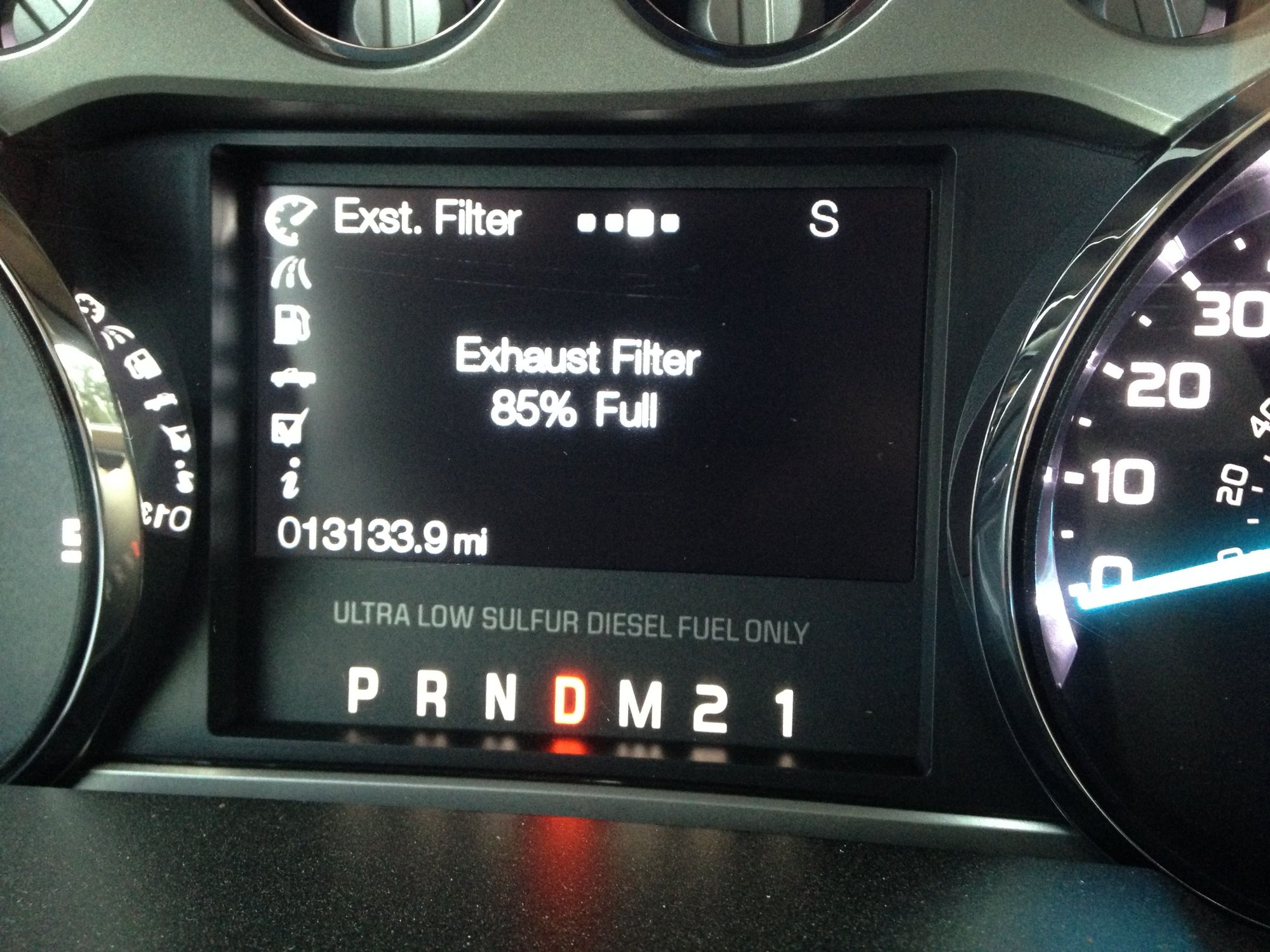

Ok so finally remembered to take a picture of it.

Looks like you have 4 pages there... As mine sits now there is only three pages. (by pages I mean the squares at the top of the screen) Does it add an additional page once the original is programmed?
Yeah but it's blank.
