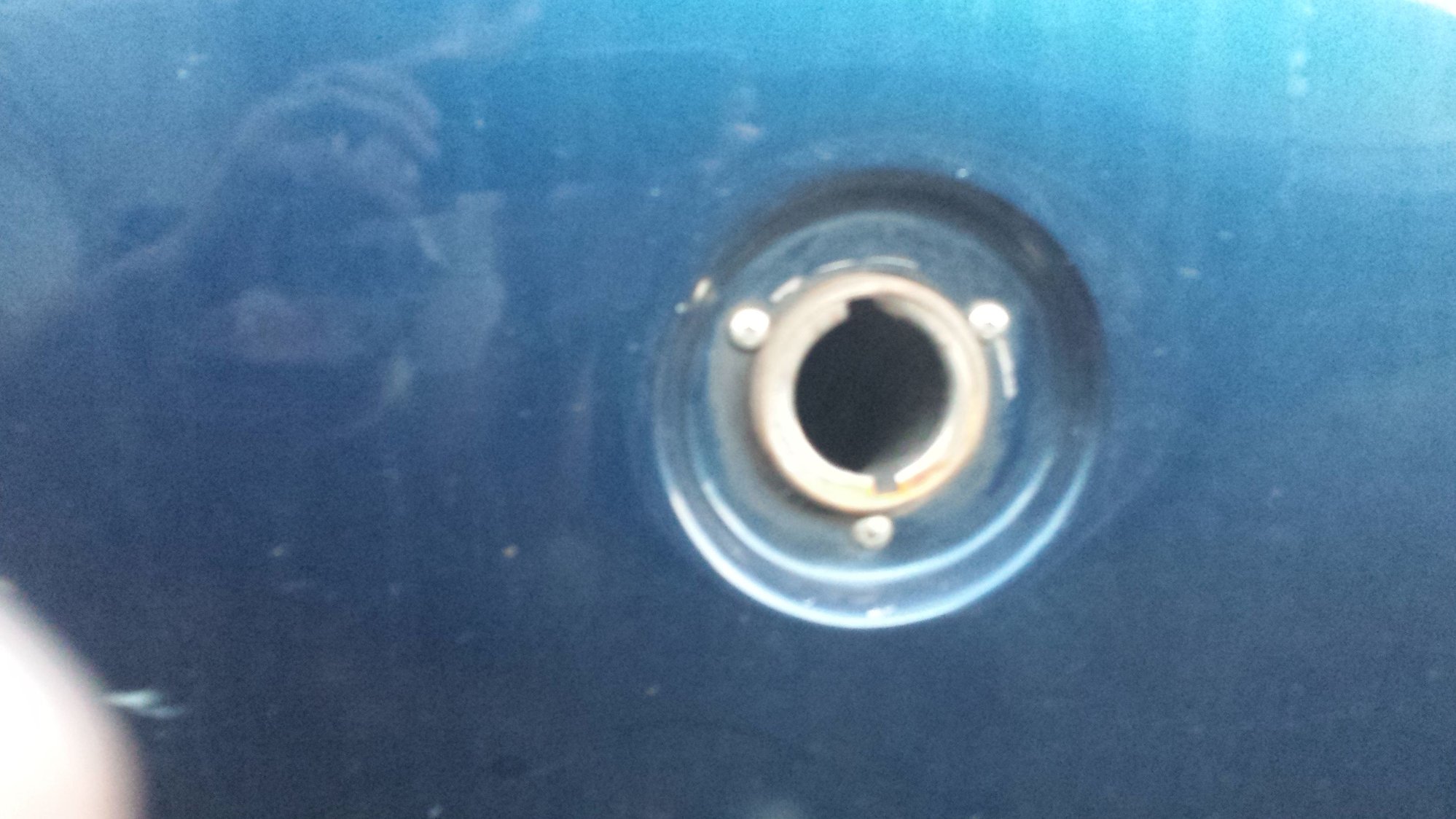

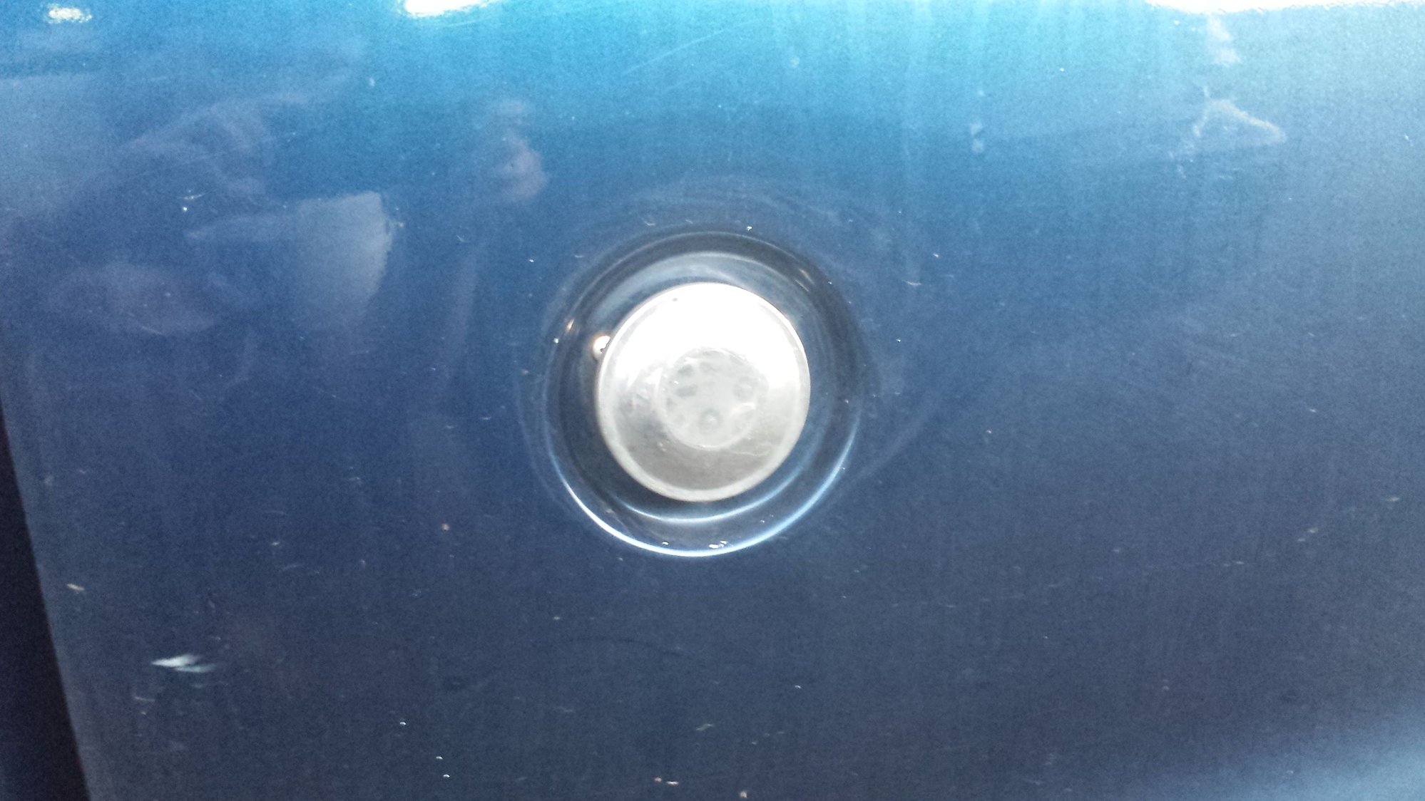

When I added mine I just hijack a rear mount setup from a 73' and grafted it to the bed in the mid ship location.

Hard to see in the picture but it's the black painted area on the bed

Was the sheet metal recessed/dimpled or was it just a round hole you had to drill there?

It was recessed for the filler neck to attach to.

Just went out and grabbed some pictures

Last picture you can see the grafted in panel.
