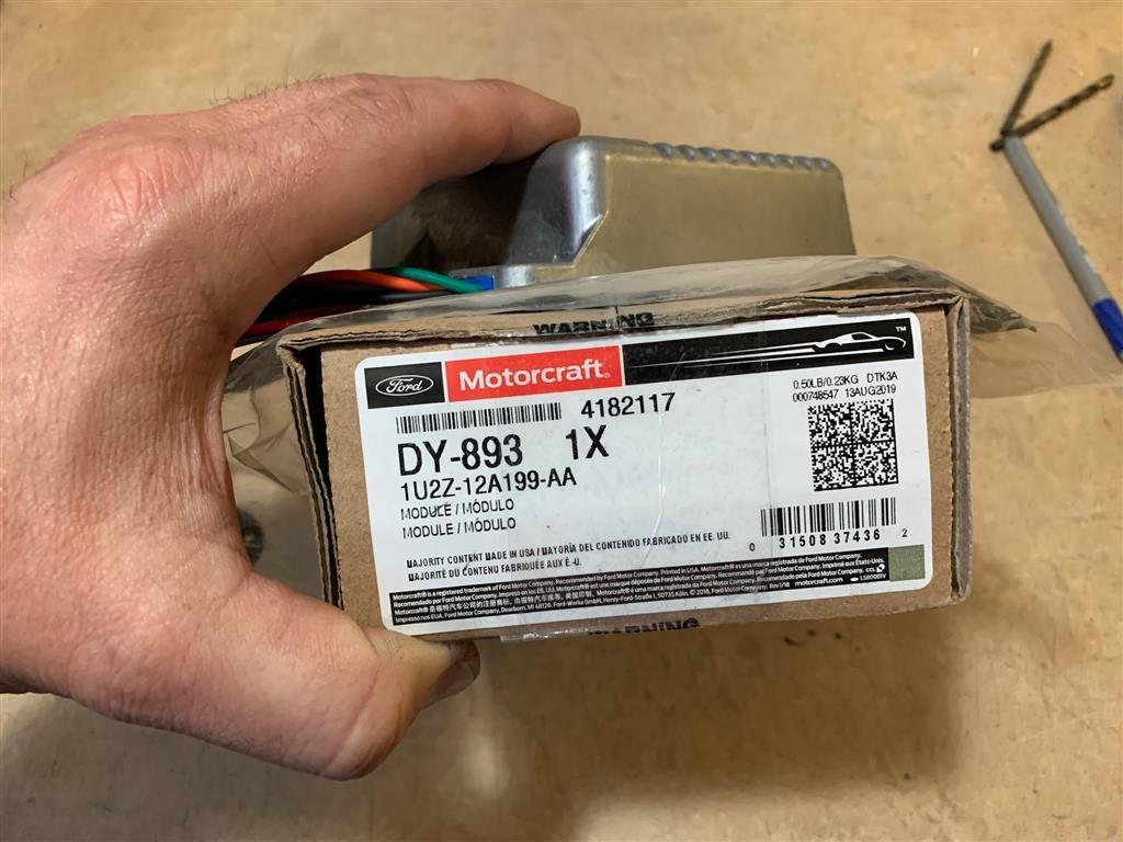

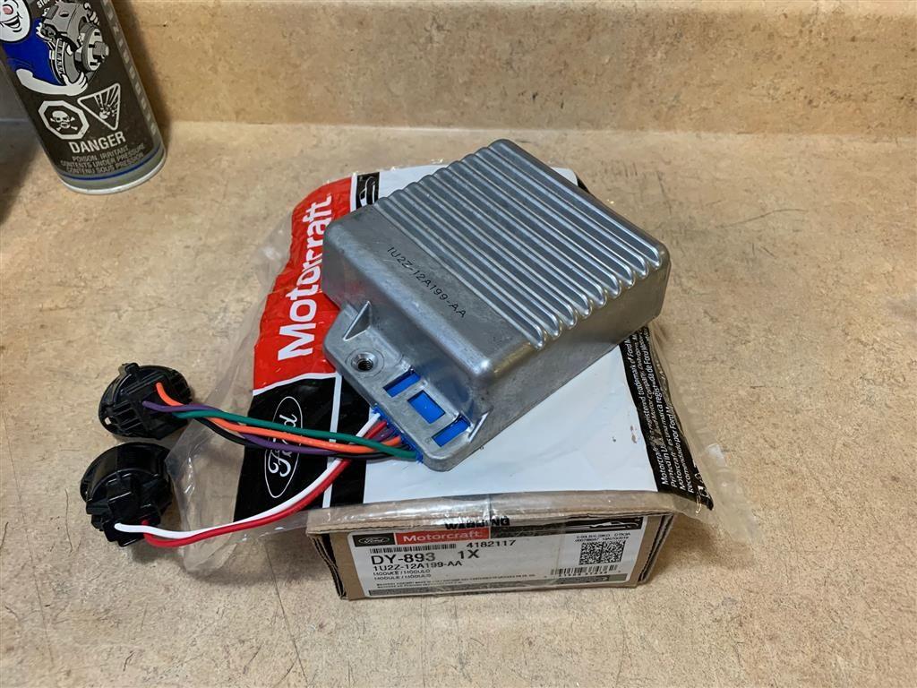

I know this is an old thread, but while on the topic of DurasparkII boxes, I thought I'd mention that I bought one of these Motorcraft boxes on Amazon and installed it over the winter while doing a bunch of other work. My truck became very hard to start. I was assuming it was my 36 year old starter, but for kicks swapped in my old original 1984 DSII box, and my truck went back to starting as quick and crisp as any modern EFI engine. I didn't actually test it, but I assume the new Motorcraft box is not retarding during starting. I'm running a lot of initial advance, and my truck did not like that new box. Anyway...I'm sure it would be fine on a bone stock application, but for me it was no good. Maybe a counterfeit box? Who knows.
The blue DS II boxes do not retard timing during start, they shift Dwell during start not timing. The only modules that had crank retard where the DS II white box. DS I and SSI
There have been some counterfeit Ford parts on the market as of recent. But that does appear to be the standard Wells unit (OEM for Ford).
I thought the blue boxes retarded 4 deg during start and the white boxes 14 deg at start, but that I only what I've read. I have no experience with them otherwise. All I know is that my truck was really hard to start with this box installed, and when I re-installed the old original 1984 box, the truck started like new again and has ever since. The only reason I wanted a new DSII box was that my original is starting to separate in the back...the potting is pulling away from the aluminum due to corrosion, and I figured it's only a matter of time before it pukes it's guts out on my fender liner.
