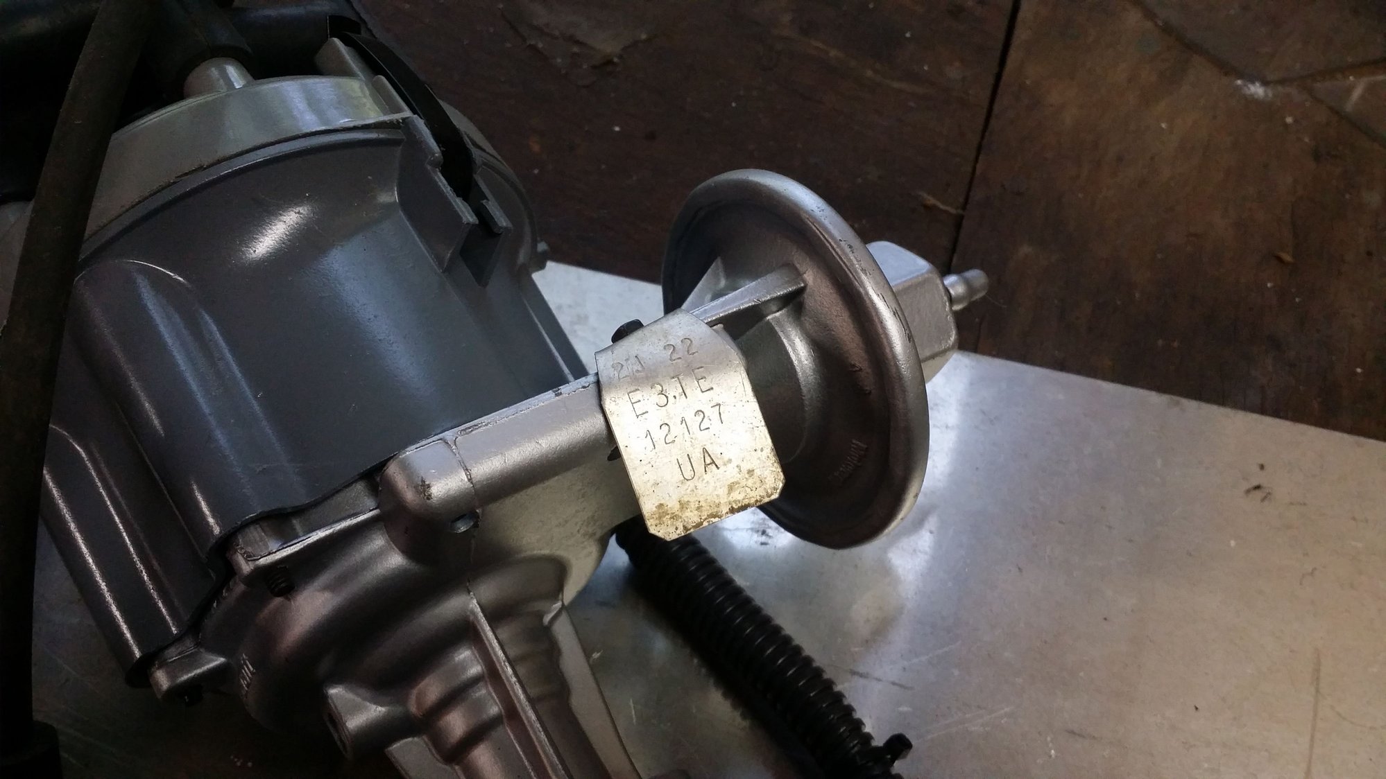

If you decide to run a Duraspark ignition, this is an example of a Duraspark distributor I have that came from an '83 Ford F150 with a 300 inline six.
Hall effect trigger.
The larger, lower cap is retained to the distributor housing with (2) hex head screws that have a flat blade screwdriver slot across them. The upper cap is retained to the lower cap by (2) clips.
The Hall effect trigger plate is retained by (2) Phillips head screws.

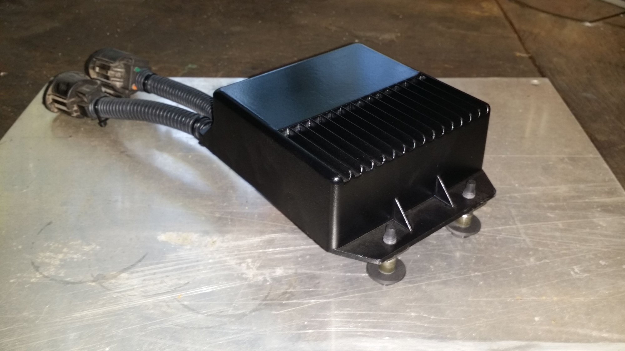

This is the Duraspark module with the Blue strain relief on the wiring.
I made (3) spacers out of 5/16" fuel line tubing that will go over the (3) mounting bolts, between the module and the mounting surface. This will stand the module up off the mounting surface so air can circulate ALL the way around it, to keep it from overheating.
