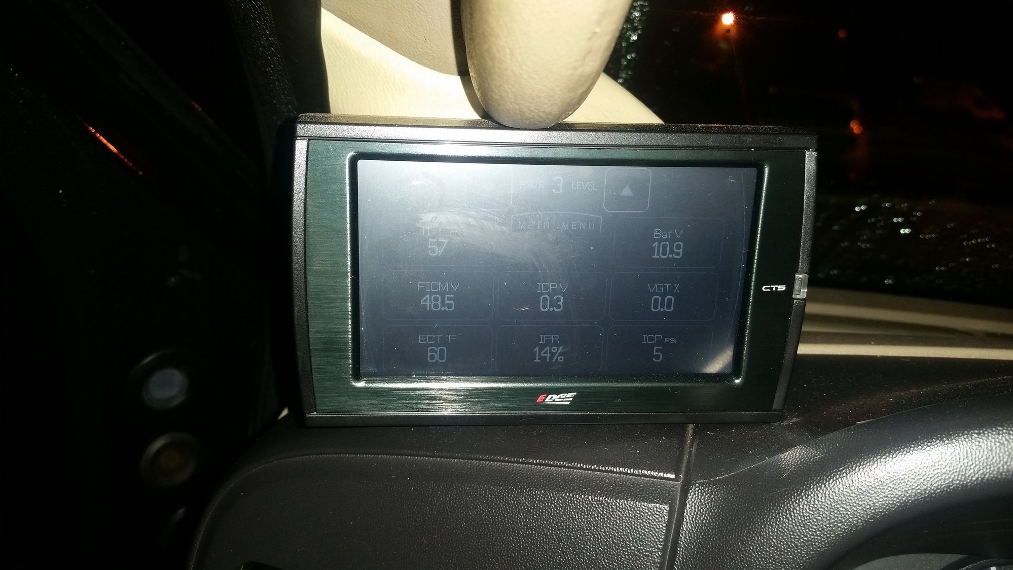

I know it's hard to see, I took this last night when I left work, key on engine off, 49*f outside, it doesn't rough idle
Am I seeing that right, BatV 10.9? You might want to check out your batteries and Alt.

Yeah 10.9v not running, I get about 13.5-13.9 while running, I have to check alt, and batteries, but my ground wire on the driver side batt, is very corroded need to replace that, but other then these little issues, which not sure they are yet, trying to beat the problem, knock on wood this is all I've run across so far, nothing major, but trying to be proactive,

get the ground wire fixed, but it looks like battery issues to me too
