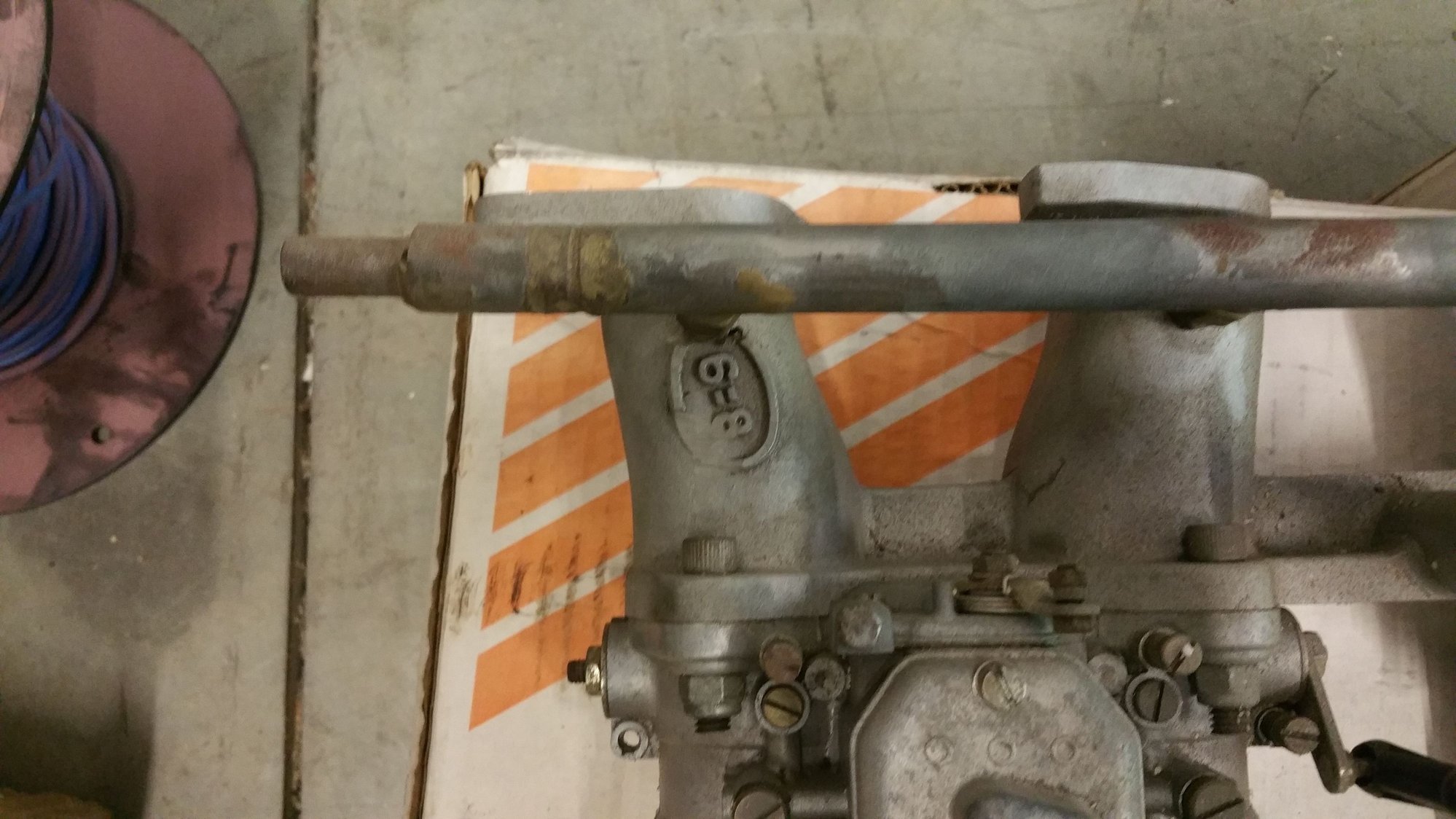

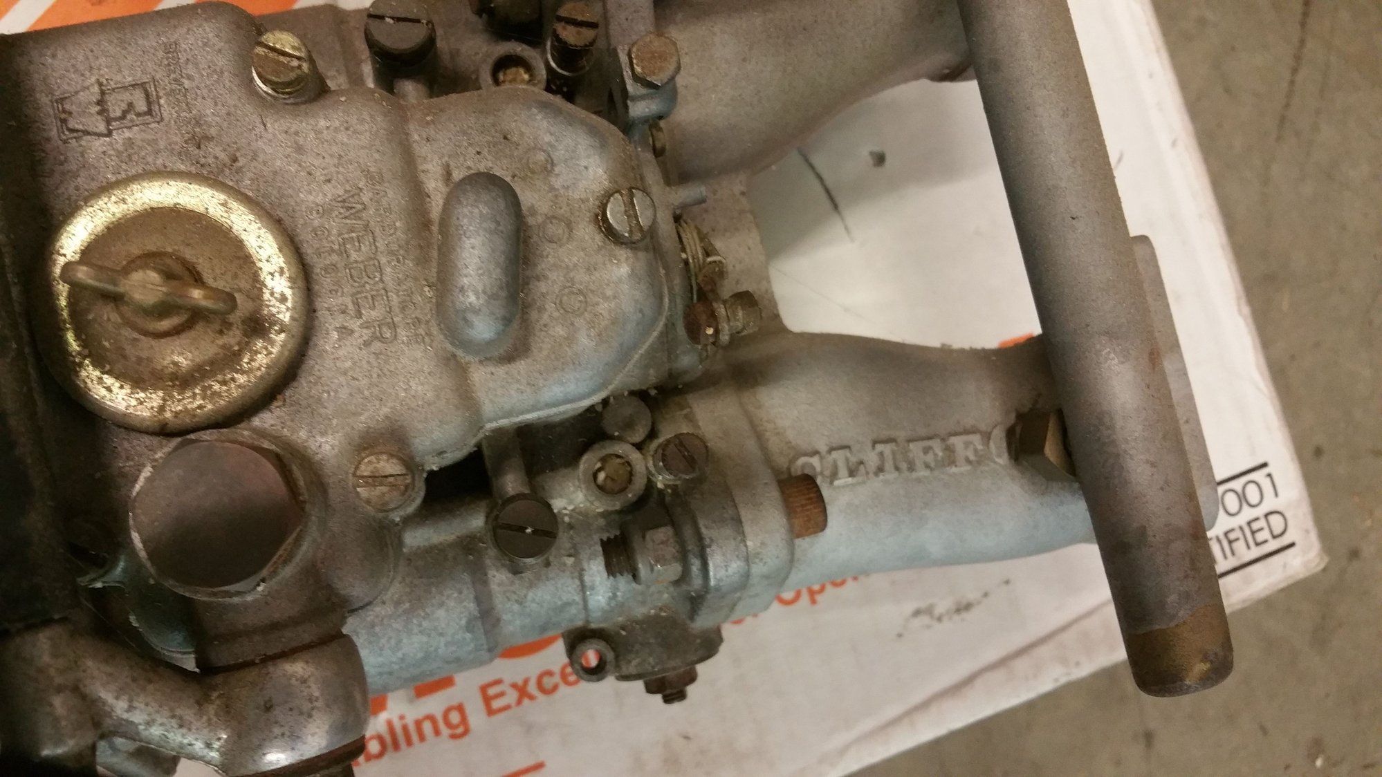

so I found this, and I'm probably going to buy it.
It's a set of headers(that won't fit my truck) a Mallory (he thinks it all in one, going to double check today) and a 6=8 sided raft intake with weber 45's. Oh and there's a Clifford cam lifters and springs new in box
Who knows how good these are and what I should expect to pay for all of it?

45s are a little small for a 300, but will work on the street. Somewhat hard to tune right for a big 300 motor. The intake appears to be cracked.
The Mallory looks like a Double Life (two sets of points on a 3-lobed shaft). I use one on my Logghe nostalgia racer. Note that it does not have an O-ring below the hold-down flange. That requires a gasket between the dist and the engine block to prevent oil seepage out the block. Therefore, the only way the distributor case will be grounded is thru the hold down clamp, which may-or-may-not be a good ground. I found this out last weekend in fact when my Logghe drag car just shut off mid-run, stone cold dead, quit. It restarted at the end of the track (miraculously, I won that round as my comp broke out - we were on our way to a double breakout race). The next morning I added an external ground wire from the block to housing and all was good for final eliminations.
