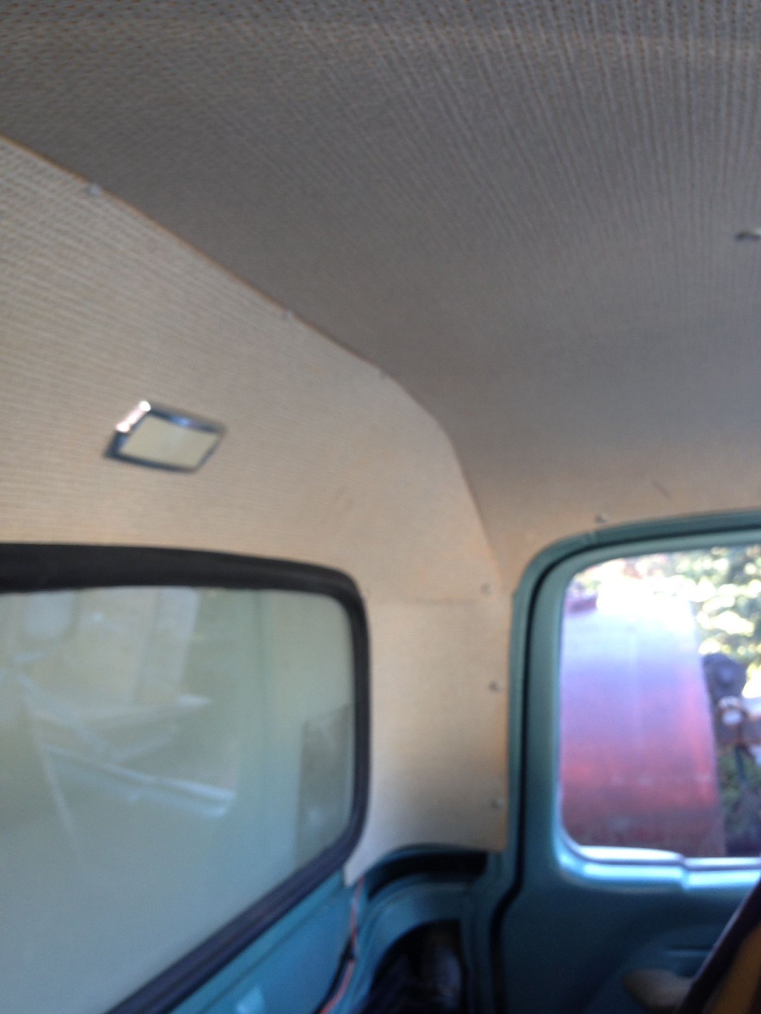

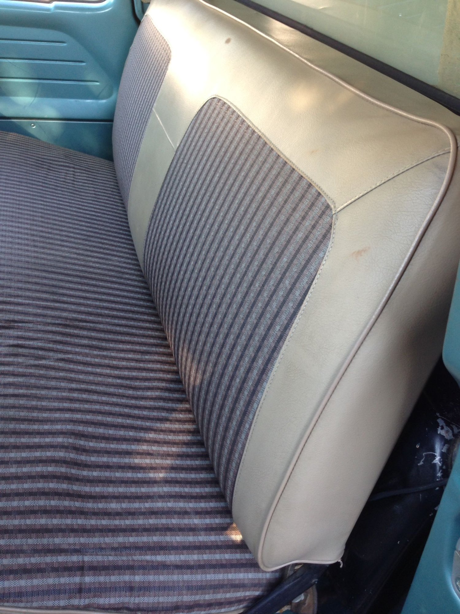

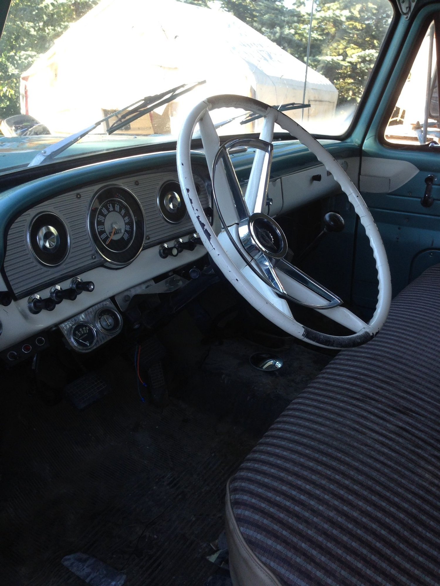

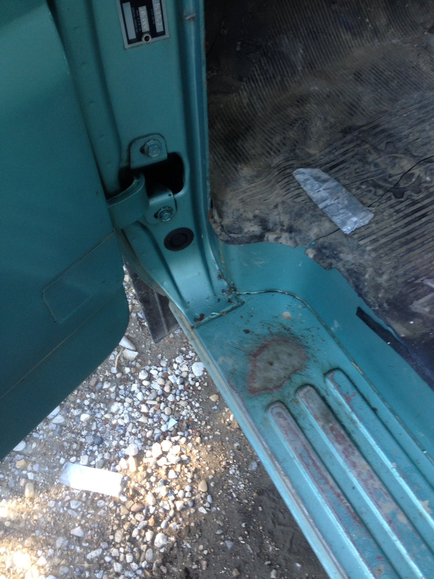

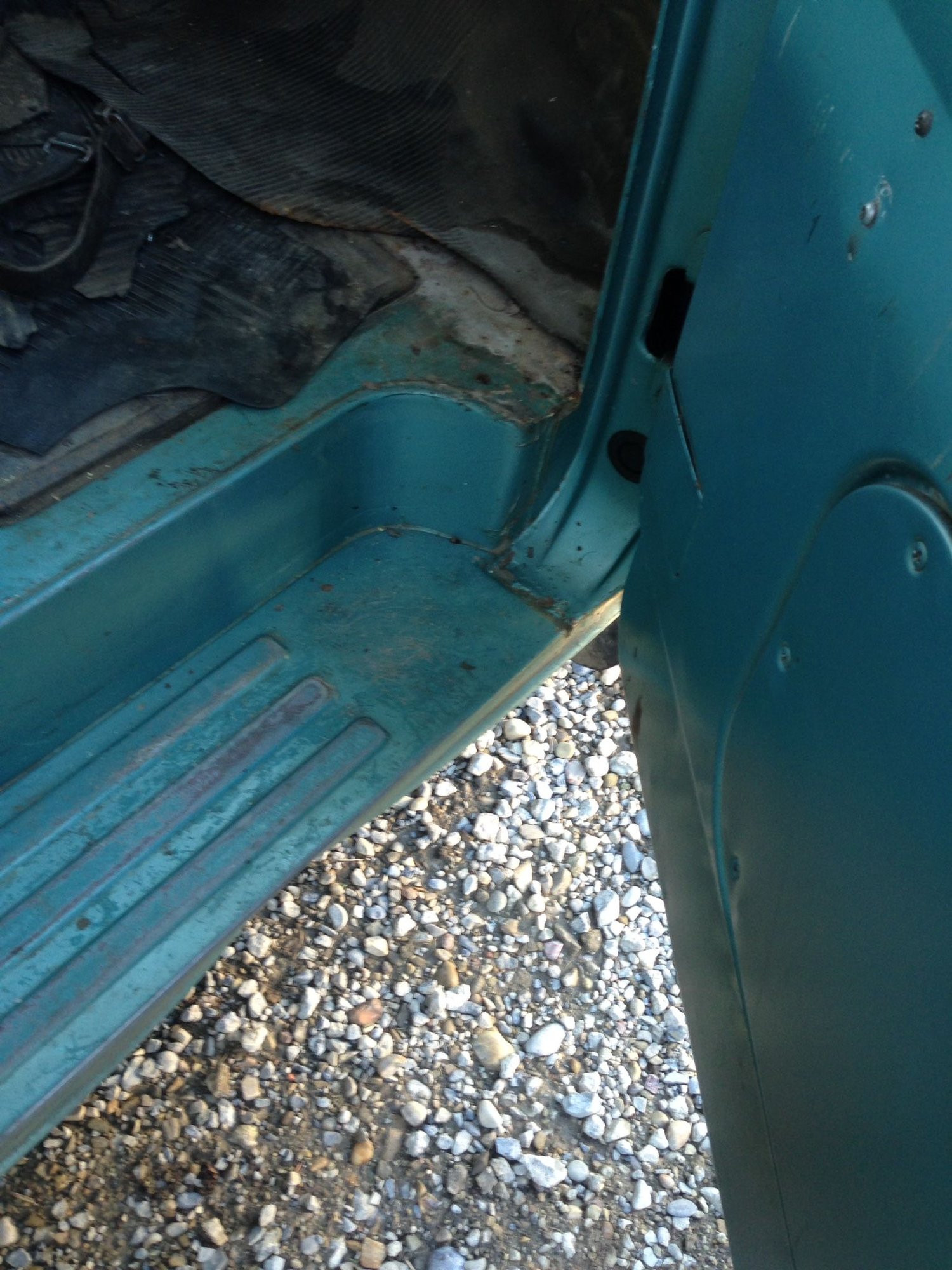

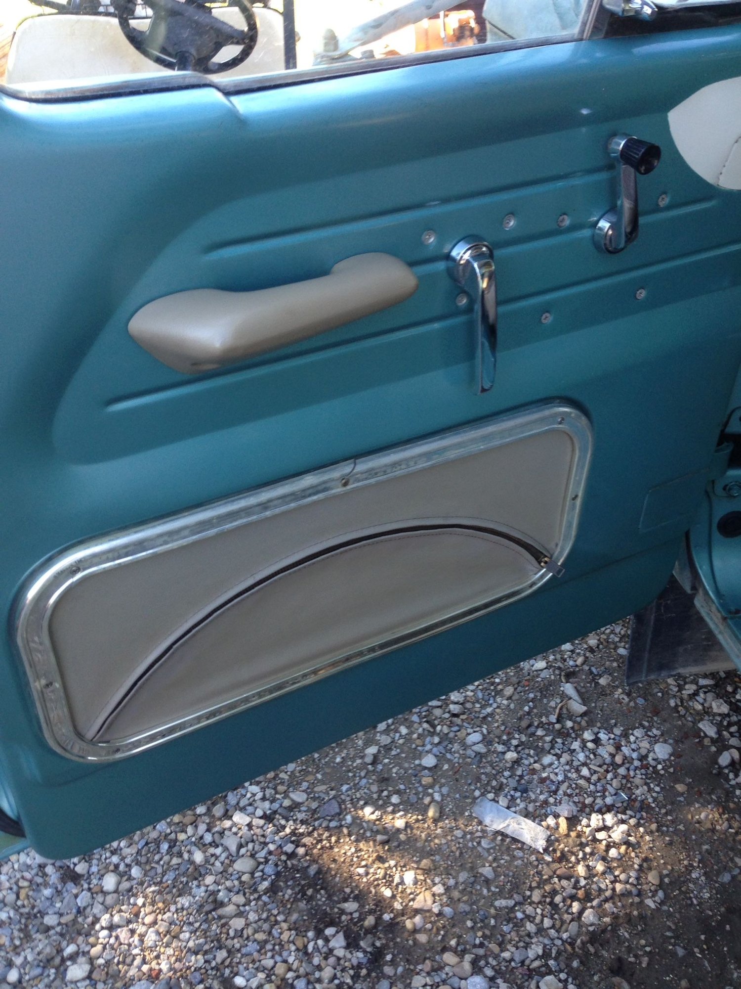

No steve it isn't drivable, but it does run. I bought it for the cab. No rust and the rad support is in perfect condition. Obviously the truck wasn't driven much. 74000 miles. Plus with 5.13-1 differential gears I don't think it was very fast. The headliner is as good as the day it left the dealer. I was very fortunate to find this truck at Picn Pull. Was on the way to be crushed. These big RVs don't make it into the yard because they can't prop them up off of the ground safely. So they somehow tear them down. Probably with pay loader. Anyways I'm glad I got it. ,Doug.
