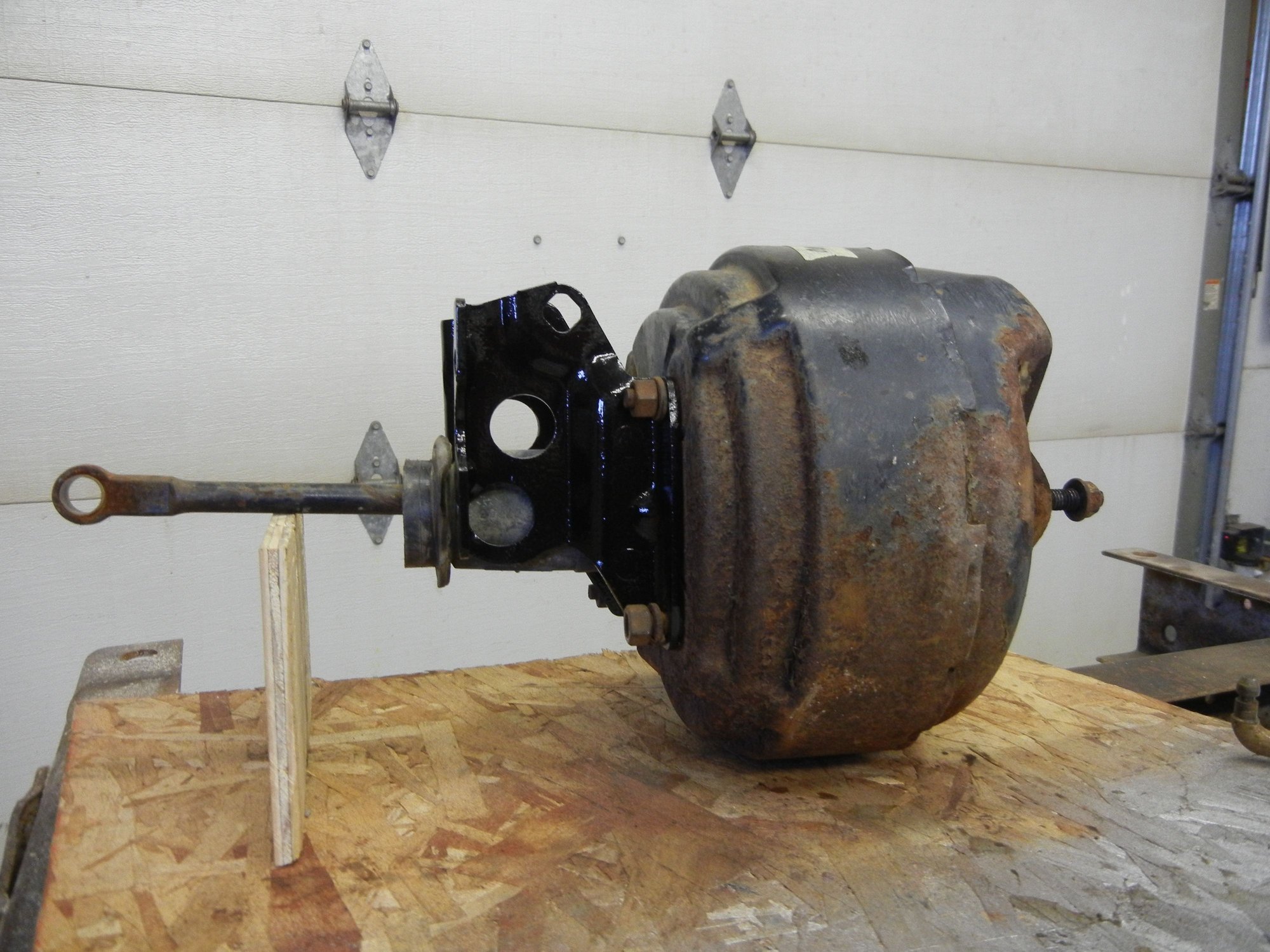

So I found this booster set up on a 74 dentside 1/2 ton at the wreckers. I mocked it up and the throw of the push rod and hook up work perfect for my 68's brake pedal (was std brakes). It's also a smaller diameter, around 9 1/2". Problem was that when I went on line to source a new one I couldn't find this one. I eventually found it under the following applications: 70-72 F350; 73-76 F250, F350. Thought I would share.

I meant to post this on the 67-72 forum but maybe someone here might find it interesting.
