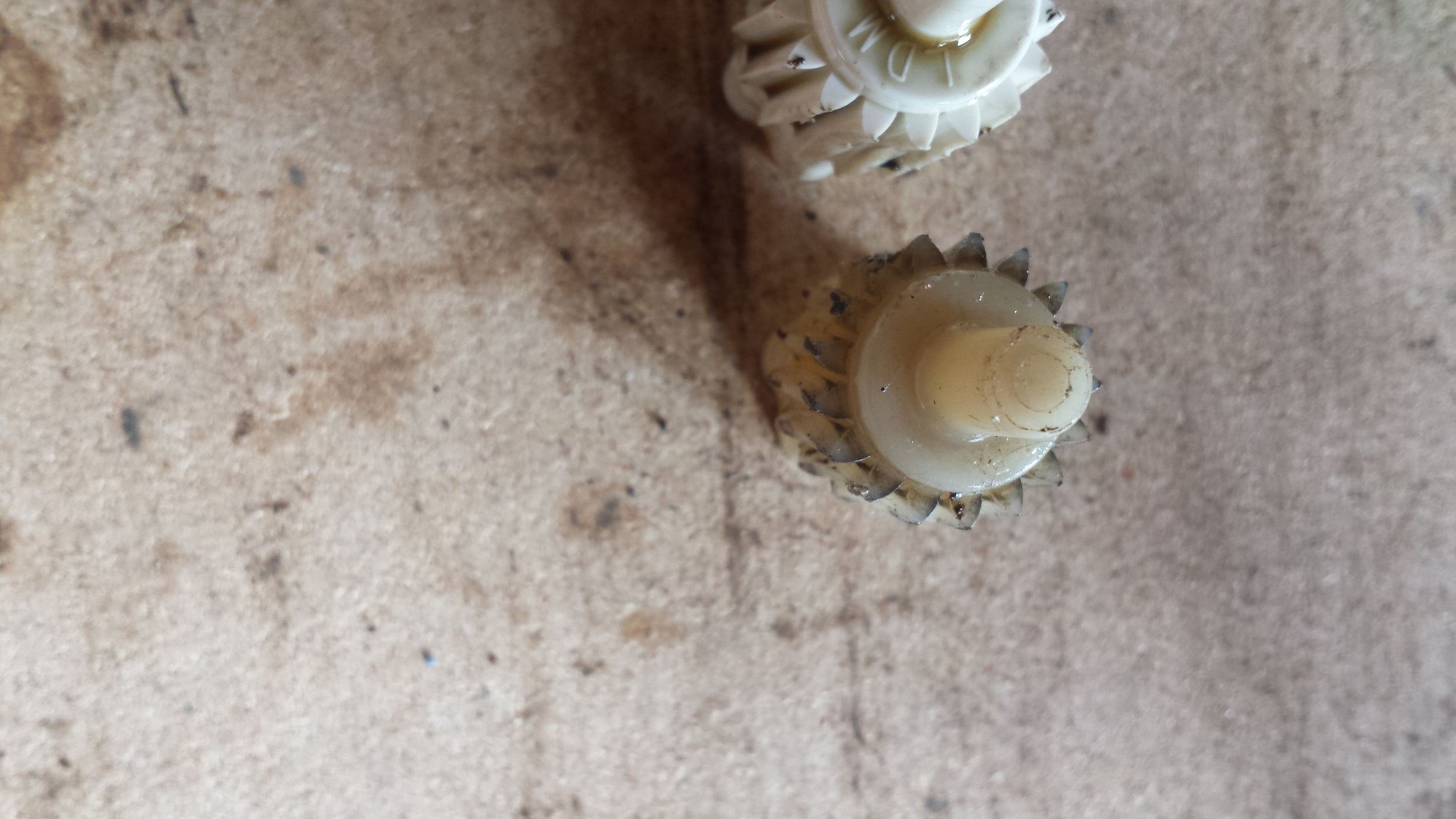

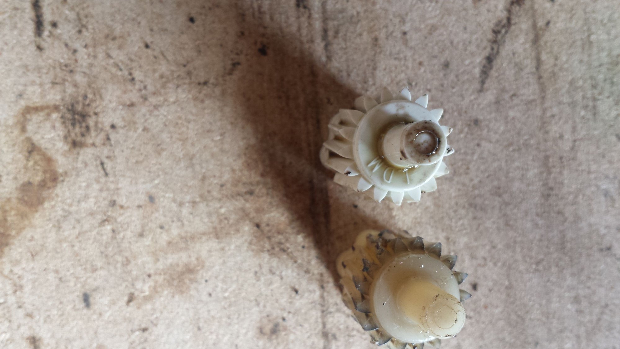

Here are some pics of both the old and new driven gears.
Looking down on the new driven gear.
The old driven gear
Both look like ////
So I definitely don't have 2B. Any other thoughts why they are getting torn up?
The old driven gear
Both look like ////
The DRIVEN gear is retained to the cable with a metal clip. Is the clip present?
Which A/T does your truck have? Is it the original or was it swapped in at some point?
