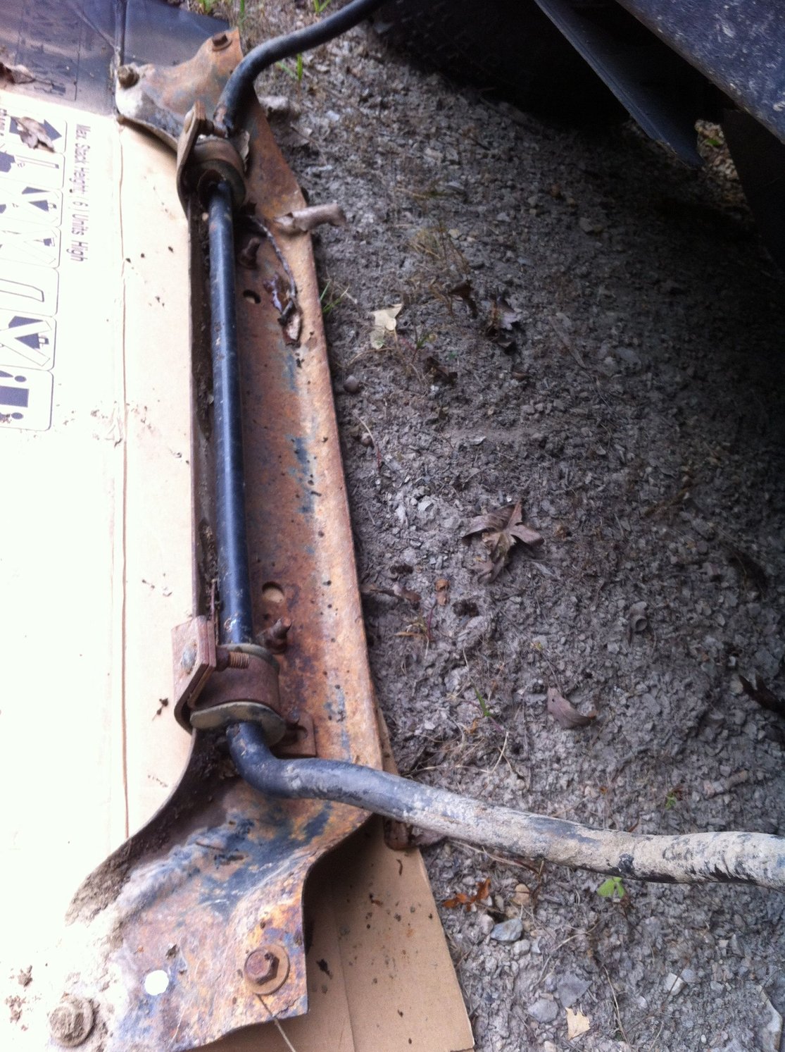

I did not remove the rear sway bar. It pushes a bit in turns but I also installed front helper air bags because of the plow and that makes it handle a bit like it used to. I will compare how the frame mounted bar is on my '87 U150 and compare to my '89 F150. Maybe the frame mounted bar is an option
Is the frame mounted bar interchangable with the one i have now?

Not sure how it is mounted and compare the two frames to see if it is a direct swap

The bar and links are the same on both but the mounts are different. You would need to find the frame type mount
Ignore the lower part. It has a drop bracket for the 6" lift
Too bad you aren't closer...
