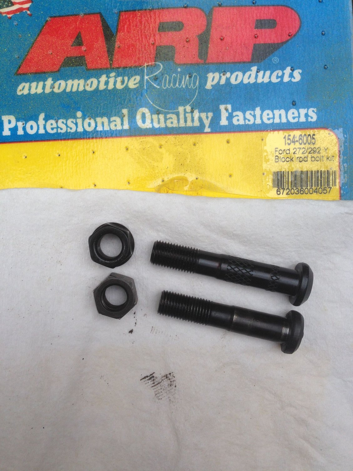

I recently bought a set of 154-6005 Rod Bolts for a 292 I'm rebuilding. The bolts are longer than the stock bolts, have a larger Head, and came with no instructions but came with ARP Lubricant.
ARP Rod Bolt on top.<br/>Stock 292 Rod Bolt on the bottom.

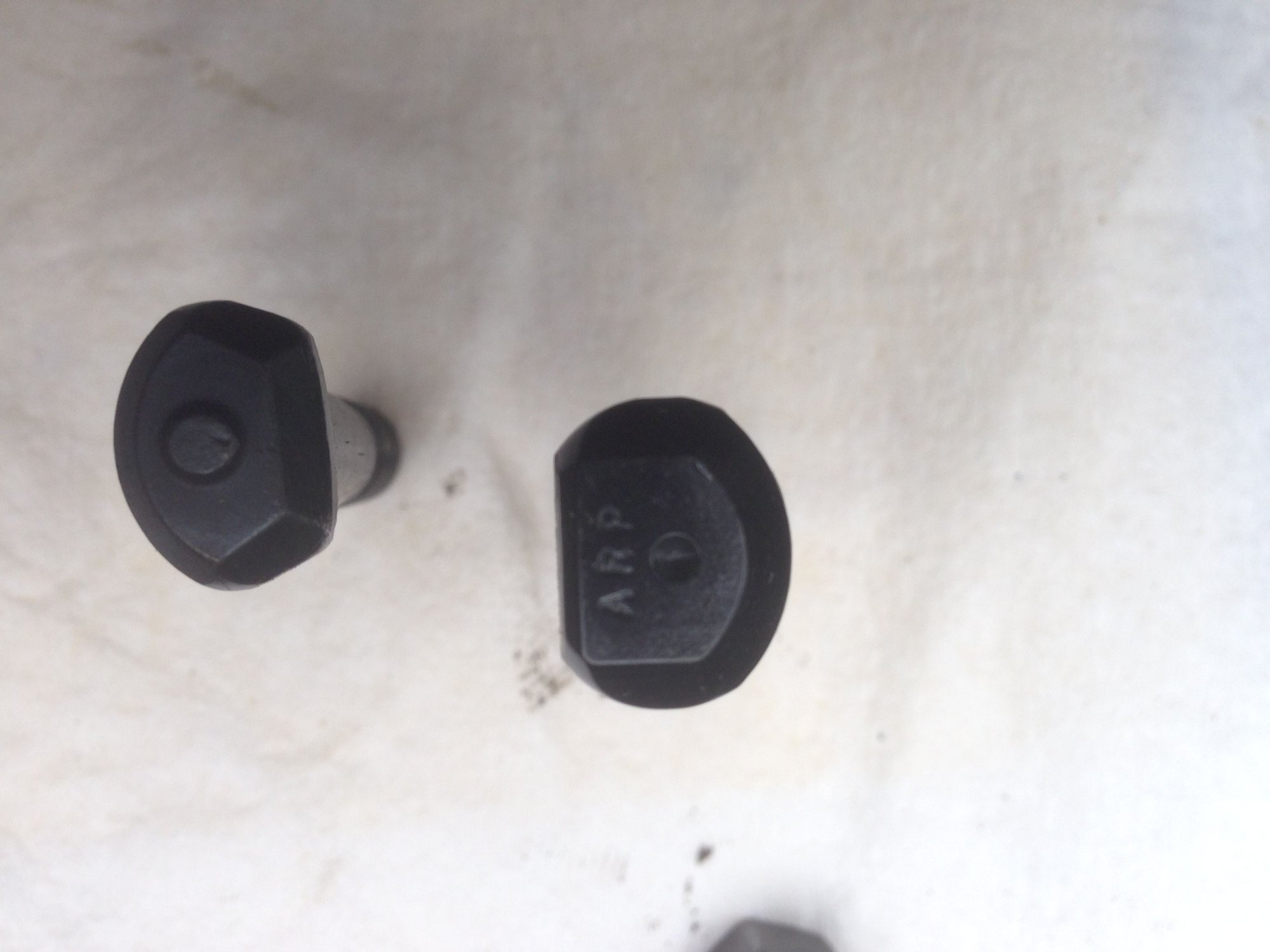

Stock Rod Bolt head on left.<br/>ARP Rod Bolt head on the right.
Any guidance or suggestions? The head is too large to seat on the Rod.

Went to ARP's website and found instructions. http://arpinstructions.com/instructions/154-6005.pdf
Have any of you had to alter your rods for ARP bolts to work?
