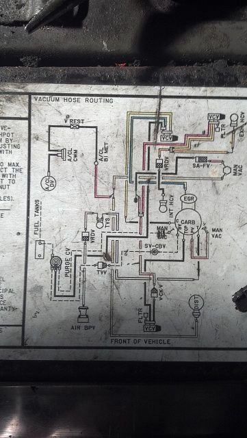

From what I can tell, it goes to the carburetor, so I'm assuming it is a timed port. But I'm really not sure where it's supposed to be, I can't seem to find a definite answer. I suppose there's manifold source at the carb as well. Vacuum diagrams suck in this subject.

5.0 usually had it to a main vacuum on the manifold. There may have been a "T" in the line that went over to the air cleaner for those operations. I have attached a picture.
