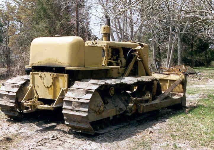

The sprocket nut on my HD-9B dozer if I remember is about 3,800 lb-ft.
