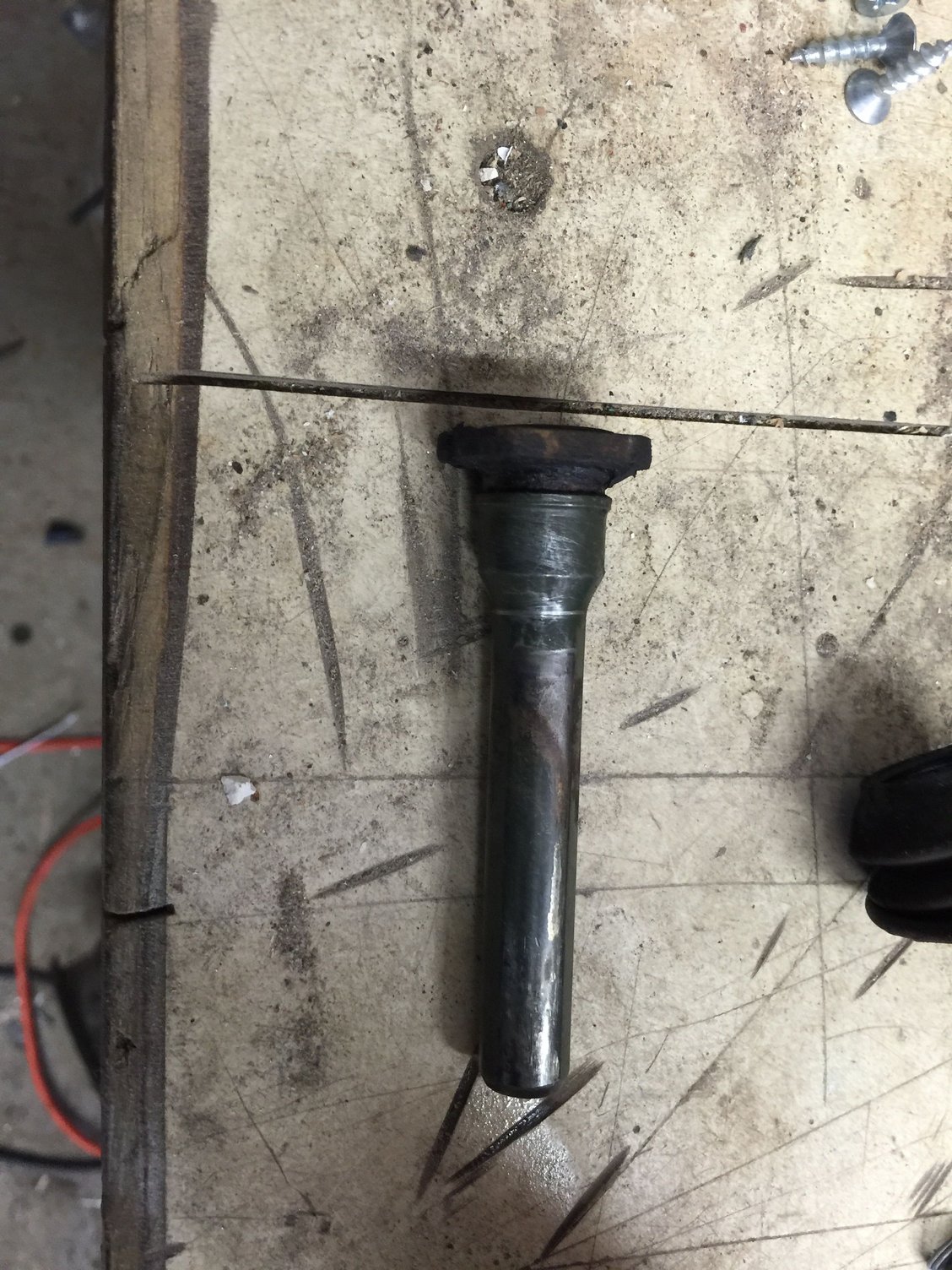

Last couple of weeks I noticed the truck had this distinct brake squeak noise when I was making right turns. I didn't think much of it at first but today I figured I'd tear into it and figure out what's going on. Man I'm glad I did.
In a nutshell, every slide pin on the truck needed to be pulled, wire wheeled and regressed. Some barely moved other just plum didn't move, but weren't seized.

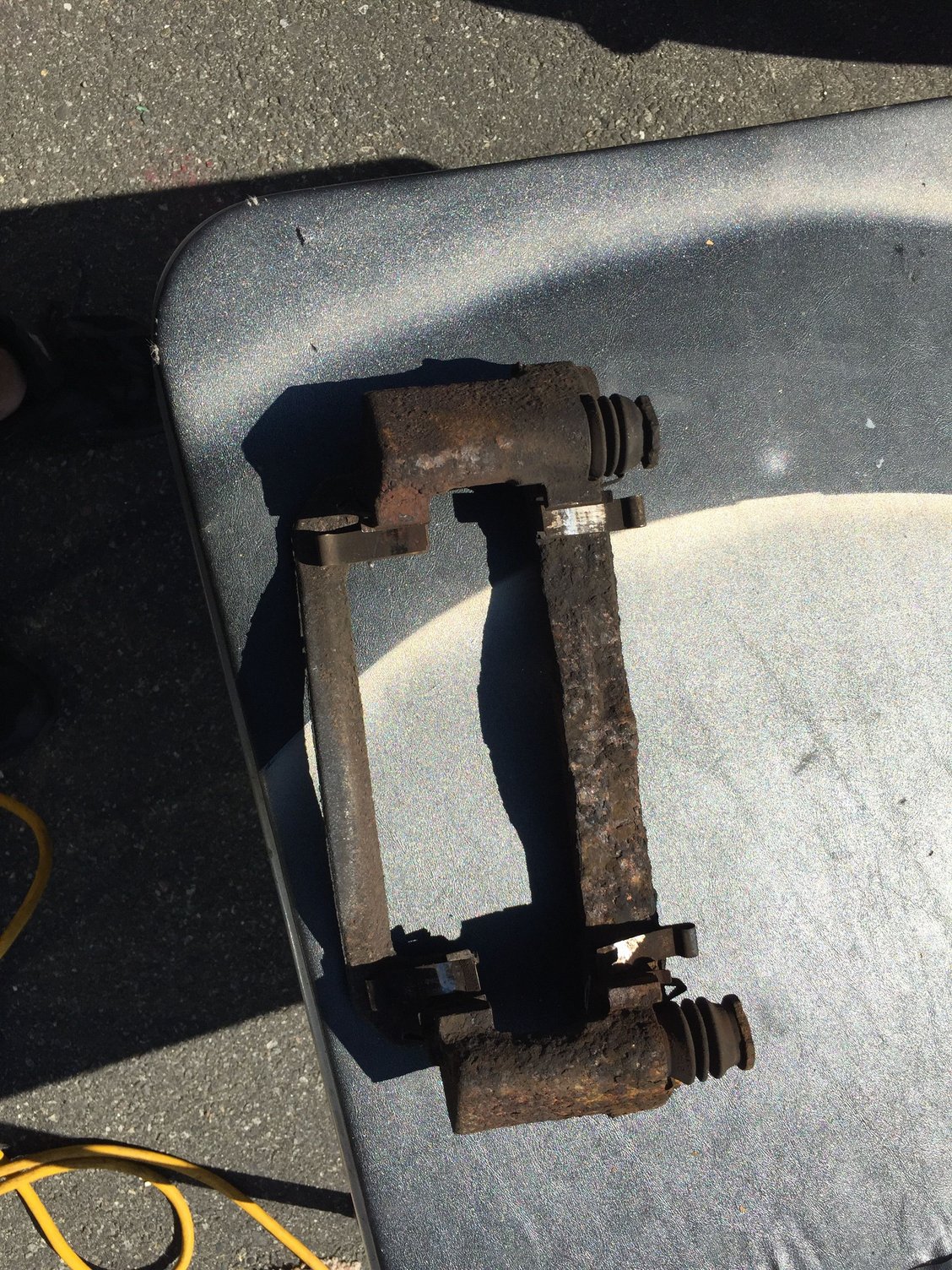

Lovely rusted caliper housing
This was the least worse looking one in the bunch. Some had rust on the top of it like you wouldn't believe.
The brake pad clips were also pretty crappy and didn't allow the pads to move very freely. Cleaned and lubed those too with anti seize
Slide pin lube of choice
Poor thing

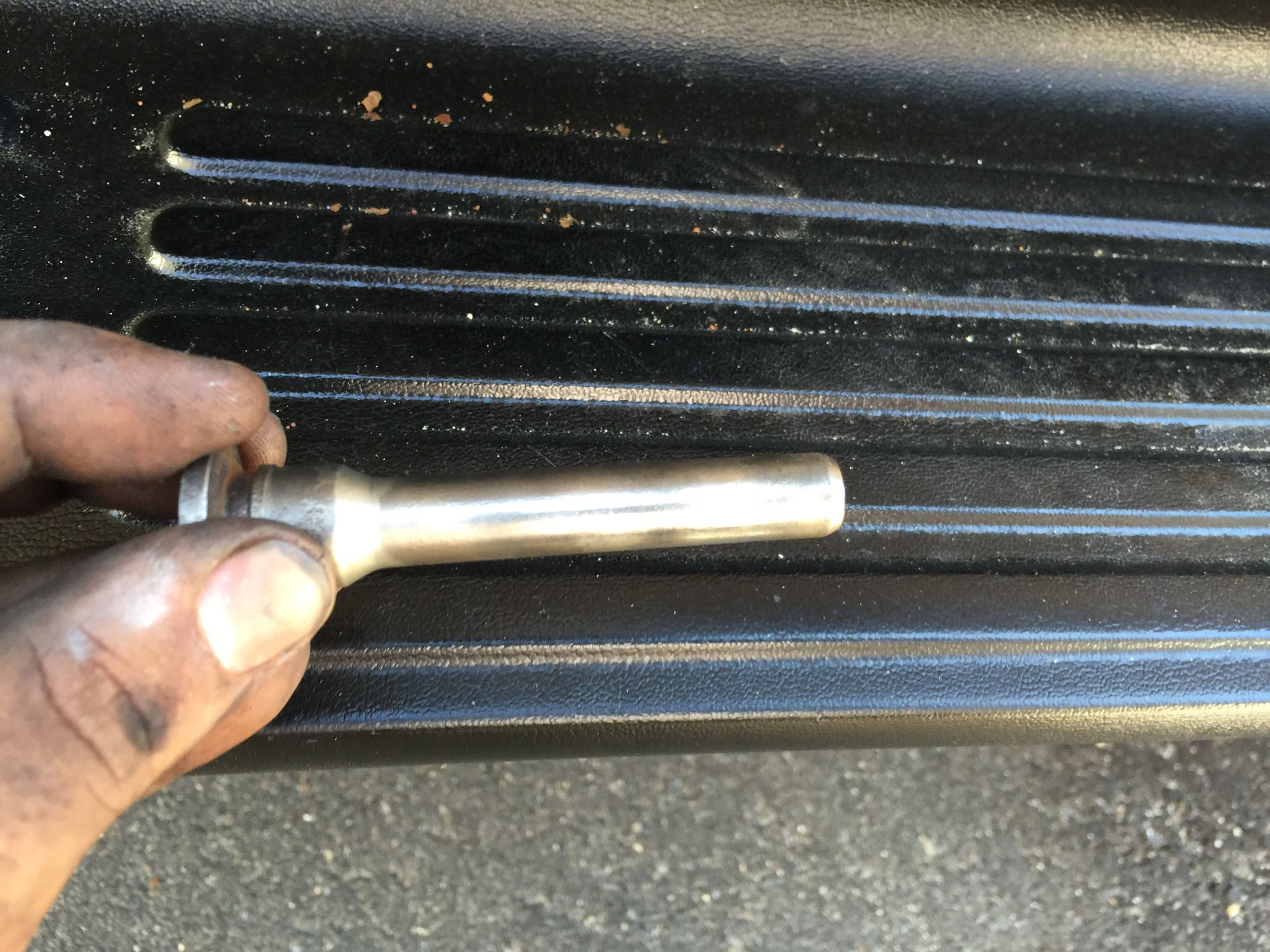

Cleaned ready for lube and installation
Needless to say went for a test drive and night and day difference. Check your brake guys!!!! Little lube now will save heartache and dragging brakes later !!!!!
