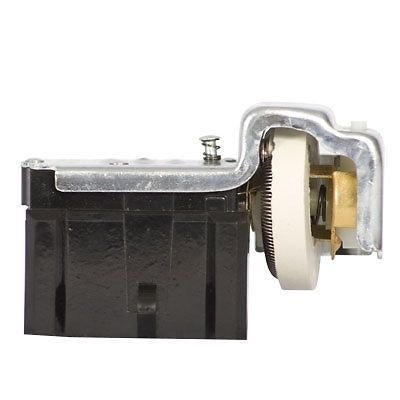

Is this the type of switch that you pull out and a shaft is attached to the ****? If so, there is a release button on the switch itself that you have to mash to pull the ****/shaft completely out. It is not easy at times to reach the release button on the switch.
See the small spring loaded button on top of the switch in the photo? That is what you push if this is your type of headlight switch

I thought it might be something like the photo. It looks like a GM switch from the 60's! They were probably made for multiple brands who knows. I get how that works for sure. I'll see if I can get to it some how. I have the cluster surround panel loose but I can't get my hand in there or get it in from the bottom. Looking behind the panel is not too spacious and I can't see much of the switch either. Now that I know what I'm looking for maybe I'll get lucky.
