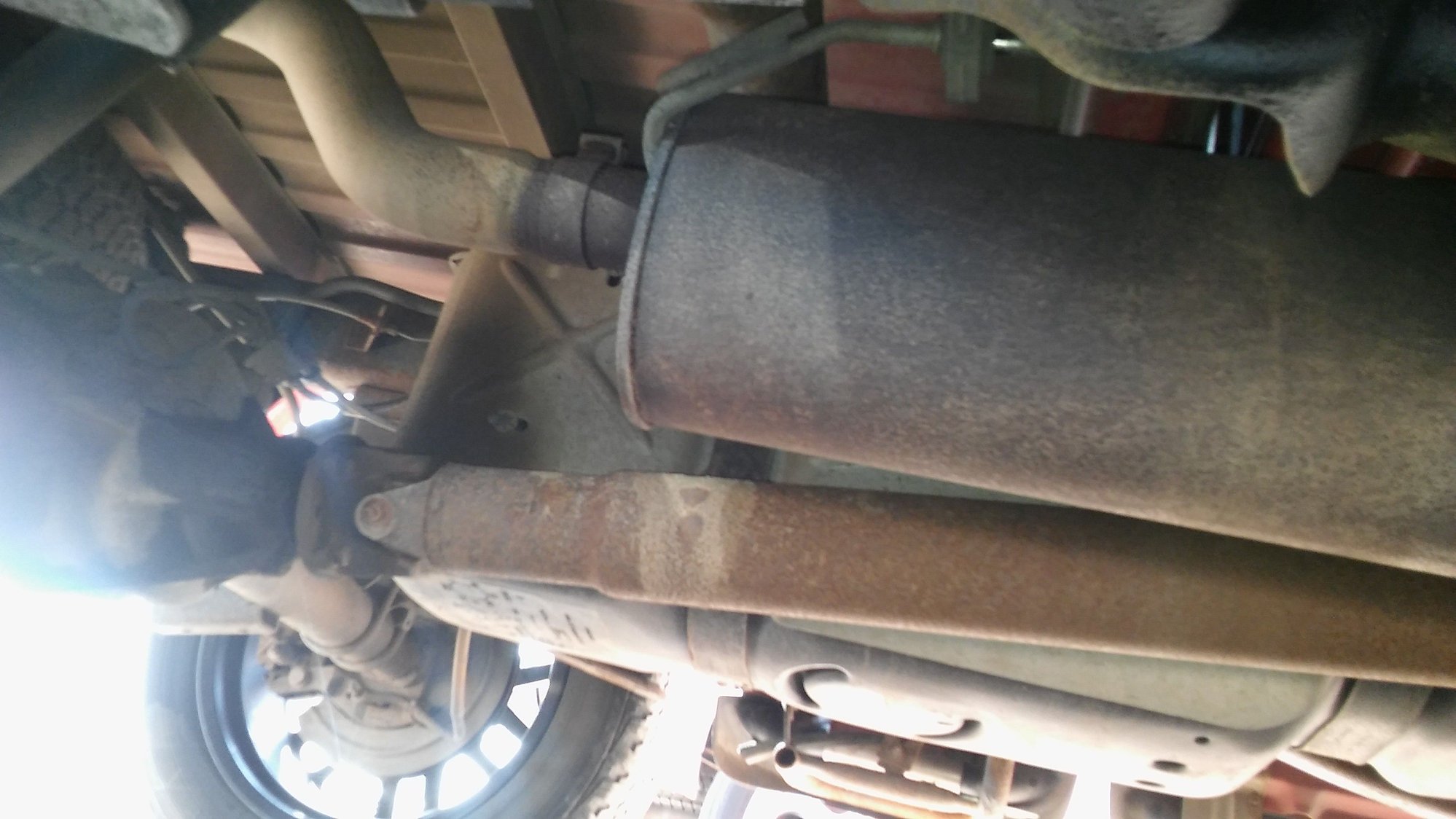

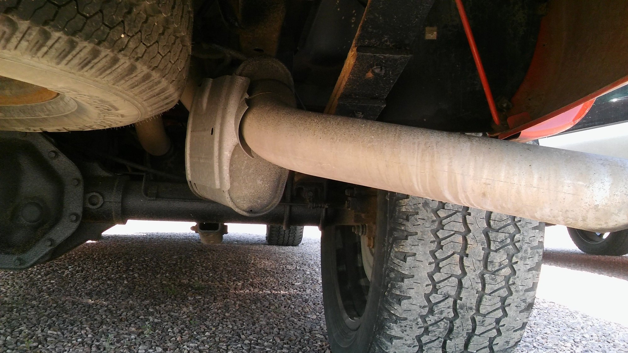

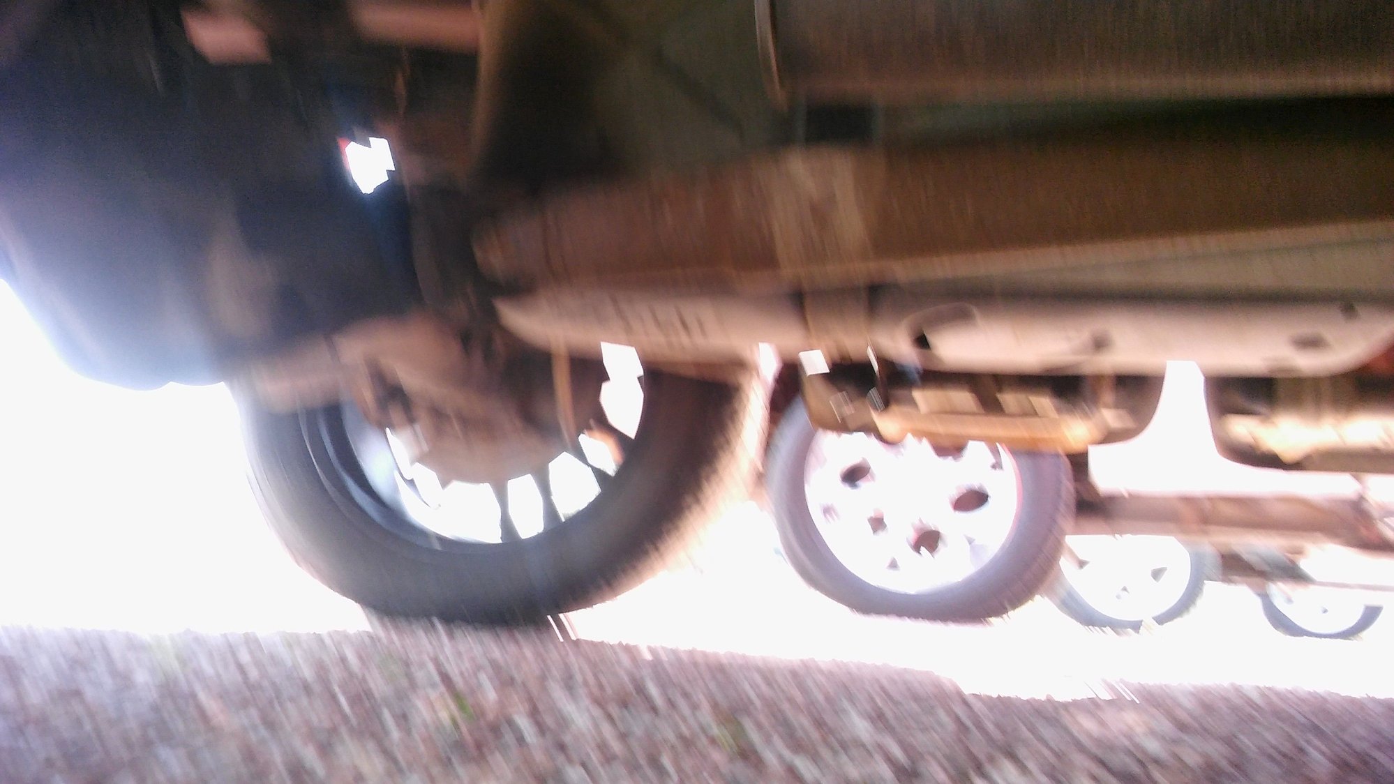

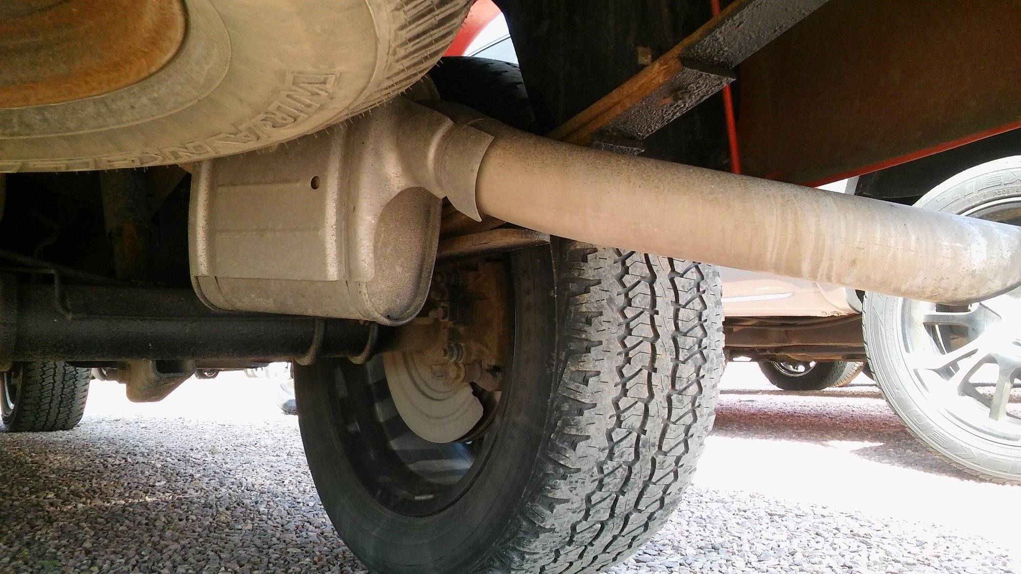

Just out of curiosity, ford your new system look like this?

Not exactly. The thing (resonator?) right behind the rear axle is in about the same position, but it is round-cylindrical rather than oblong-cylindrical. The muffler part is about the same but the one in your pics looks like it's mounted in a vertical orientation (or else the out is off-center toward the top), mine is horizontal oblong cylindrical (longer axis is horizontal). If any of that makes sense ...

That makes sense. The pics I posted were off a ram. Not sure what yours came from, but it wasn't an f150
