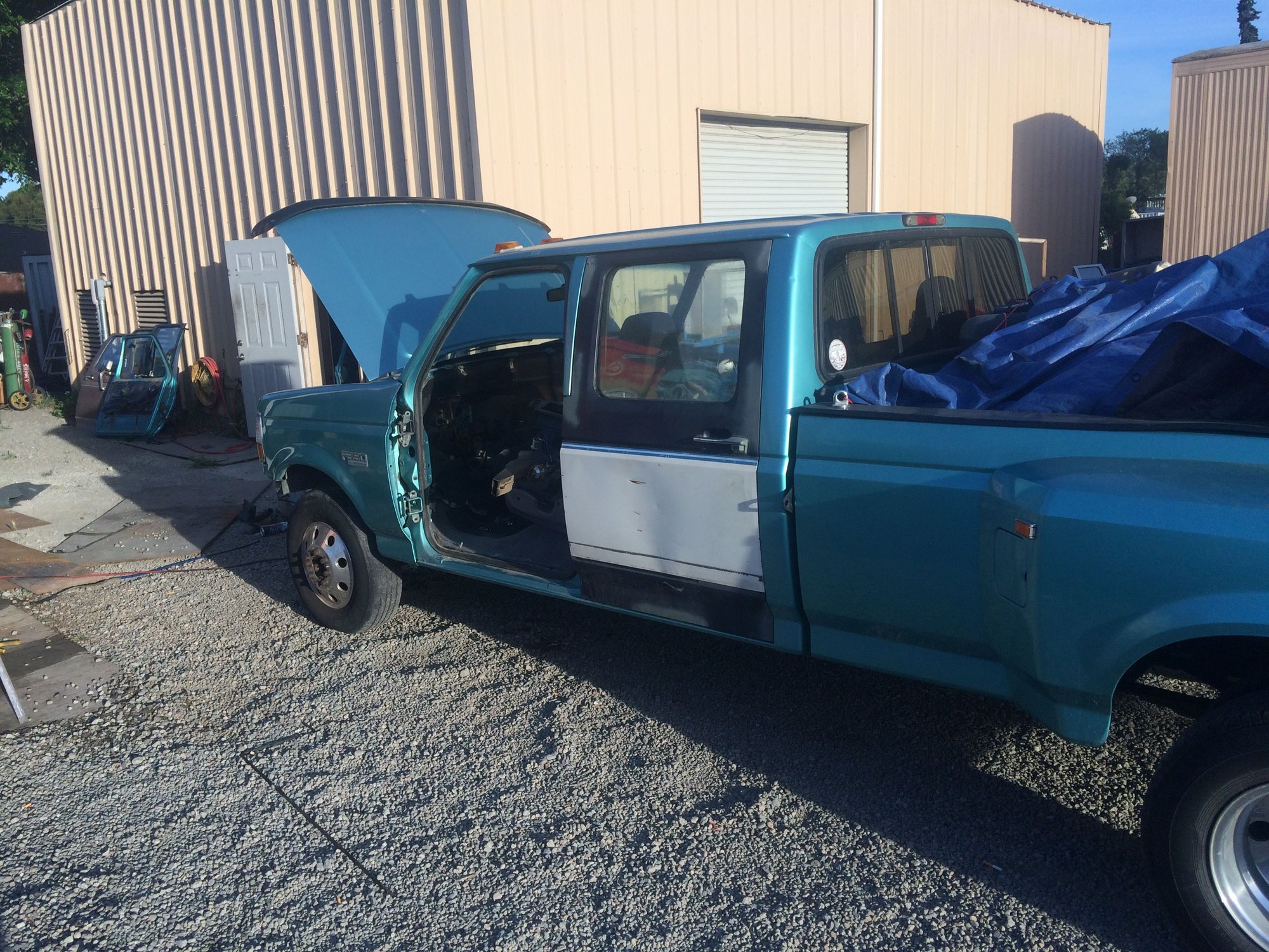

what, do i work for free?
here are some pics of the OBS i stripped for the 6 door.
