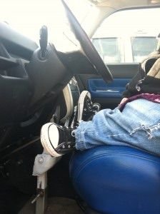

I dont know if the driver in that pic is 5'2", but I am guessing it is close.
I agree, bucket seats would be the way to go.
