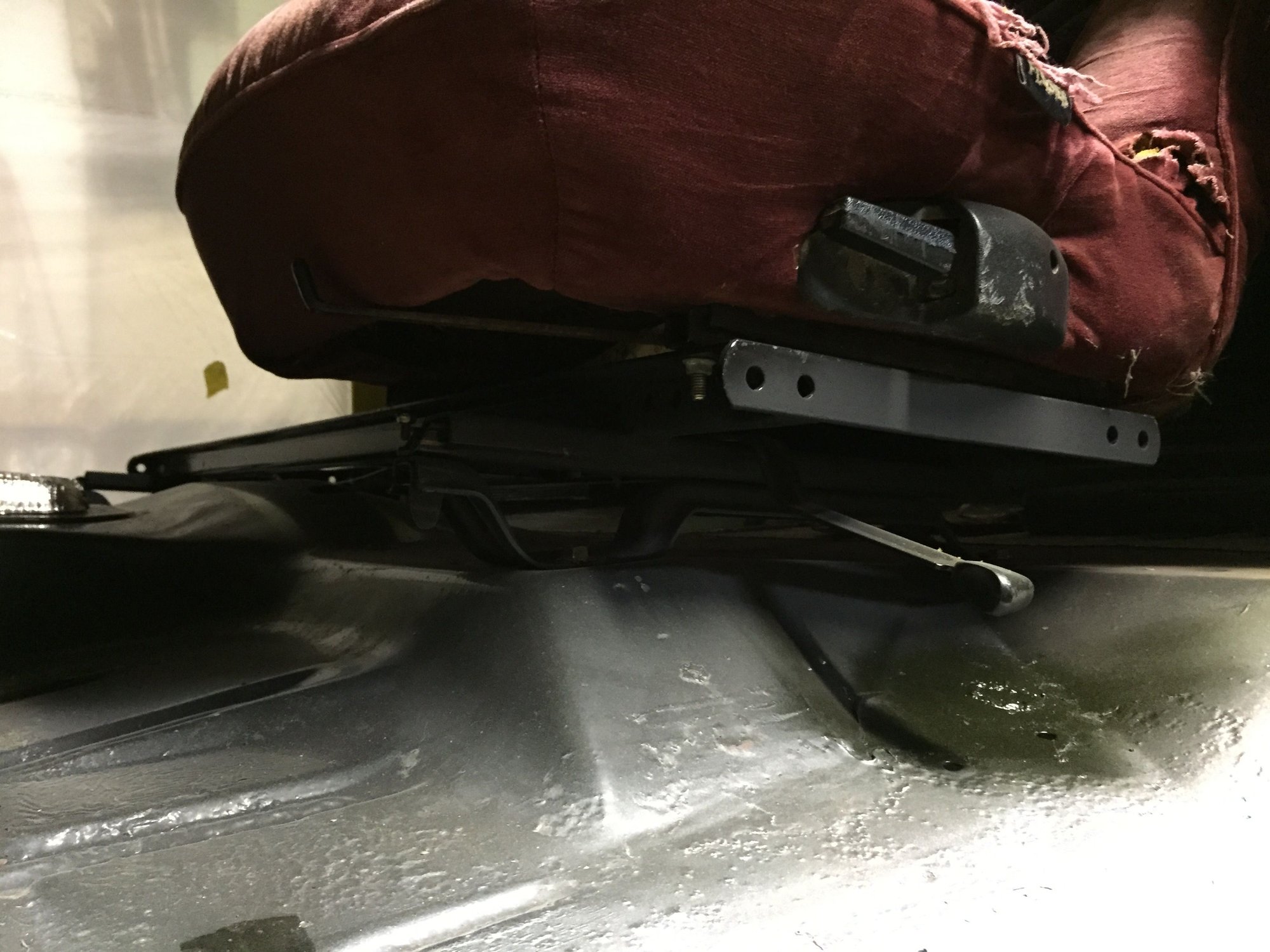

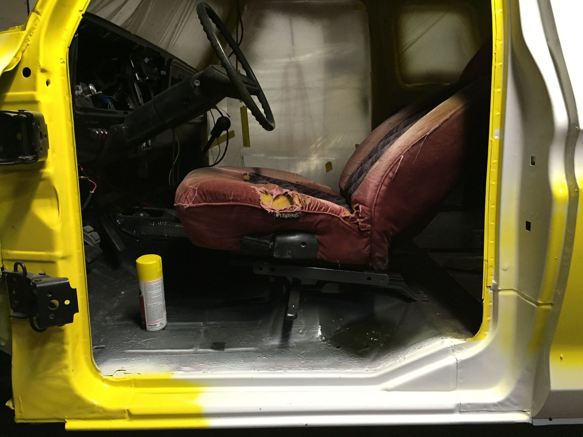

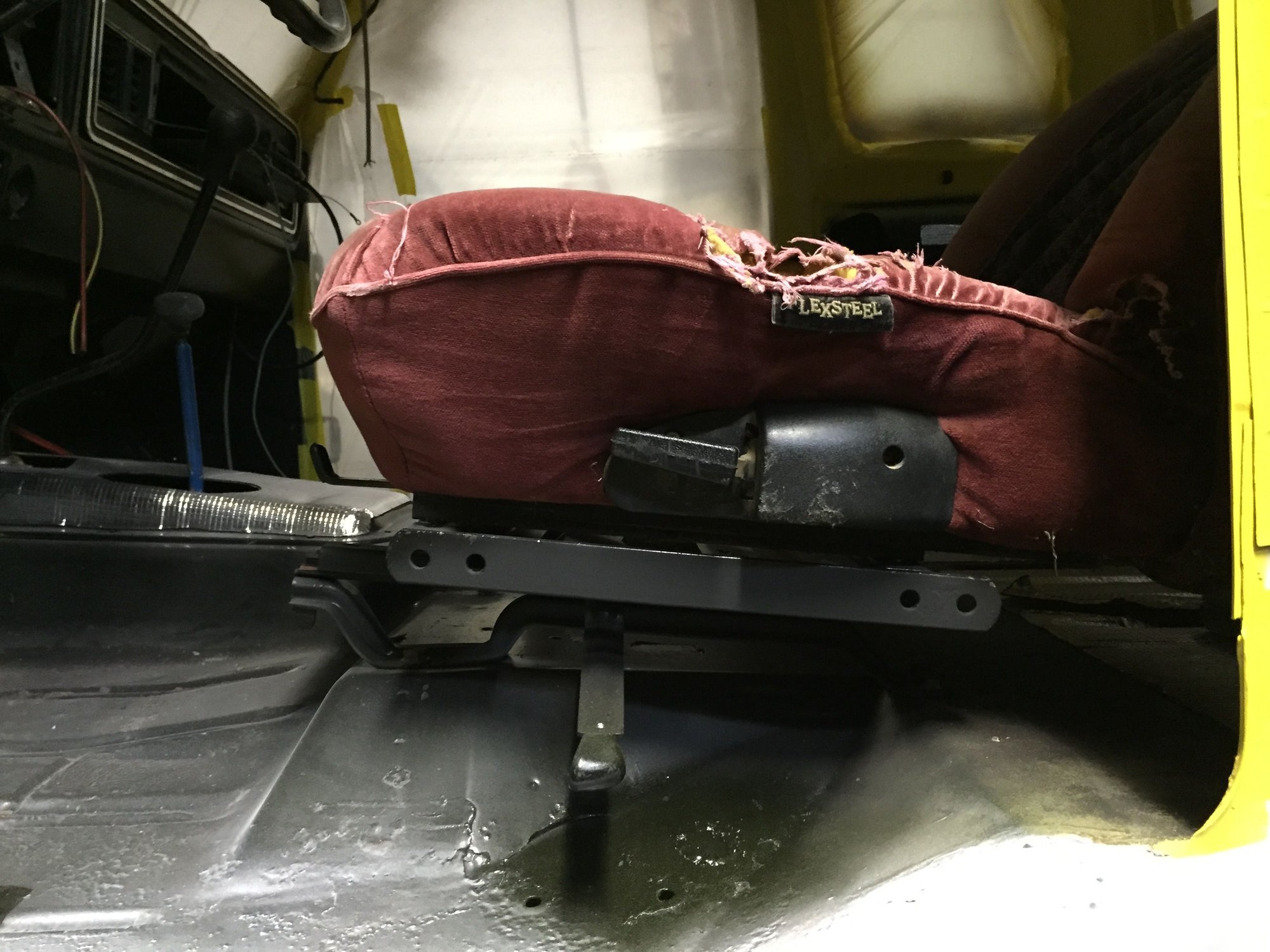

Stock Supercab bench bases mounted to floor, seat bracket mounted to that, each seat has it's own adjustment also. All in all I have about a foot of adjustment. It wouldn't take you much to make a full length bracket under the seats to mount to stock sliders.
