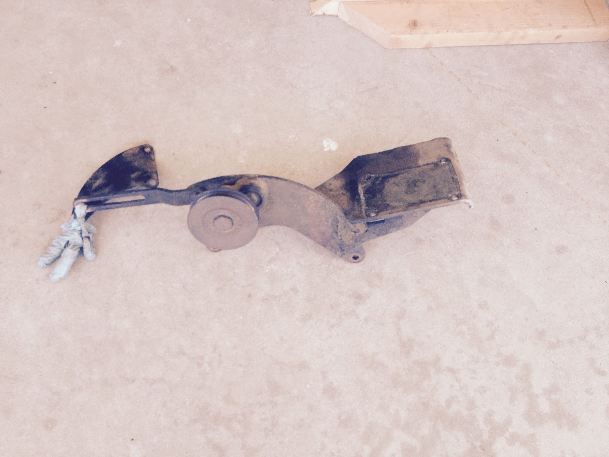

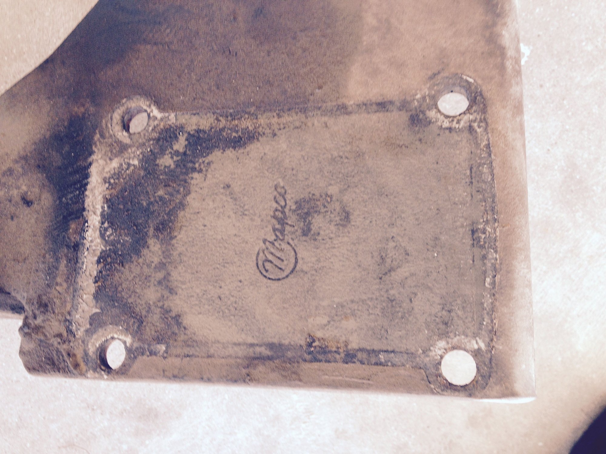

Need a little help with some information on a bracket that I recently pulled from a 1973 Ford truck. I have seen the same exact bracket on a 1971. Both brackets were on a Y code engine (360). This may simply be a coincidence. The brackets appear to be very useful. "Mapco" is stamped on the bracket by where the York compressor was mounted. I wonder if this bracket was used on dealer installed ac units at some local California dealers or if it was made directly for Ford?
Any information would be greatly appreciated.

I've never heard of Mapco and this the Mapco idler pulley doesn't match the Ford types.

The diagram that you posted for the dealer installed item is very similar to the one I pulled. Was part number "2822" made by Ford or for Ford? Was there a Ford part number associated, such as a "c8TZ" number?
Bill, if you enter the word Mapco Pulley in the search field, you will find a post from you commented on some pulleys made by Mapco.

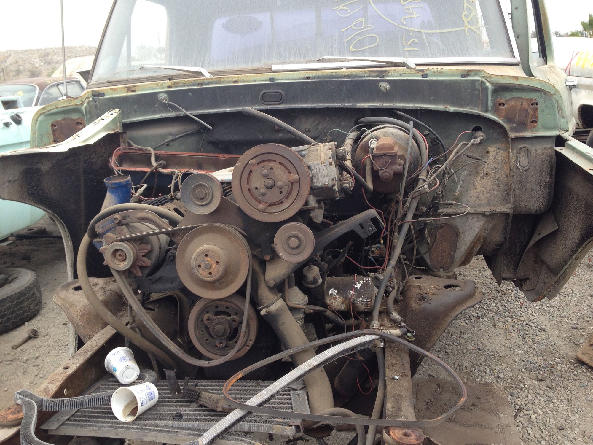

The above 2 photos reflect the brackets on the 2 different trucks I have seen this type of a/c bracket on. I am guessing that the item was made for Ford Dealers in the installation of the a/c

Sam. I don't think you necessarily have to find a truck with Ford dealer add on A/C to get that bracket. Any add-on A/C kits of whatever brand prolly had the same or very similar bracket used. And note, the bearing in those add on pulleys were the same as the front alternator bearing. Part number C9ZZ10094A.

I found another one today. These brackets must have been used quite a bit and appear to be very useful.
