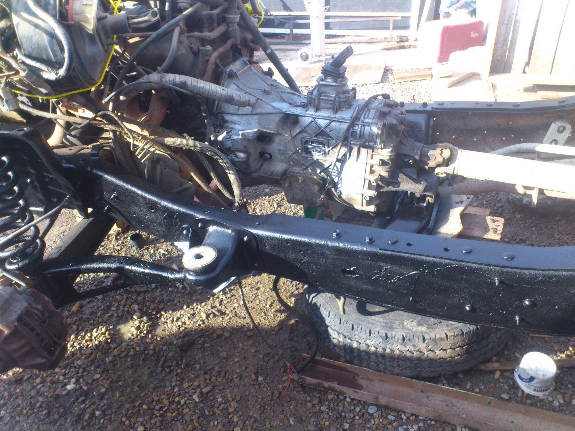

Dug through my pics and found this. Good news is it's a ZF42, bad news is it's a 89 that goes behind a 351w. These ZF's have an internal slave cylinder and are a pita, good thing it's made for the small block huh.
My 88 f450 has the 460 zf42 and it basically looks the same but has a larger bell housing due to it going behind a 460. Sorry no pics of it. Company I used to work for had a 87 f350 4x4 with a 5 speed behind a diesel, the truck was a piece of crap due to maintenance and it was rebuilt by the owners buddy before he bought it so it may not have been original. My brother, a 35 year journeyman courtesy of Ford took a 2 minute look at the engine bay and wouldn't touch the truck as it was that bad a piece of crap. The ideal zf is the zf47 behind the 460 from 92 to 96. If the trans is behind a modular motor, a v10 or is newer than 97 I doubt if it is of any value to you due to the bell housing. There is supposed to be an adapter that will mate the 97 up diesel zf but you've got to be really serious about what your building to justify the expense. Hope this helped, try looking up specs on a 87 F350 and you may find your answer for sure.
Look for a small master cylinder beside your regular master cylinder and that will tell you if you have the hydraulic clutch
