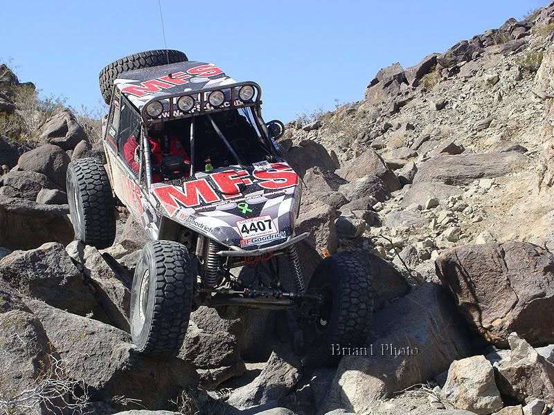

ARB's use compressed air to actuate. the small blue hose coming out of the top of the diff is air line. the setup uses a small compressor and electric solenoids.
ARB's are solid and proven design. We have been using them in Rock crawling for years and they get abused way more in a day then your Ex will ever dish out in a lifetime.
40" tires and 500 hp and they live just fine. ( the ford 9" model has a weakness due more to the axle design )
