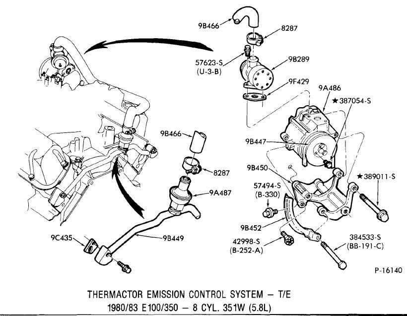

Do you have the thermactor/AIR system hoses? Another guy on here is looking for them. And several other emissions pieces.

I should have . I think I boxed them all up yesterday. However there was a pipe on the back of the motor (sort of in the center coming up) that looked to be rusted to pieces.
Show me some pics if you can and I will see what is in still in good shape.

Here's the Thermactor system. And, the pipe across the back does get badly rusted due to the exhaust that tends to get in it. Anyway, a guy from Germany that's here in the States is building up a truck to take back w/him. It'll go from wherever he is to New York State next, and he thinks he'll need the Thermactor system to pass emissions in both NY as well as Germany. Plus, he's looking for other parts you may have, on this thread.

I should have all of that. I don't think I cut any of the hoses other than a couple of vacuum lines.I will post on the thread.
