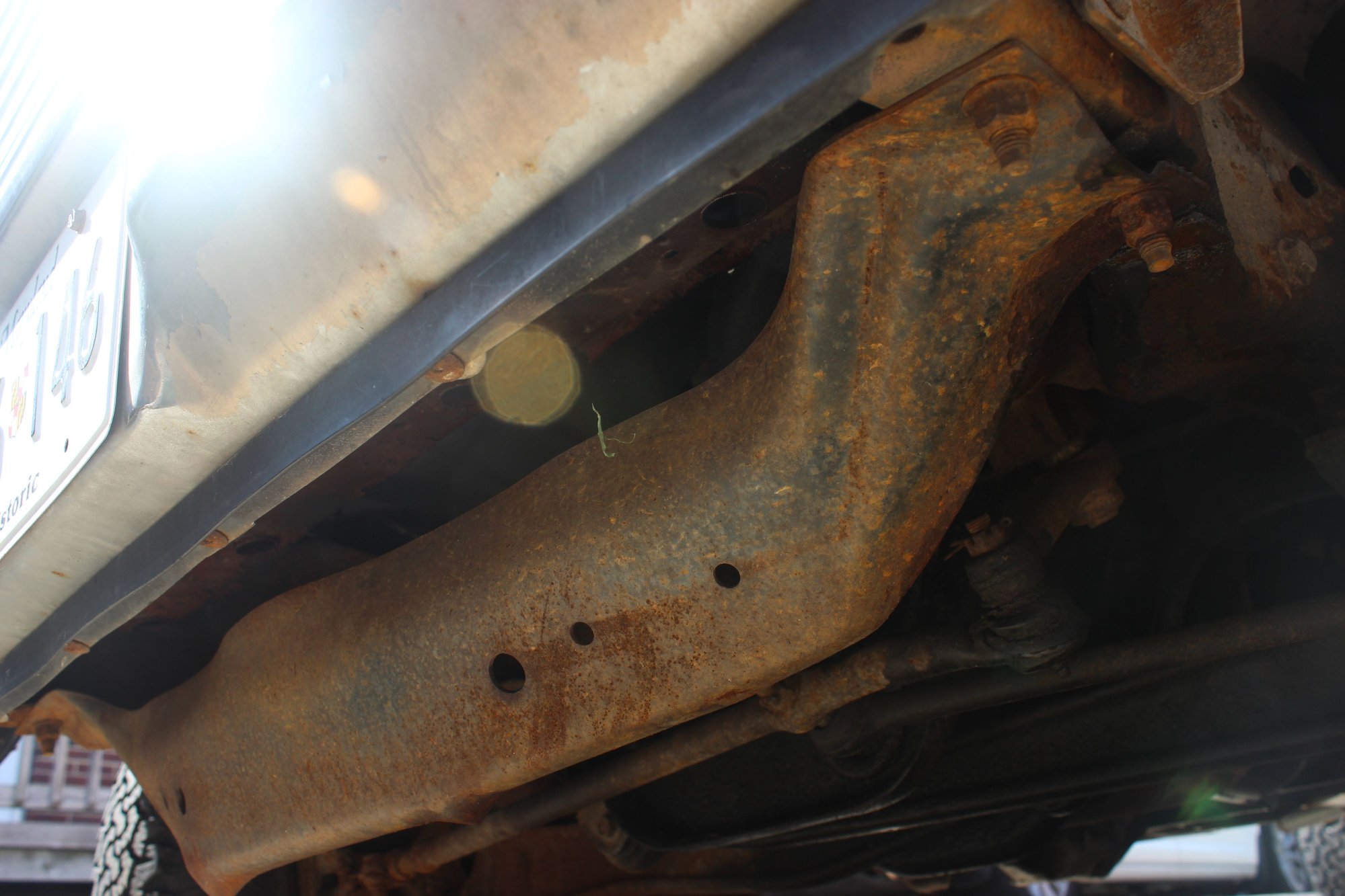

I have an 86 F150 and it looks like someone tried to tow it from the front and bent the crossmember thats located under the radiator. It's not the radiator support, it's the one below it that bolts to each side of the frame with 2 big *** bolts on each side. i'm trying to search junk yards for a replacement. What exactly is this part called? Anybody junking one out? Thanks, Keith

Thanks for the replies. It does look like 5C128 but there isn't a sway bar and there doesn't appear to be any place to mount one. There isn't a mounting tab on the passenger side like in the diagram and I don't see where it would mount on the drivers side. Attached some pictures.

For how the sway bar mounts, there's two brackets (5D485) that bolt on with the two smaller holes on each side of the cross member. I'm not sure why they even put that cross member on trucks that didn't come with a sway bar...unless it's also used a guard for the steering linkages. You should be able to pick up a used one for under $20.

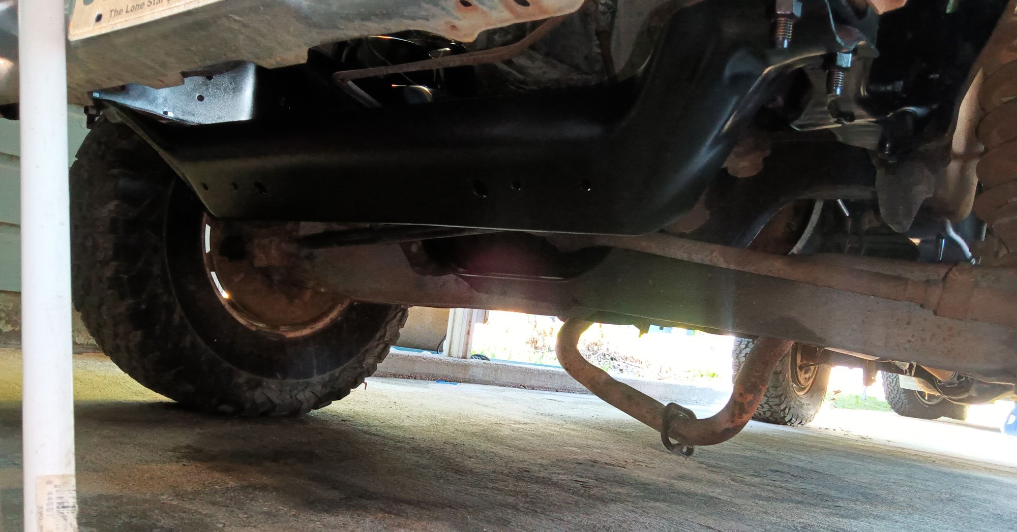

I dont know if anyone has come up with a name for it but I can tell you 99% of them will be bent.
I have 2 81 F100's and both were bent. I took the better one and hammered it straight to use in my rebuild.
Only difference between the sway bar and non-sway bad ones that I know of are the holes for the sway bar brackets and you can drill them if you need to.

Ford doesnt have a name for it besides "Front Crossmember".
I havent seen many of them bent how ever. Mine isnt bent and the '82 F150 work truck I did a 5.0 coyote swap on at work some 12 years ago now wasnt bent either.

Mines not bent, I also havent seen one bent at work but I havent seen but probably six 80-86 trucks in a span of 10 years at work and I didnt see under all of them. Only thing Im on the fence on is attachment of the tow hooks that was on the 4x4 trucks. I see no way of mounting it until I get the hooks so I can see which holes its supposed to use.
