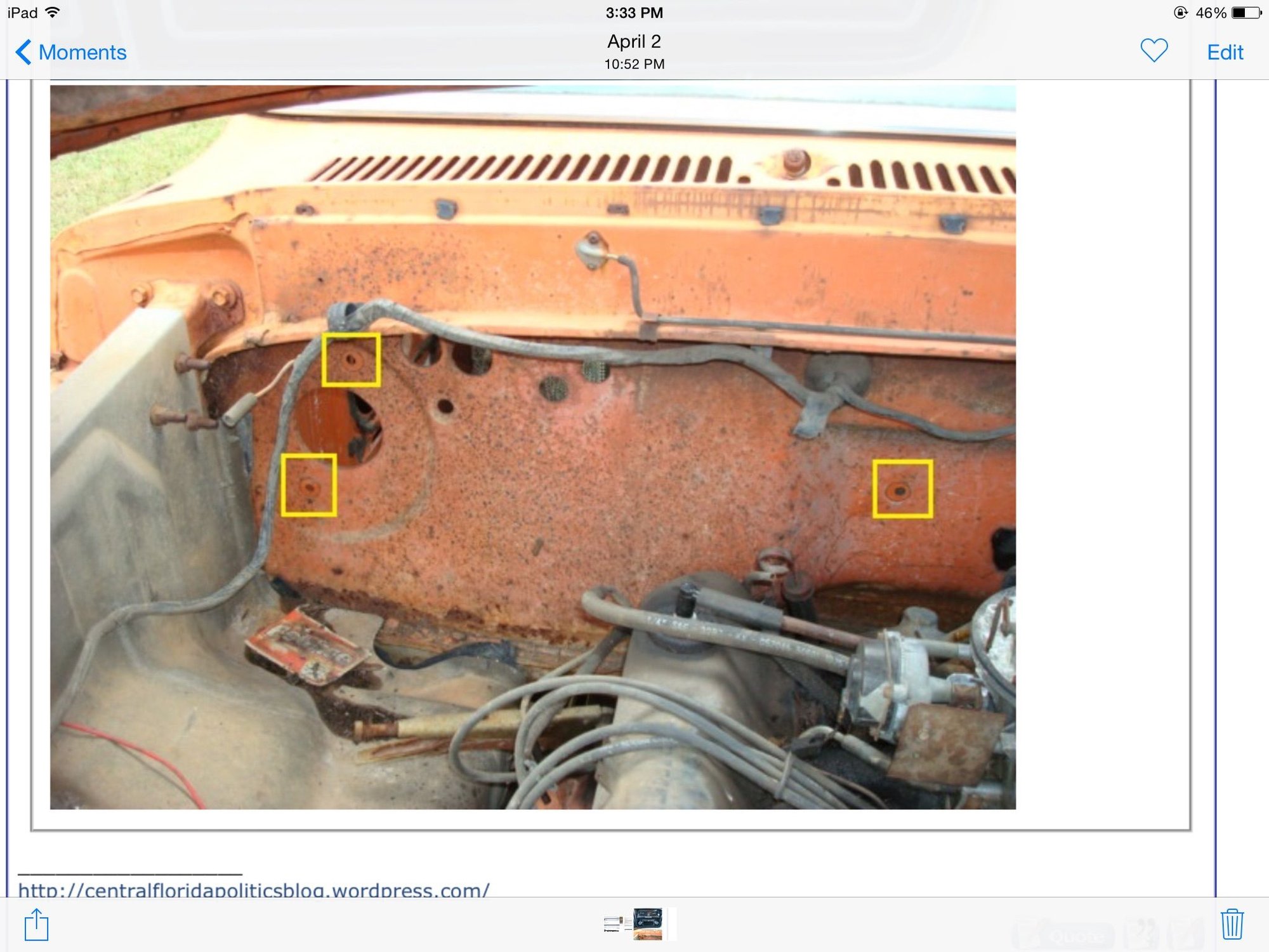

I just replaced the pass side firewall for an ac to non ac heater box conversion. Their are a couple good posts on this topic

When doing a ac to non ac conversion you have to plug the hole in firewall. The heater box has two mounting screws that fall within this hole. If you don't line everything up to the mm the box will not fit.
The solution is to find a doner truck without ac.
You cut the firewall out right at the lip.
The lip of your truck then guides the replacement firewall into the correct position up down side to side.
The doner I used had no engine so took half hr to cut out using a cutting wheel.
Used body caulk between old n new firewall to seal.
Then just used rivets to hold in place
