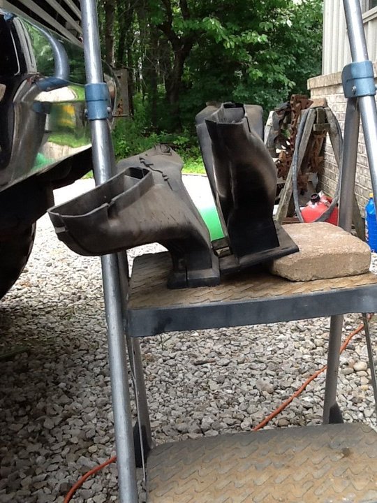

3- I pulled the defrost duct out of bronco, but the existing duct looks 95% same. The only difference is two tabs that the bronc duct has to align with heater box. Do I need to pull the duct?

Well the ducts are for sure different. Ac duct on left has more of an offset

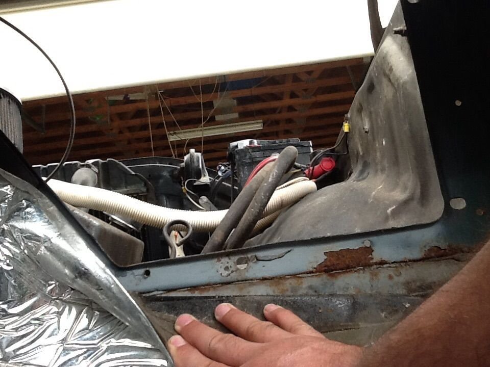

Here is the lip that other posts say I do not need to remove

Update...the heater box from bronco is in, but the lip on pass size wall is keeping the box from sitting flush. The back of box sits right on the lip. Only problem I see is that this may not be water right with gasket around fan motor.

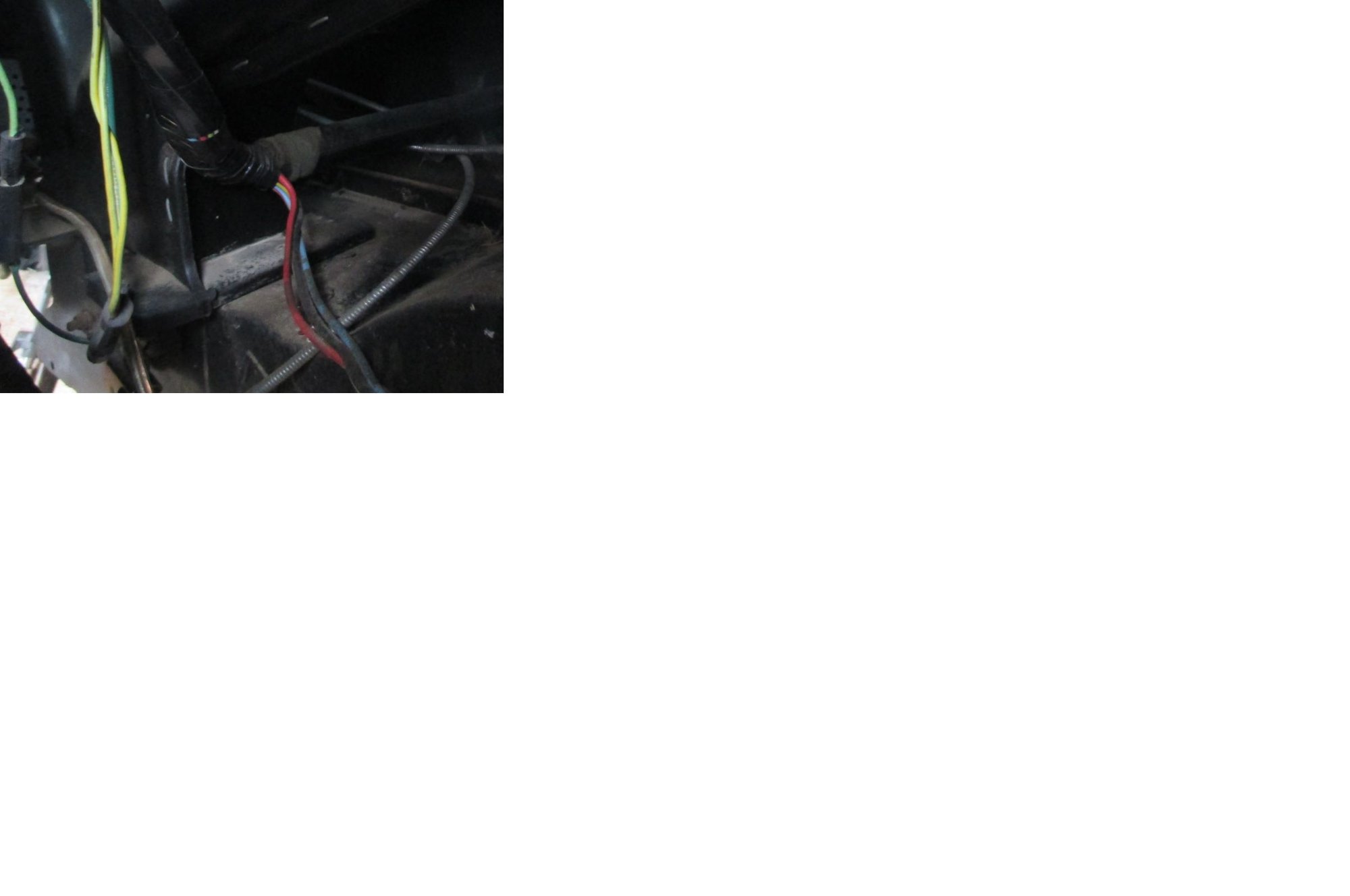

Does anyone know if I can get the female connector on the wire harness side that powers theheater fan. The plastic shell on mine is bad.

1. I would of cut the lip off, that way the 79 bronco firewall piece would be flush and water proof.

I need an actual pic of the bad female connector, I have a few parts trucks.

i prolly would try cutting a relief cut in the corners of that lip and go around and bend it flat vise grip. that way it could be bent back. and easier too.

Opps forgot the defrost duct....it looks like even though they are the same at the top, look at how the bottom part comes further back, maybe due to the a/c box being bigger?
Also look at the bottom connecting areas one slips over something, and the other one looks like it has a flat plate?

1) I thought the idea to cut a relief in corners and bend the lip straight makes sence to avoid leaking. I only had to cut this relief in one location upper right when looking from inside. I was then able to bend 2-3 inches of the top lip and 8-10 inches of right side lip flat. So far things fit much better. I still need to resolve how to attach the new plate to the firewall along this 13" edge, as any screw would drive dirrectly into the box.

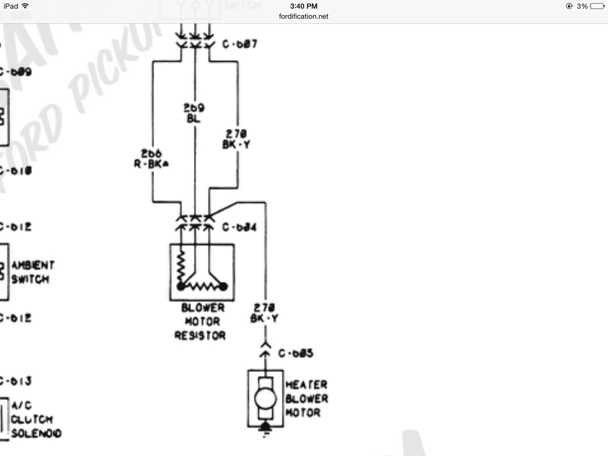

2) I have no tbeen able to find a picture that is close up of the blower mottor connector. It is single terminal wire (blk w wht stipe) and comes out of the wire harness just 6 inches form blower, back left of engine compartment.
