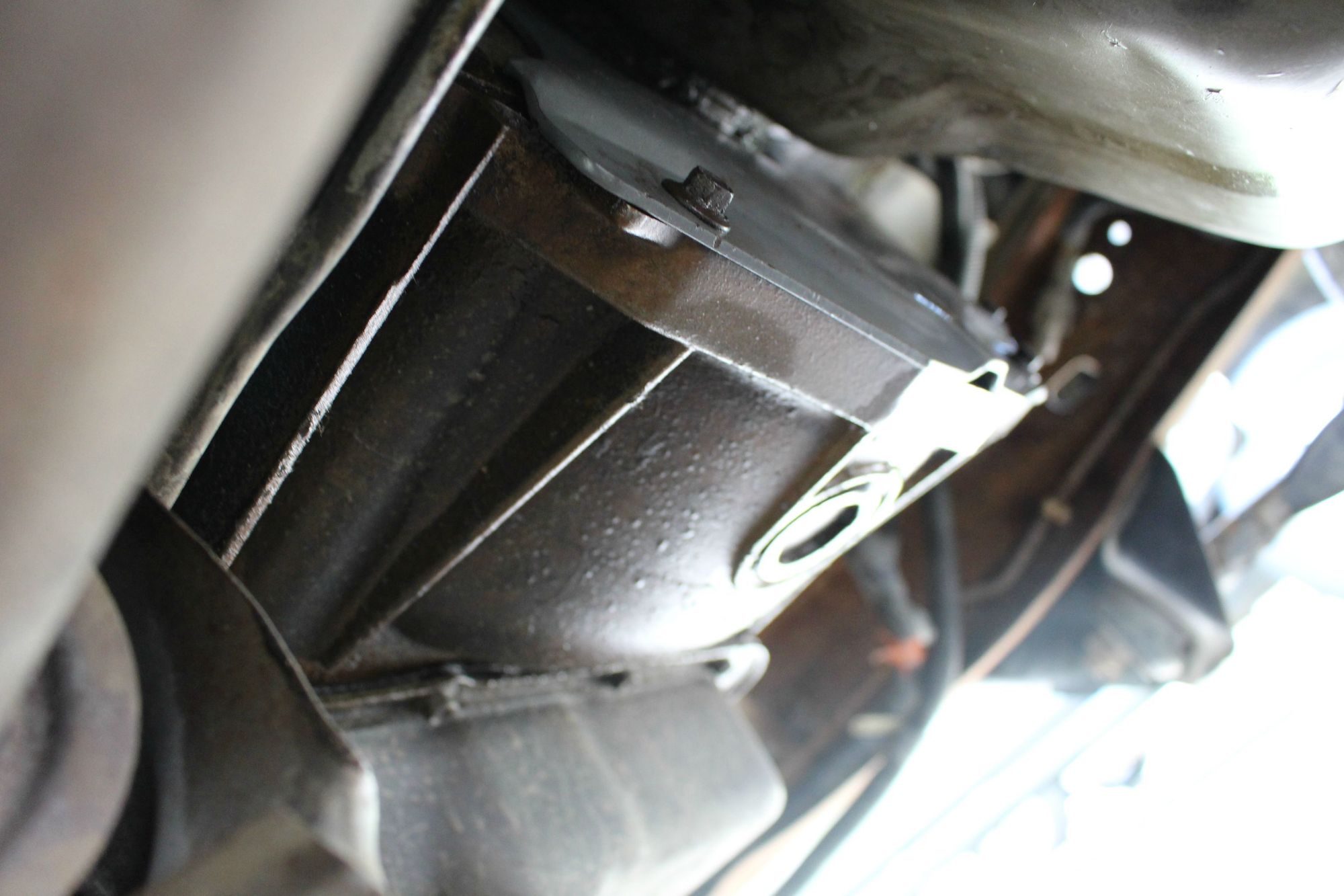

Originally put this in the towing forum and wanted to put it here to see what I could get for information to prepare this thing for quite possibly one of the longest towing jobs it has performed in its life.
So i now have a 1995 F150 XL with the 300 I6 and E4OD pushing 170k miles on the odo. she runs good. have replaced:
plugs
wires
cap/rotor
valve cover gasket
oil pan gasket
motor mounts
Things I have parts for and will be changing this weekend:
transmission mount
brakes
wheel bearings
rotors
Is there anything else i should be looking for? The E4OD has a significant leak coming from the torque converter cover but man i just dont want to mess with it and lose my transmission halfway through the haul. I am towing 1500 miles and have never towed this distance with such an older vehicle. Really worried about going through the mountains especially. It will be pulling no more than 4000 lbs not including its own weight.This move is last second and just purchased this truck back in April. Any advice would be appreciated. This will be a one time deal. Here are some pictures of the E4OD:

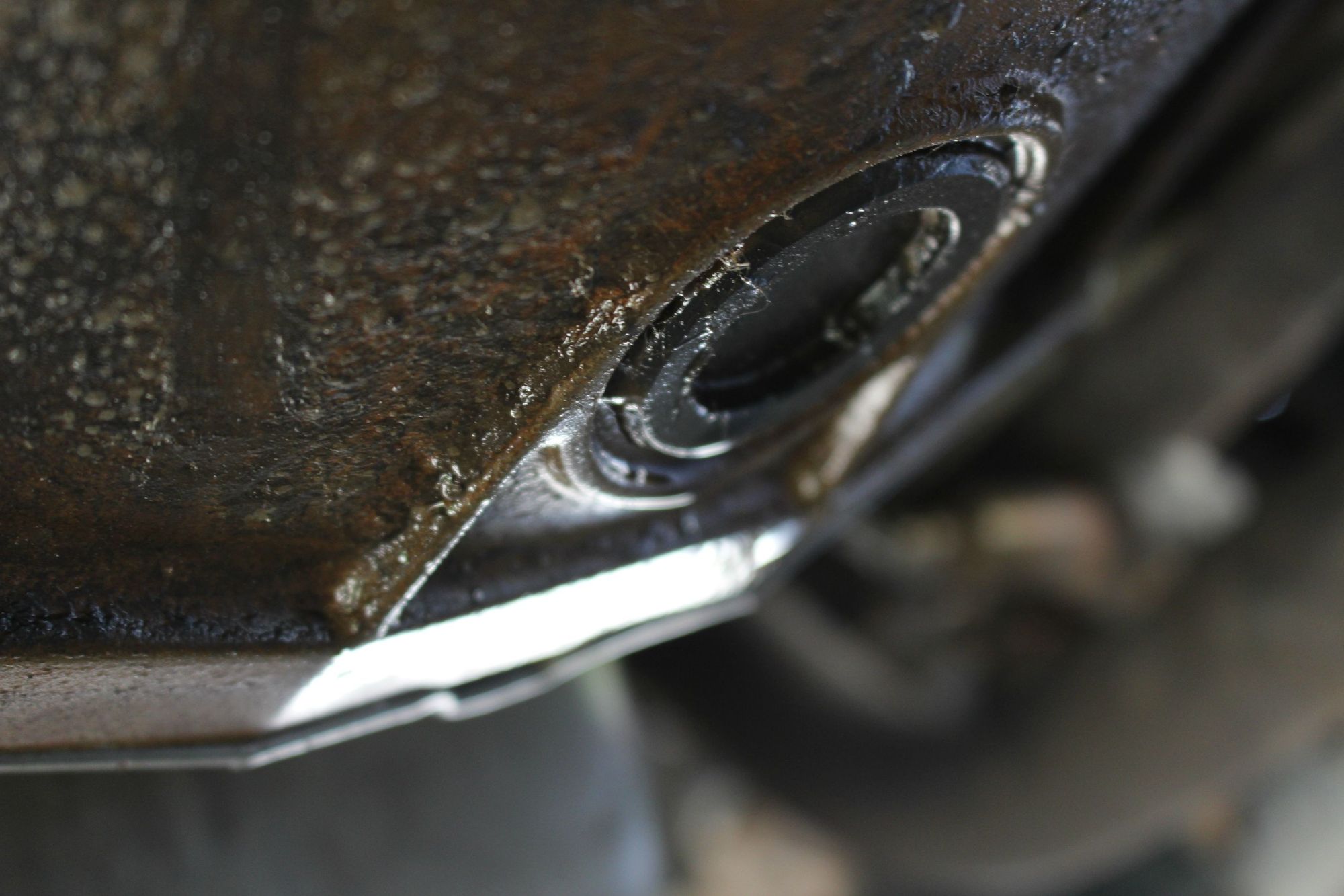

Definitely looking at the transmission cooler for sure. Read that everywhere should be upgraded. I definitely am not thinking it is the front pump seal now with further inspection. Really hard to tell considering it has been bathing in oil from the leaky engine oil pan gasket. But when i stick my finger in the dust cover of the torque converter drain bolt, it isn't red like ATF. It is black grime and oily. The transmission pan is more likely in my opinion now. the shift linkage has bright red ATF on it as well as the rear of the transmission. She shift fine and no slippage either.

Took the truck to a transmission shop and they said front pump seal is fine. However, my trans pan is shot and bent to hell/warped. They recommended I replace it.
My fun filled weekend to come.
