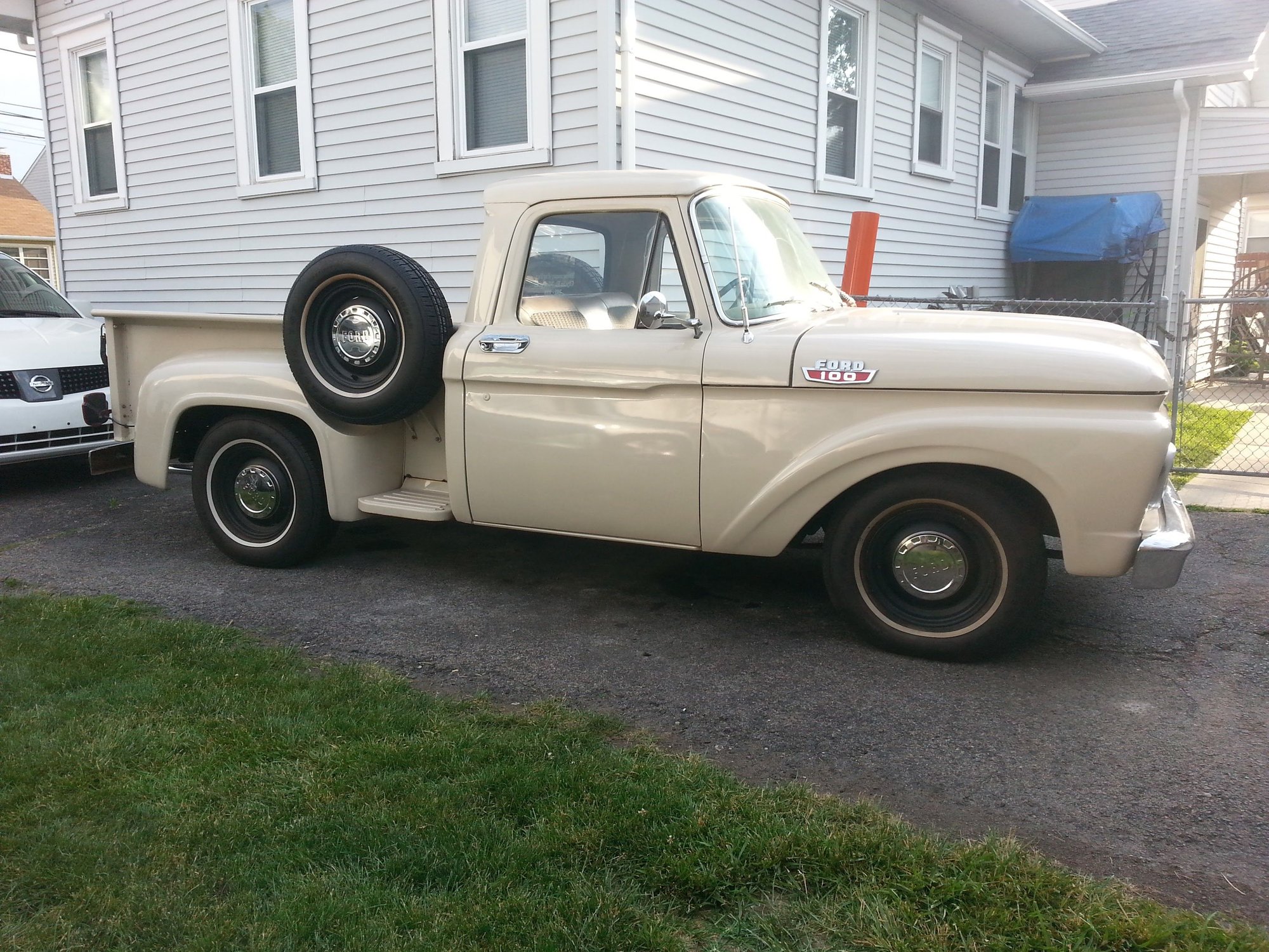

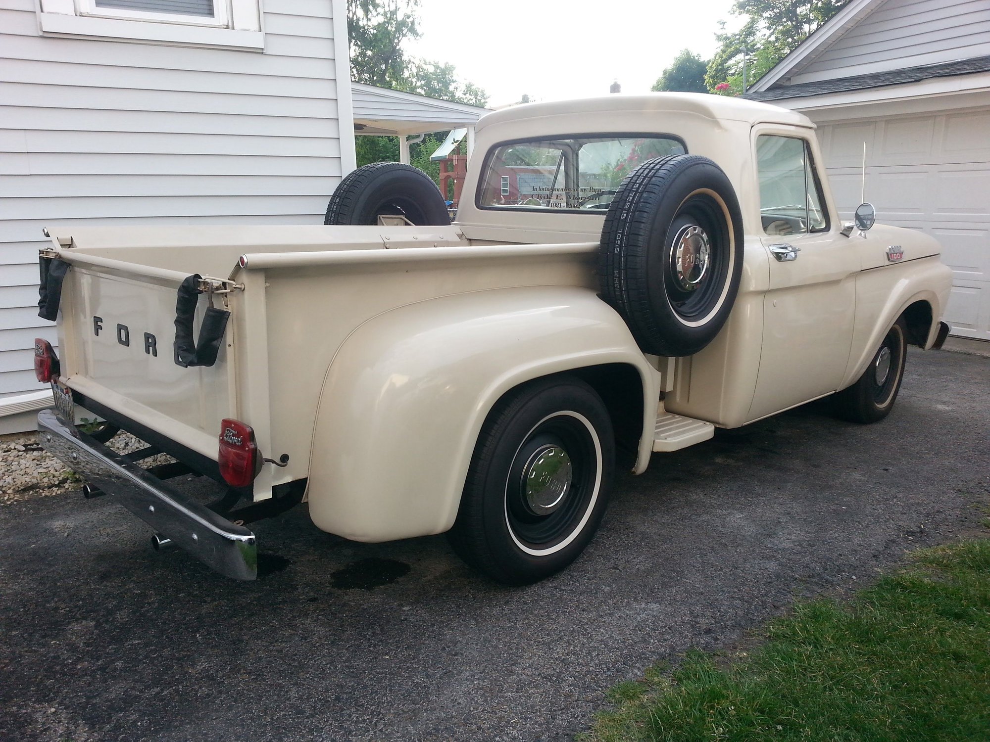

I know this an old post but I just did the HAMB leaf flip. The steering isn't too bad but the steering wheel is off so the toe needs to be realigned. I kinda want the rear an inch higher. I might redo the rear and take the next longer leaf and flip. It seems to be about 3 inches. I am measuring 29.5 from ground to fender, it is about an inch wheel gap from top of my 235/75r15 tires.
My driveway is kinda angled away from my house, this might not be a hundred percent but here is the finished product.
I was thinking of just buying an inch block to add in but then I would need longer U bolts. It wasn't too bad a job to do again... I guess. For now I am not touching it. Just need new shocks, mine are wooped. Thanks again to all of yalls with my project.
