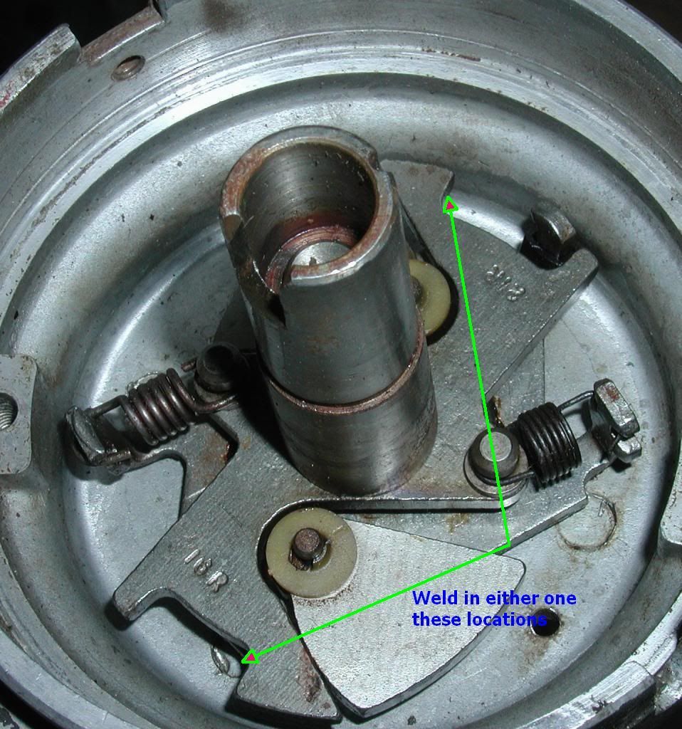

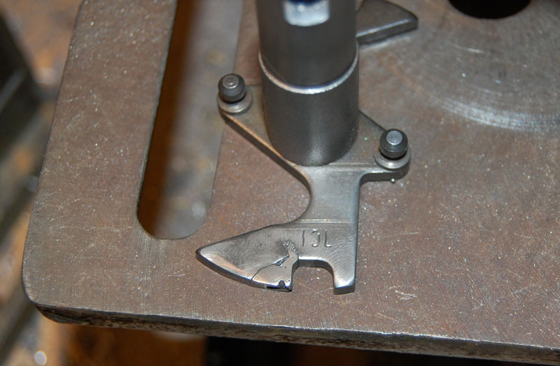

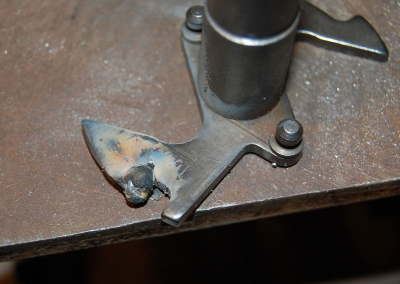

so if put stiffer springs and weld the slots smaller on the plates that should work.
i think i will try it myself after all that how we learn.
if i weld 1/4 of the slot will be enough you think ? thanks
These are your slot widths .. I would start with 10L = .410"
8L slot = 16 degrees centrifugal advance = .358"
9L slot = 18 degrees centrifugal advance = .384"
10L slot = 20 degrees centrifugal advance=.410"
11L slot = 22 degrees centrifugal advance = .436"
12L slot = 24 degrees centrifugal advance = .462"
13L slot = 26 degrees centrifugal advance = .488"
14L slot = 28 degrees centrifugal advance = .514"
