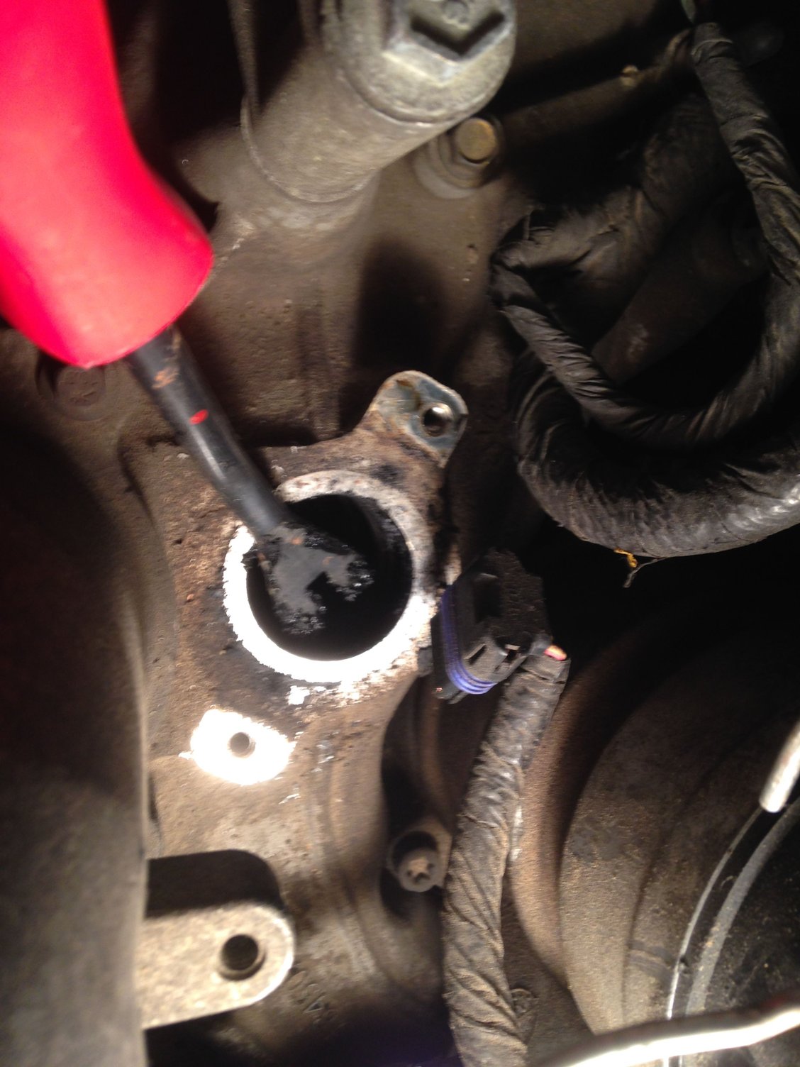

From what I understand it should be dry where the valve goes. I would call it moist not wet but fairly moist. The top groove had the most wetness, the middle groove was dry and the bottom was nearly dry. Where do I go from here - the video I watched said to scrape out and vacuum - not dry enough.
[IMG]https://cimg6.ibsrv.net/gimg/www.ford-trucks.com-vbulletin/2000x1504/80-
img_0756_9bc6c676bdc1954402132fd17d0e7e3894ed8682. jpg[/IMG]
Thanks for your help
Ted

Moisture indicates your EGR cooler is leaking and needs replaced or deleted, that is if your someplace that doesn't do engine/smog inspections.

You can get oily solids from the ccv system and even have a little un-burned fuel in the intake that does the same thing. It is different than actually having water/coolant in the intake.

So how do you know what you have?

IMO look for standing liquid (ie free liquid) after you have driven the truck, got it warm, and parked on a down-slope.

I had the same issue with my 2006, I ended up doing a egr cooler delete, while there I cleaned my valve and had the intake hot tanked at a radiator shop. Now clean as a whistle.
That stuff was like Tar in mine

So you still have your valve with no cooler? If I put in the new valve will it clear out the code? (404/405)

Do I put in the new valve for this? or does it really matter

Did you buy a ScangaugeII ?? There are several models of scangauge.
If you have liquid under the EGR valve, it is most likely an EGR cooler leak and has nothing to do with the EGR valve itself. The P0405 is an electrical code for the EGR valve and has nothing to do with the potential of an EGR cooler leak.

To do the test you described above do I use the old valve or go ahead and install the new one? Question due to the fact I will have to pull it after parking downhill.
Installing a new valve - Will that get rid of the 404/405 codes?

Leave the old EGR valve in until you have driven it and parked it in a downhill position. Pull the old valve and inspect the intake.
Install the new valve.
The P0405 is from a bad EGR valve. A new one (assuming it is working) should clear that code. It is POSSIBLE that a P0405 might come from a bad connector, so inspect that carefully.
A P0404 is a flow code and can come from several causes. That one may or may not come back - depending on whether or not you have other issues.
