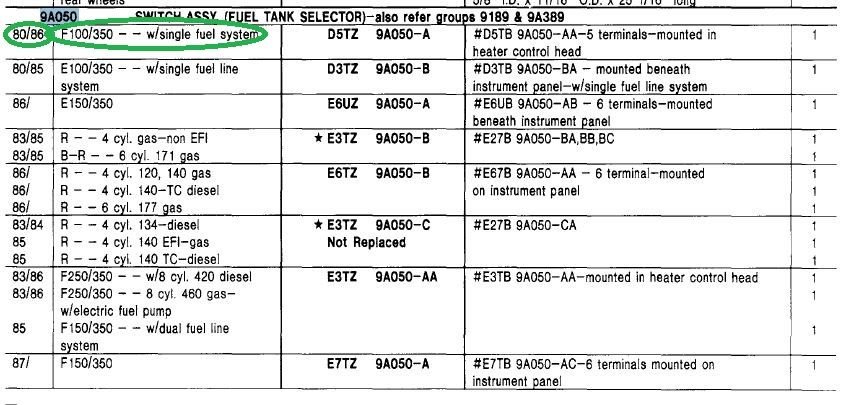

First, the page you selected is for the Bronco power rear window controls. You need Page 10 of Section 184:
Then, if you pick 14529 you find it apparently is "switch". I found dozens of hits on that number as there are switches everywhere. But, if you use 9A050 from the drawing you find the table shown below. However, there is a puzzling statement of "w/single fuel system". I'm not sure what that means but I do know there was no switch unless there were two tanks. So, presumably it means that switch wasn't used if the truck was set up for two fuels, like LPG and gasoline.

Originally Posted by nonrev321
1985 F250HD, 460 (7.5L) gas/carb. Dual tank Hot fuel configuration. Am looking for the Ford part number for the Tank Selector switch in the AC/Heat panel.
TWO different types:
D5TZ-9A050-A .. Fuel Tank Selector Switch / Marked: D5TB-9A050-AA / Available from Ford
1975/79 F100/350 / 1980/86 F100/350 with Single Fuel System.
MSRP: $37.38 / FTE Ford dealer parts dept sponsor silverstatefordparts.com online price: $23.90 / Gaudin Ford ~ Las Vegas NV
E3TZ-9A050-AA .. Fuel Tank Selector Switch-Use with Electric Fuel Pump / Marked: E3TB-9A050-AA / Available from Ford
1983/86 F250/350 6.9L Diesel & 7.5L (460) / 1985 F150/350 (gas) with Dual Fuel Line System.
MSRP: $42.27 / silverstatefordparts.com online price: $21.87.

All the OP has to do...is look at his switch...to get the ID number from it, then compare it to the two switch ID numbers I listed, then order the correct D5TZ or E3TZ switch.
Someone from this forum emailed me awhile back with a '85 F250 6.9L, gave me these switch numbers: E3TZ-9A050-AA (marked: E3TB-9A050-AA), said he couldn't find one anywhere. (sigh).
I told him: "You haven't looked everywhere, because this puppy is still available from Ford!"
