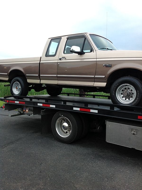

Hey everyone, I have a 1992 F150 XLT with a 5.0 and the E40D tranny. It has 144K miles on it, bought it a month or two ago. It's always shifted kinda slow, like it would take forever to shift to the next gear. It also shifted hard sometimes. I didn't think much of it, transmission fluid looked brand new. Levels were fine. I was driving to AutoZone to go pickup a rad hose, and about 200ft after the light the engine just revs up and I loose all power to the wheels, like the transmission had just disconnected into neutral. Wasn't even driving hard at all, either. I pulled it over to a parking lot and got it towed home. Disappointing. Anyways, what do you guys think it could be? I'm clueless, I've been reading many different topics on this but I don't think they have the same issue as me. It barely moves when you put it in any gear, but the engine just spins freely. Funny, though. I did a short hard pull a day before it broke down. Guess that finally made it go. Anyways, I really appreciate any help I can get on this. Thanks!
