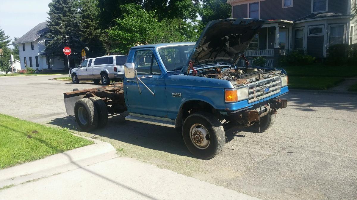

Well, I guess this is the clincher then.
I happen to have a truck I'm parting out with you guessed it, 4.10. I think it's open though. Its an 88 f-350. Bill seemed to think it should work. The axle won't obviously because it's a cab and chassis, but the guts will!
