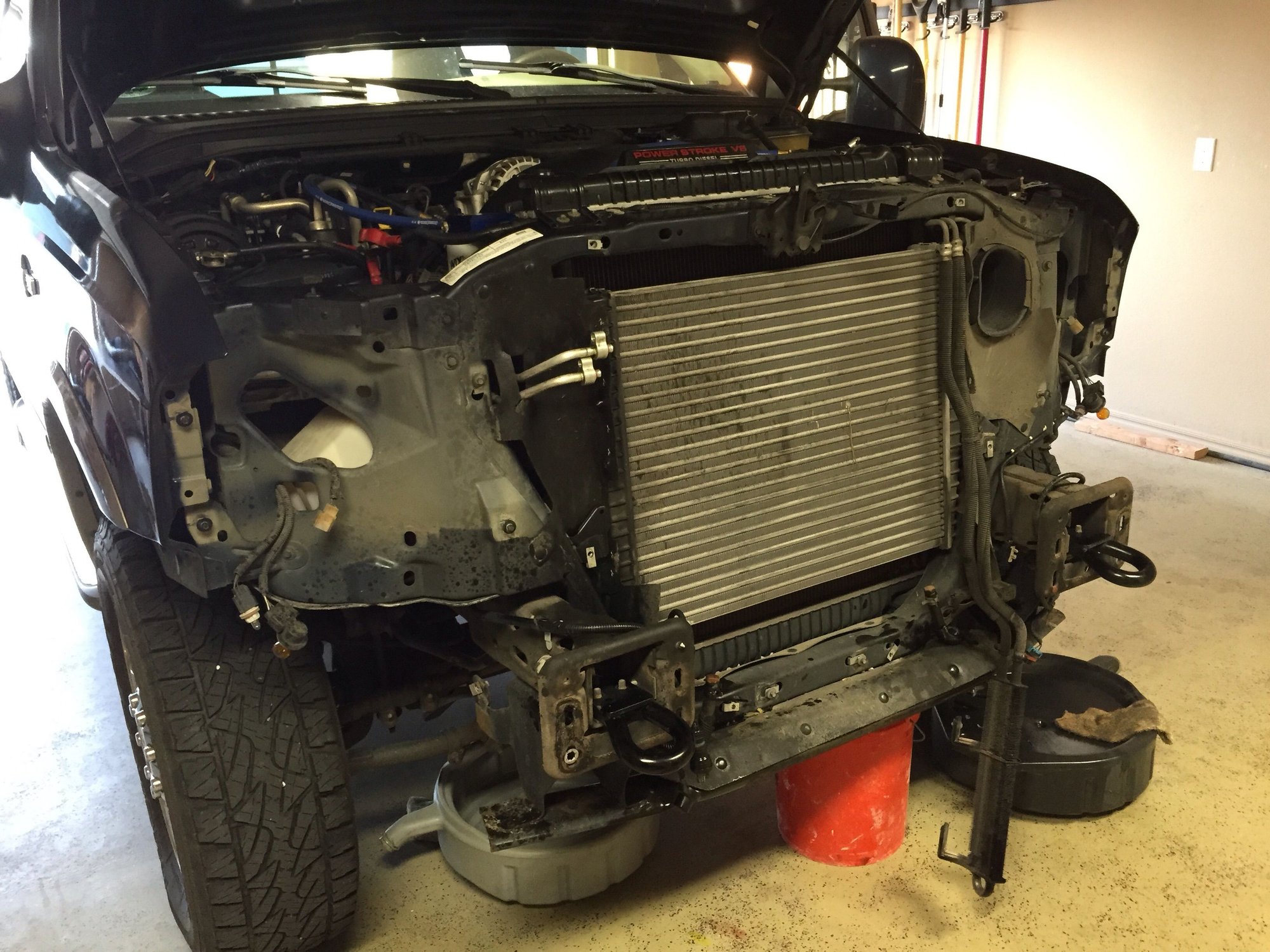

Here is where I'm at....

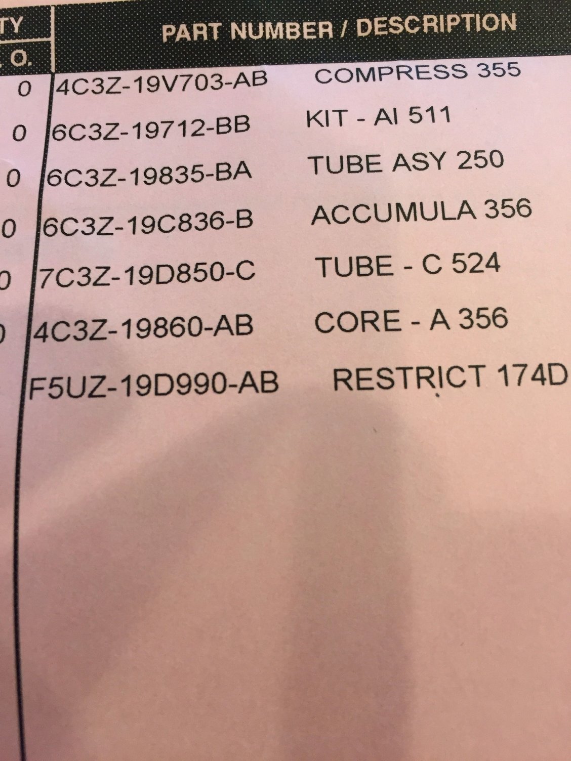

For those who like to acquire part numbers, here is my parts list.

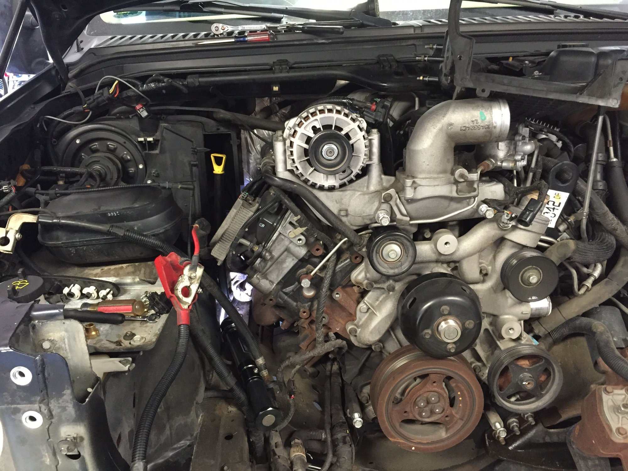

She is back together, flushing coolant now and will start vacuuming the system when I get this wrapped up.

Nice it looks like you went through the front. When I did mine I went through the passenger fender well. I've done it twice now. Looks good

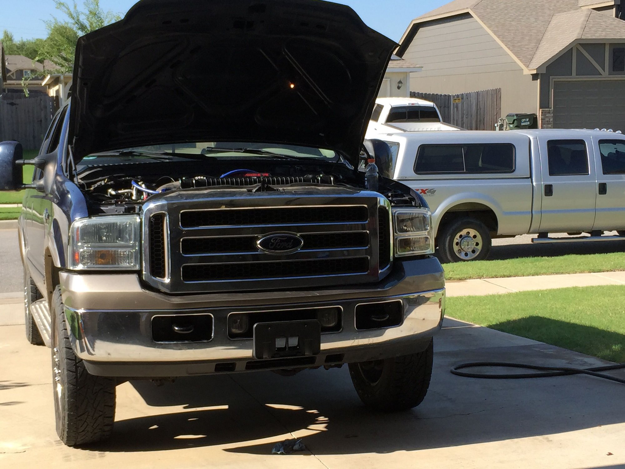

Well it's all done. After vacuuming the system it wouldn't hold vacuum! I couldn't believe it! After good cry and additional troubleshooting, I found that the manifold connectors were leaking at the quick connects. A little Teflon tape on he connectors and it holds vacuum!! . 55° on a 100° day isn't too bad!
I will work on pictures later this evening but I have to say that going through the front made it very easy, plus I took advantage of it being open and installed the new belt.
