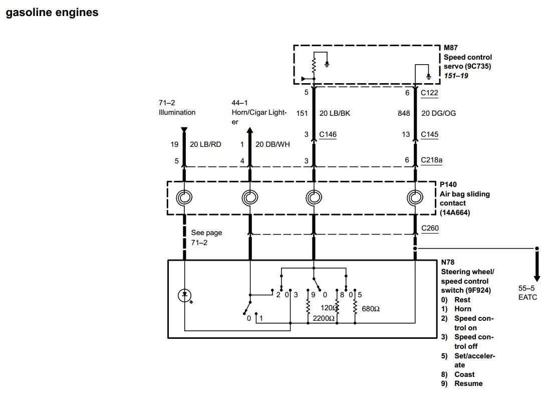

cr295, you did not say if you had wiring diagrams or not.
I don't have the 99, but I do have the 2001 schematics and I have included the two that pertain. Maybe they are basically the same.
Since all the cruise switches go thru the same clockspring, it should be easy to tell if they are working by metering.
I would first check all the signals that go into making sure the servo control module has what it needs, +12V and grounds, then go from there. Note that +12V is also needed thru that brake pressure switch to make it work. If all the signals into it seem correct to make it go, then maybe the electronic part of the module is bad.
Good luck on troubleshooting, Tom

Thanks guys. I'll keep digging with the meter. Thank you for the diagram mtnbikr, I'll let you know if it matches up to the 99.
