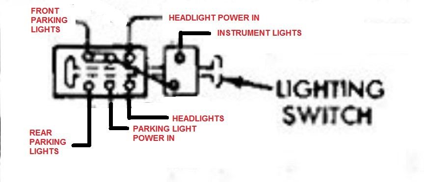

Here's my current wiring configuration on the switch....
Red wire is headlight switch power, the two black wires are park lamps, and the blue is the dimmer power.

Your connections appear to match the chart below
edit: except you have Headlight Power (red) going to parking light power In on the switch. The stock harness has separate power sources for Headlights and Parking.
