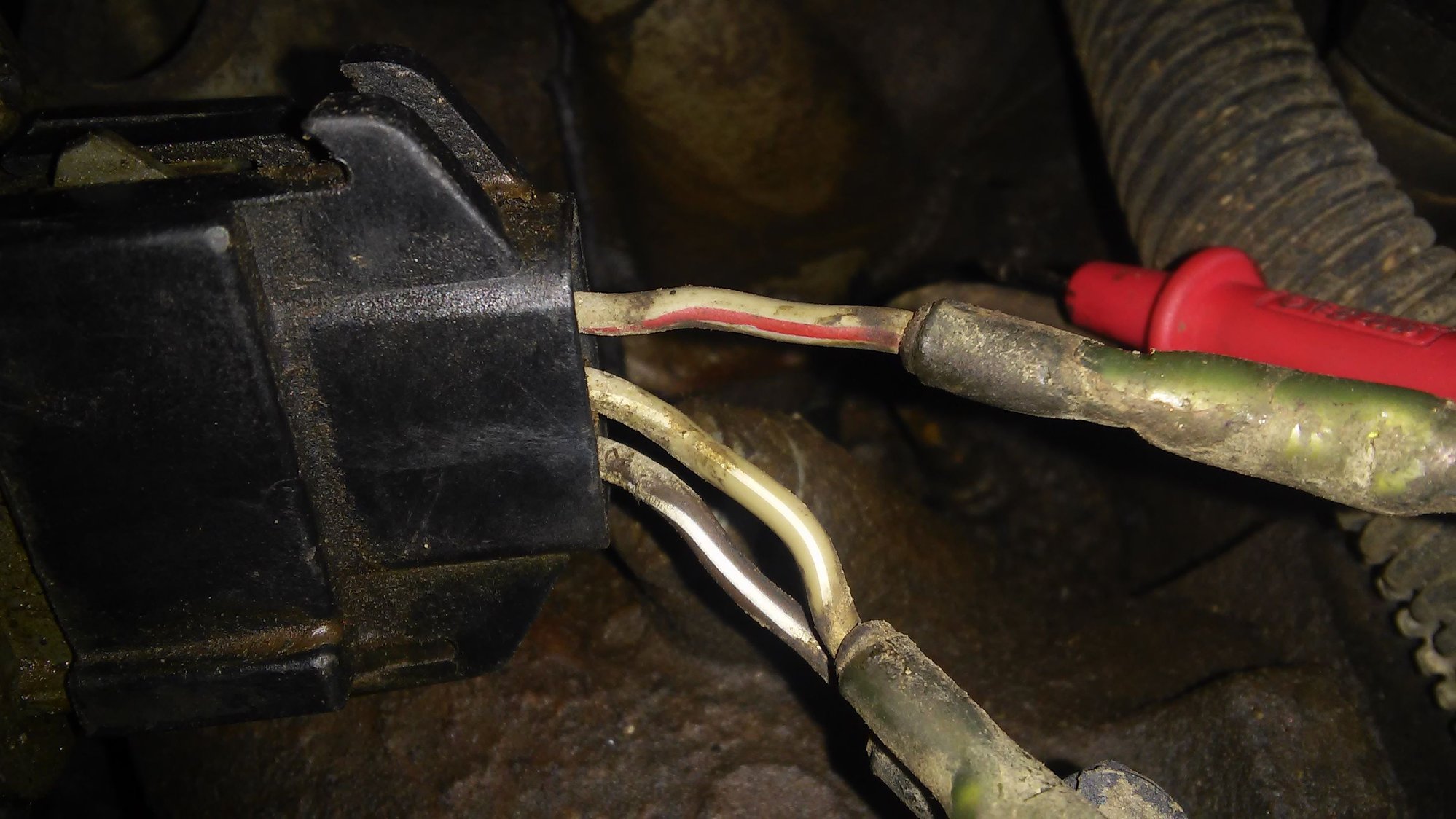

I did/ try the voltage on my fipl. Sensor. When hooked up to the fipl. My bottom wire (b&w) is appx. 5v. Middle wire (gry &w) is .35v from idle to 1.53-1.61v full open. Top(r&w) is gnd. Would this result in the bad fipl or am I doing.something.wrong??

well that will be causing the od light to flash.that's way off.did you try adjusting the tps to get closer to 1.2V idle to 4V WOT? if so,what happens?
looks like someone replaced the connector to it.though this is more than likely the issue at hand as described by your symptoms and the tps voltage settings,you still wont know if this is the only issue without repairing the connector for the scanner port.
did you replace the TPS yet? there's no point in screwing around with one with over 50k miles so do that.

The crappy looking connector could cause this? I got the tps today and changed it. Same voltage and when I turn the adjuster all the way up I only get .73v. I got a obd connector and found the wires for it, hooked it up, and hooked it up to a reader and still was not able to get any codes. I don't know if I was checking the ecu return wire correctly, or not. But I put the neg on the return wire and pos on the 5v wire and I got 1.2v
