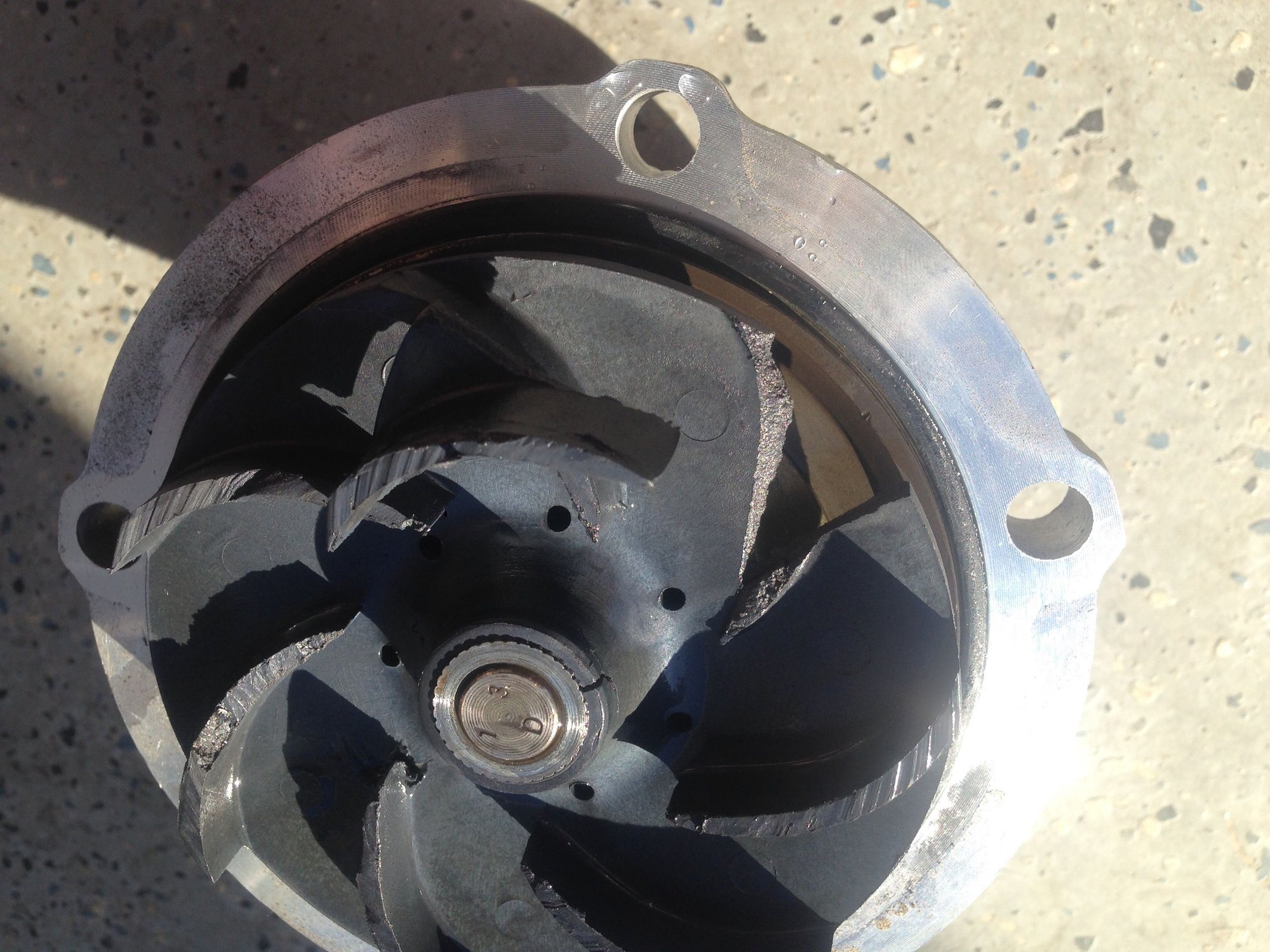

So any other ideas for me to check before I tear the stupid pump off? The radiator is not blocked with debris. I assume that since the oil temp and the coolant temp both rise to high levels the sender is OK. All hoses, belts, tensioner, idlers etc are new less than 10,000 miles ago.
Just be sure to check the front cover for cavitation inside the water pump housing section while you have the pump out. Other than that, not much left but swapping the sensors (water and oil are identical), and they seem to move consistently together.

Well it was a bad water pump. Just like someone here said early on the impeller cracked and spun on the pump shaft. Thanks a lot for the quality part NAPA. I put a new OEM pump in today, hopefully it lasts.
Lasted about 10,000 miles.
