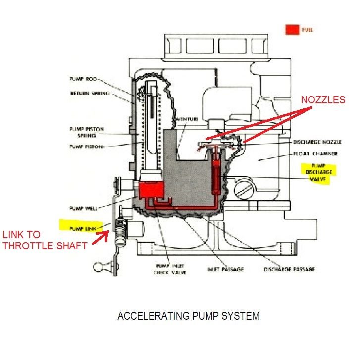

It sounds like your accelerator pump isn't working. See below. The link from the throttle shaft to the accel pump shaft can come out of the holes in the throttle shaft, disabling it. There are 3 positions, the middle one would be the best for now.
Look down the throat of the carb, and operate the throttle. As soon as you move the throttle, you should see gas shooting out of two nozzles. If there is a delay, or no gas squirting, the accel pump isn't working or the nozzles are clogged.

Well I checked on that linkage and all appears to be acting normal. I went to go drive it today, let it warm up and pushed the choke in. Made it down and road and when I stopped at the stop sign it stalled. I was able to get it restarted after about a minute and was able to operate the truck normally, but with a little bit of choke during the duration of my trip. I got to my destination and left the truck running, pushed the choke back in and it purred like a kitten and ran fine the rest of my trip. I am stumped.

Have you taken the carb apart? It may just need junk cleaned out of it.
Have you adjusted the idle mixture screws?
