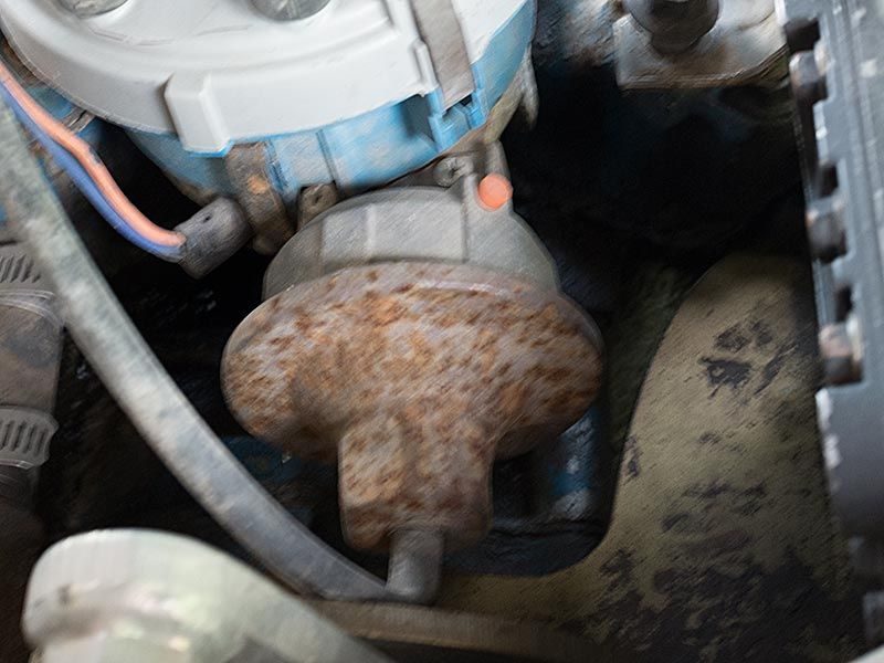

I was freshening up my vacuum hoses and noticed the vacuum advance connector butts right up against the a/c bracket. Is this common? The tube has to be bent to the point of pinching. The one that was on there had thinner walls and was more pliable (where it wasn't heat hardened), but the one I replaced it with has a thicker O.D. and much stiffer
I didn't have a chance to take any vacuum readings. I was home on leave for a short while and had a million things to do. It starts, idles and drives fine in park, but it does idle rougher when warm and in gear.
Sorry for the crap phone pic.

Is your distributor rotated to the proper timing position? The may have made a 90 degree vac line fitting for that spot due to the low clearance.

You might get some relief by moving the distributor over one tooth, but it looks pretty tight in there.

That's not good. Some kind of L fitting might be a workaround but the question would be what caused the issue to begin with. Was a different distributor installed at some point, or was it stabbed incorrectly.

dogman, here's a pic of my 460. My vac line has a bend on the end but I can't tell if it came that way or just formed because of age. It's hard to tell in your close-up photo but it looks like your dizzy may be retarded by a tooth

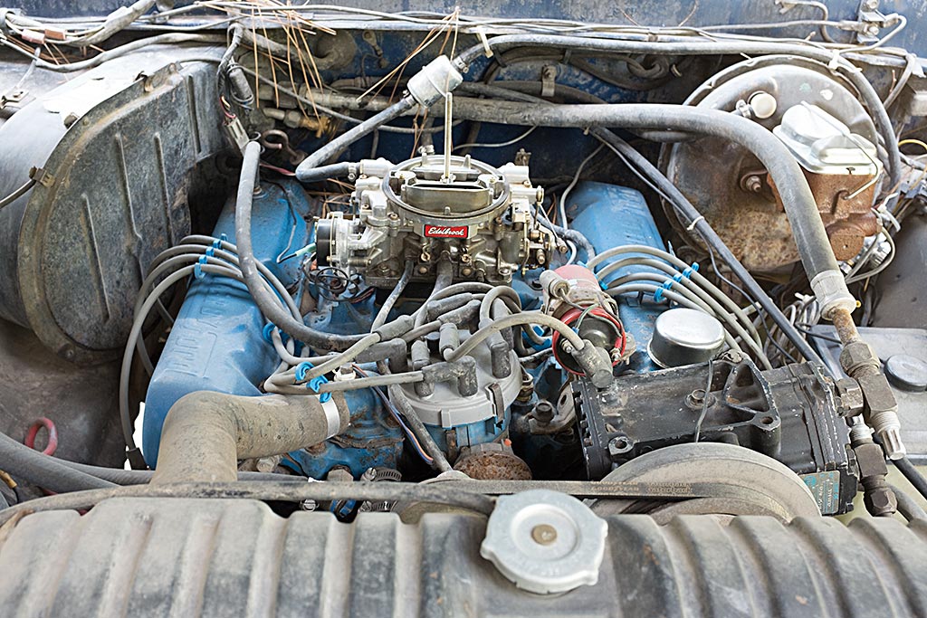

Although the 460 is a transplant (original 400 motor), I am assuming it is a factory a/c set up that came off the donor vehicle. The truck interior is set up for factory air - it has the vents and the controller with the slider has a position for a/c.
Thanks for the picture - very helpful. I will have my wife try to get a better shot for me to post that is clear and shows more of the area.
This is the best engine shot I have, but it doesn't show the bracket and vacuum advance.

But it does show you vac advance pointing in a different direction than fuzzybob's. You should try pulling the distributor and moving it over a tooth or two.

It may be possible for the timing to be at specification, but it's the housing that is off (and why they are suggesting reinstallation to get everything according to Hoyle.)
The rotor needs a fair amount of windage when installing to line up with #1 tower because of the helical gear. Very common mistake.

I totally agree the vacuum advance canister looks way out of position (retarded timing) but before you move it a tooth .. check the rotor position with the motor set a TDC (top dead center) to see if its proximity to the number 1 plug wire .. If you need a walk through how to do this just say so ..
