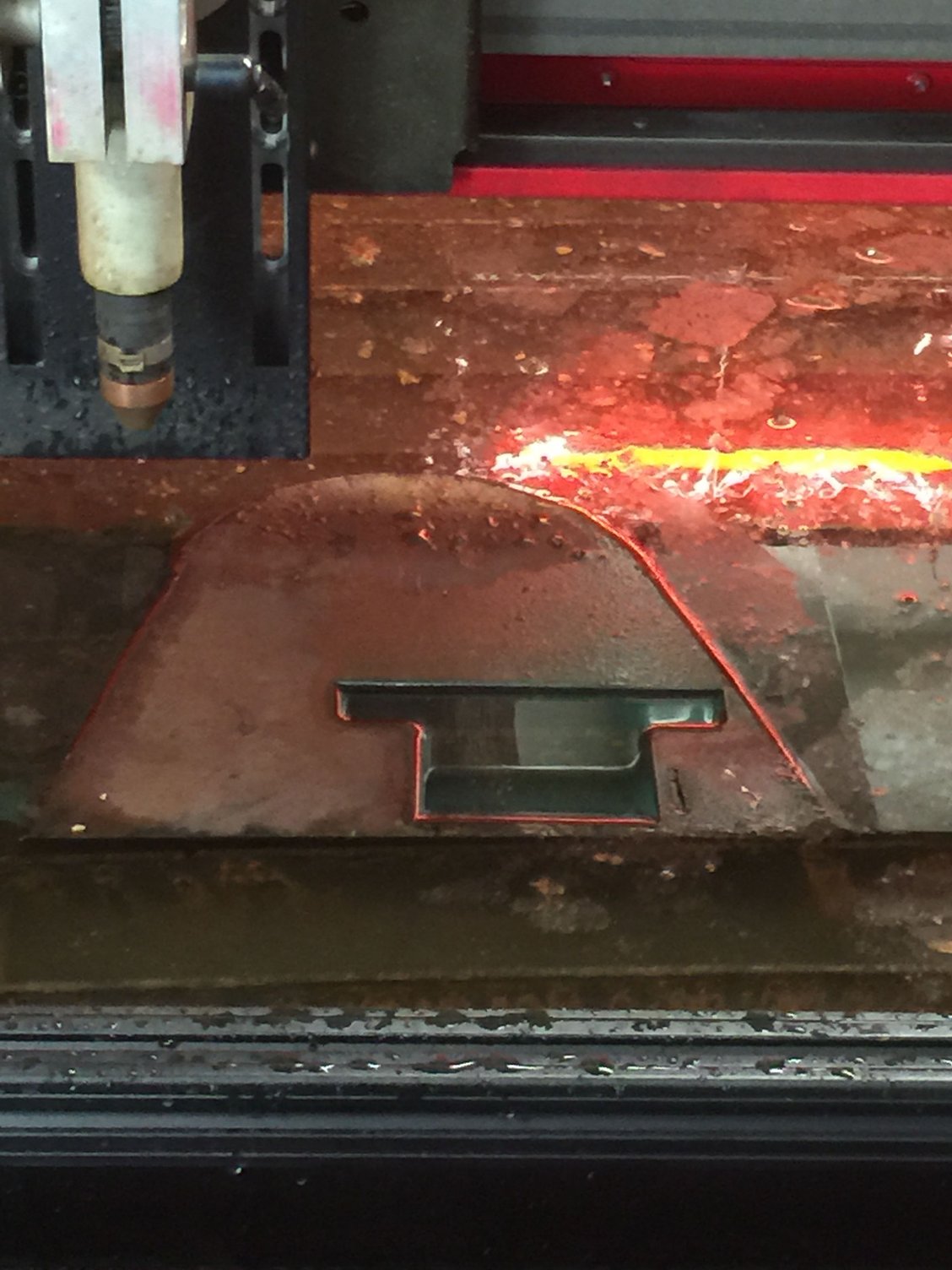

I would use a plasma cutter or bridgeport milling machine. If you don't have access to either I'm sure that there is a machine shop near Bakersfield that would do it for less than $50.
These pictures are of the plasma cutter used last week on 5/16" plate steel:
