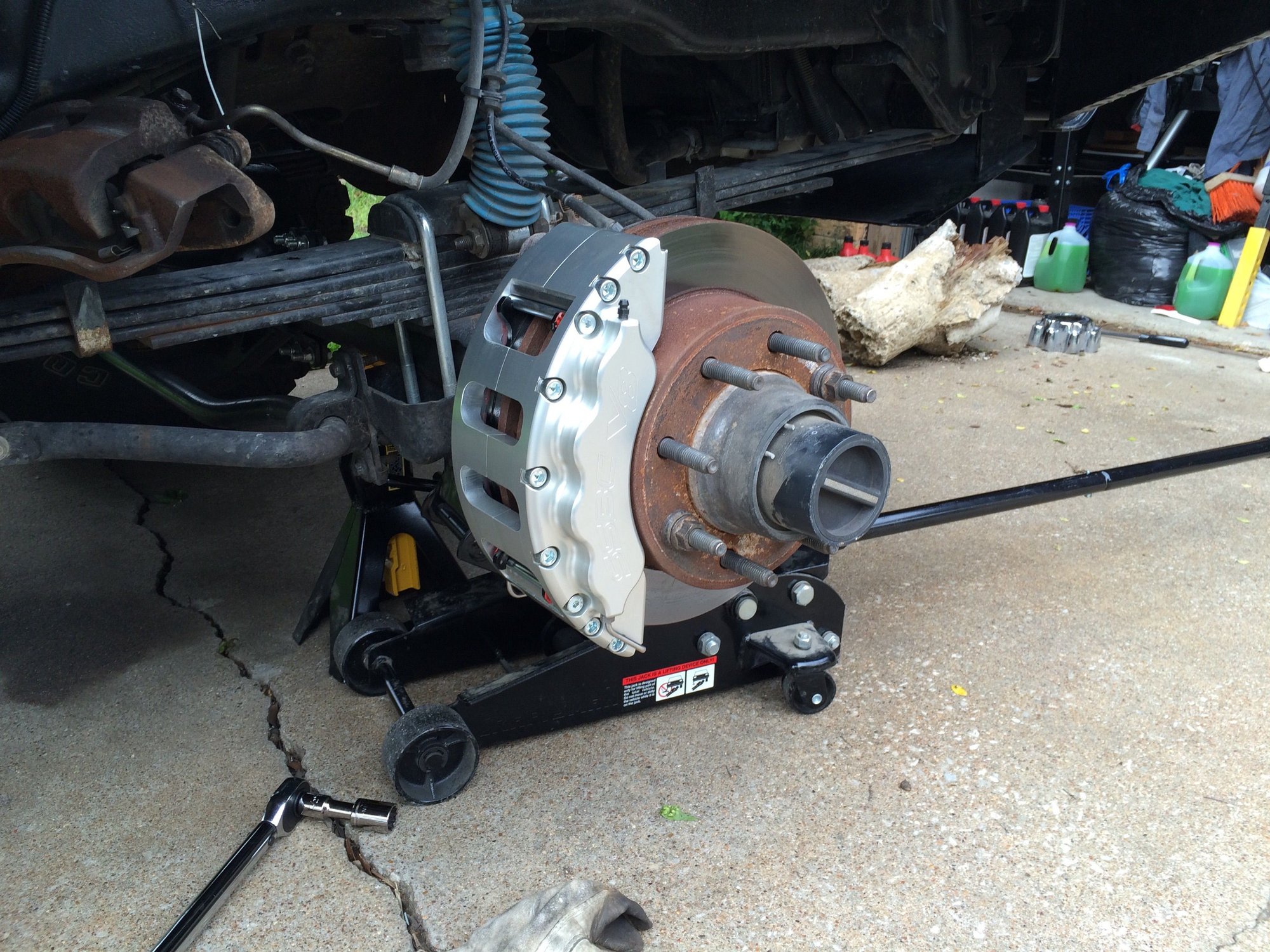

Installed mine a couple weeks ago. I was expecting drastic results like being thrown through the front windshield lol. In reality I got smoother, quicker braking and no more annoying pulsating pedal. Overall I'm pleased.

Holy cow them things are huge. I knew they were bigger, but wow.
Glad they're made of aluminum.
