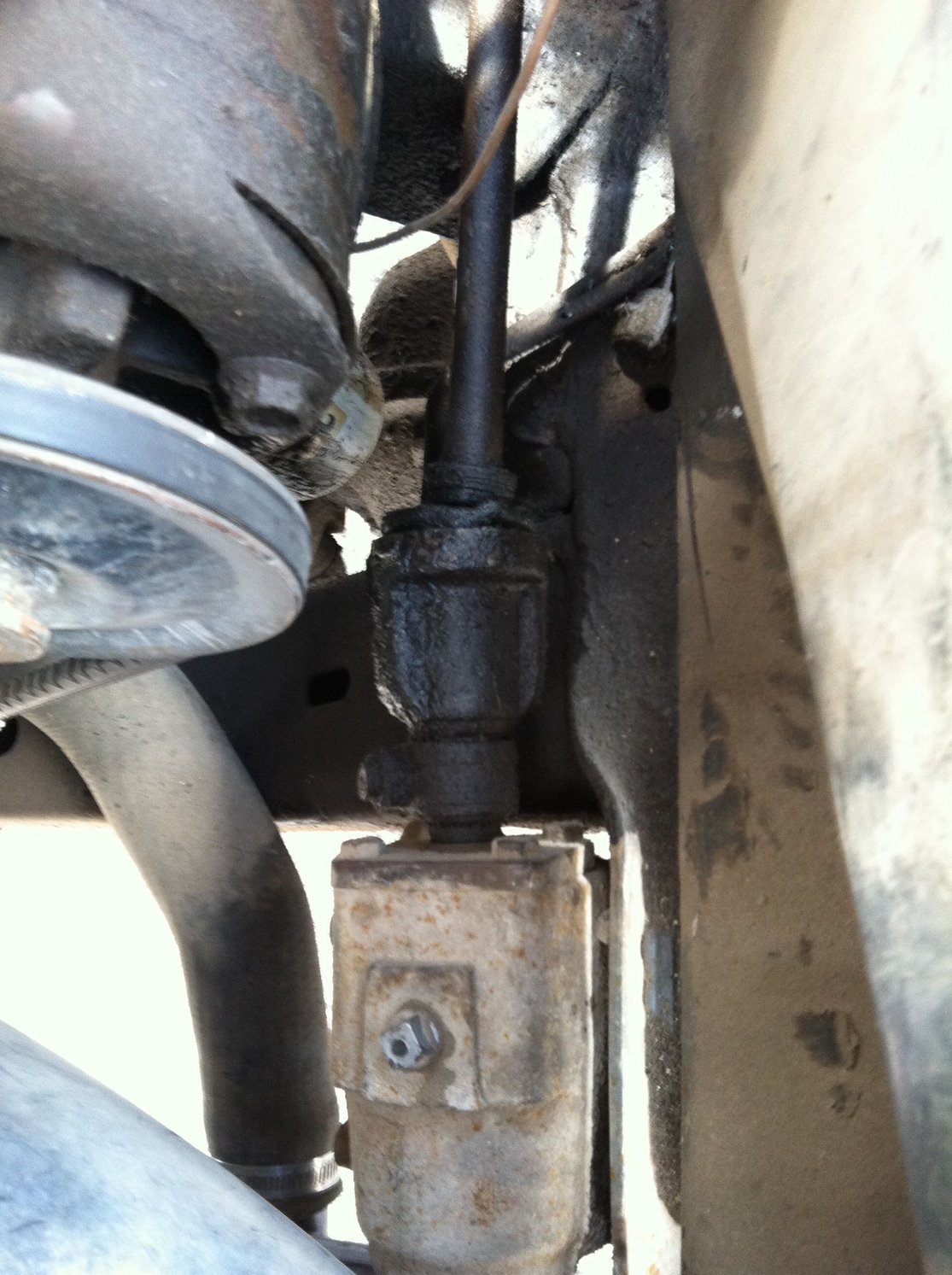

Also curious if this is normal. The steering rod coming from the firewall into the gearbox looks to be slightly angled.. Is this right. These are the best pics I could get..
