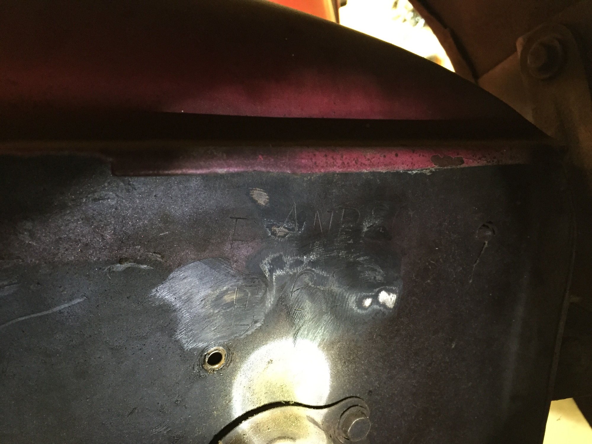

Just found this stamped on the driver side near the hood hinge PANR20 E63. Any idea what that is?
That is the firewall stamping.
Are you sure that is what is stamped there? And in that order?
P= color -prime
A= color - black ... does not make sense that they would stamp 2 paint codes
NR= Norfolk assembly plant...this makes sense as that is where the norfolk stamps are located.
20E = April 20
63 internal plant code.
OK, the P does not look like it is part of the stamping. BTW please don't use sand paper or a grinding wheel to find stampings. A course Scotchbrite pad with water is best.
