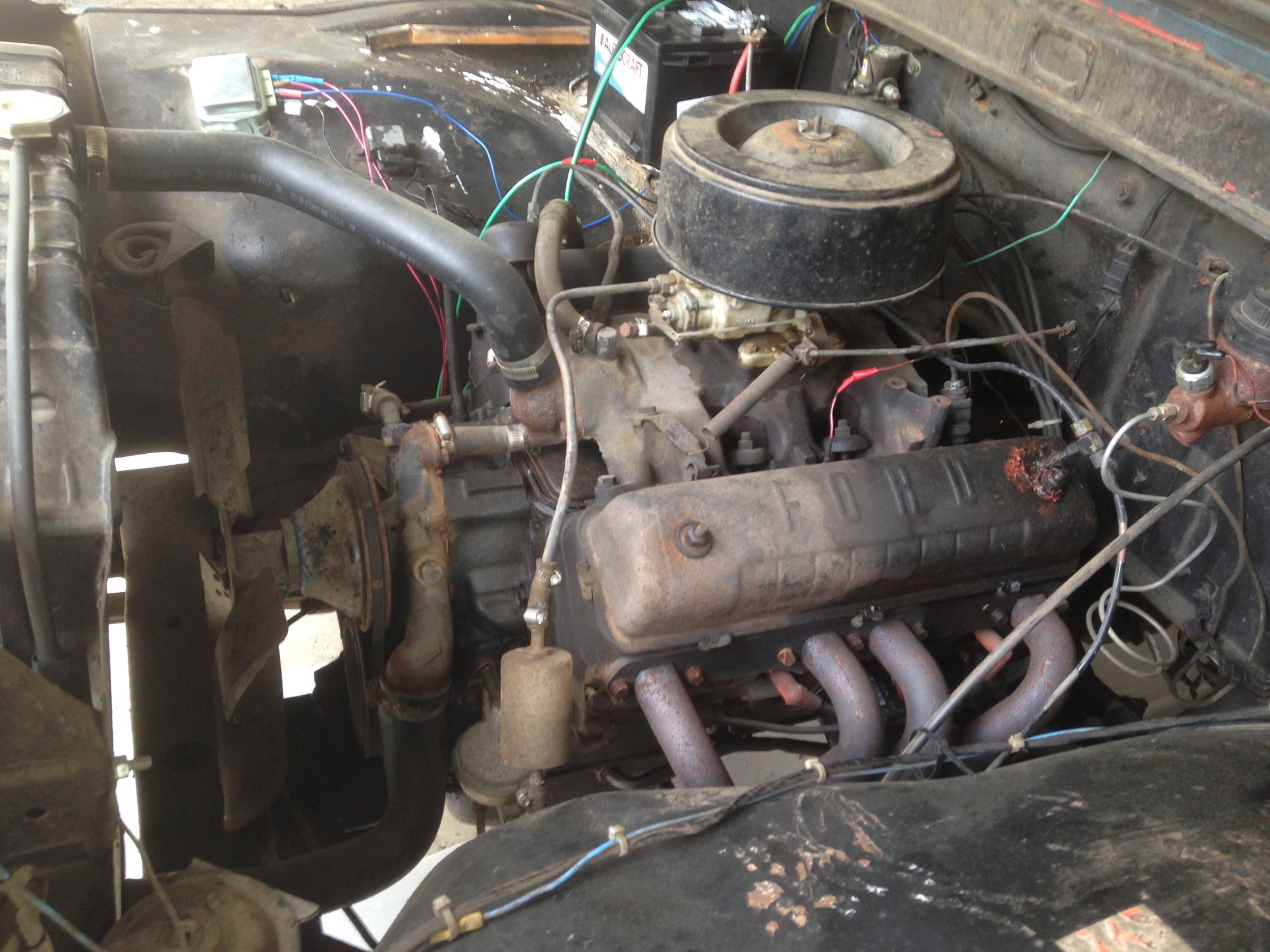

Any ideas about what this engine and transmission might be? They're in a 64 engine doesn't match door plate its a V8 3 speed and shift is through the floor. Are there places under the grime that I might find information about the engine and transmission? What tubing hacked into the valve covers for? Thanks for your help.
V8 Driver's side
V8 passenger side
Transmission from below

I'm not seeing any pictures in your post. I do see the link to your album. The engine in that truck looks to be a Y-block. Could be 272, 292 or 312 to name a few, but the 292 was one of the stock engines in the 1964 trucks. All I can see of a transmission is that it looks to be a floor shift. Is it auto, 3-speed, 4-speed, 5-speed?
Generally under the grime you can find identifying marks and casting numbers that can at least narrow down what you might have.
